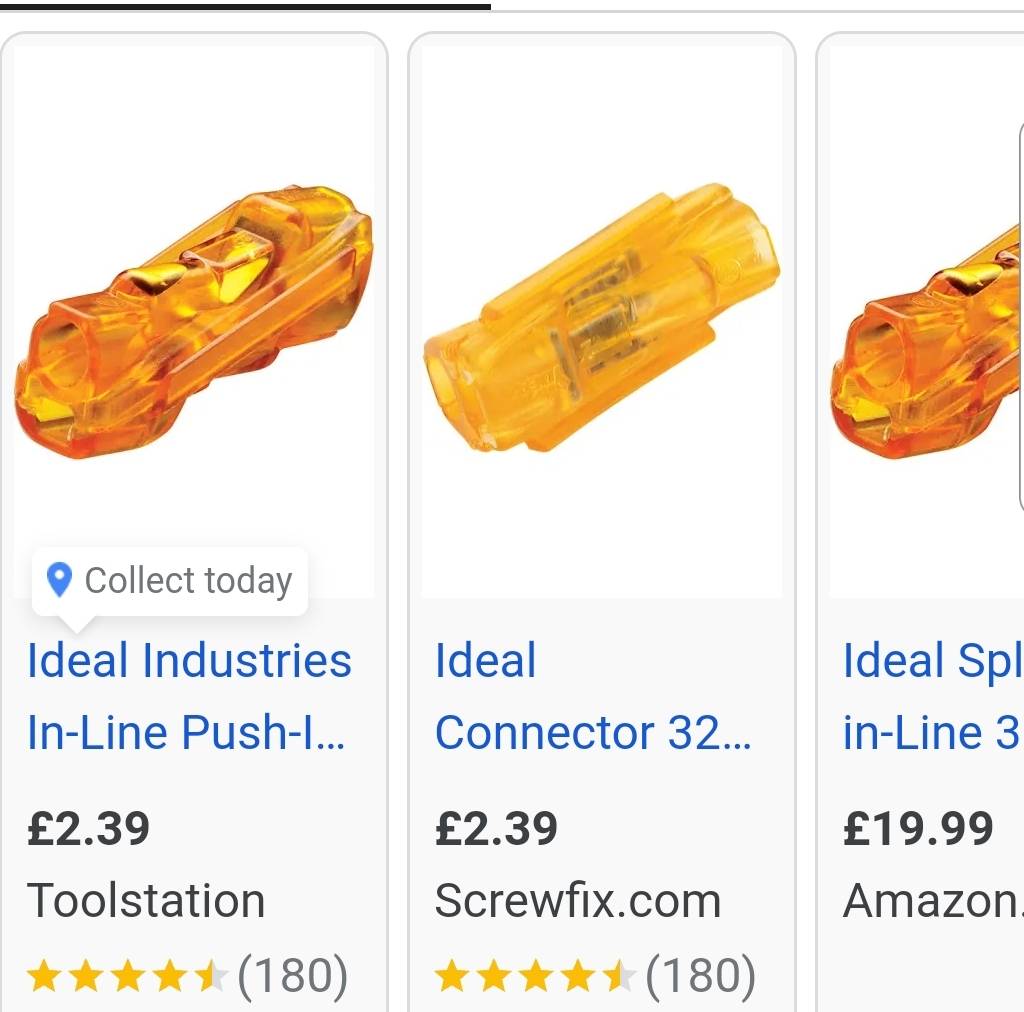

Drilled into wire
Yes cavity walls, stud walls, under floors and in ceilings, But they do recommend that access is still possible
Hi, ok, got these wagos and box lined up to collect tomorrow en route. All ok?
Maybe not that model of Wago. If you’ve cut a wire, you will not have any extra length to use.
Better to use the new Wago splicing connector
Where are you getting this info from? The whole point of Wago is they are used in inaccessible locations.
Please provide links to the documentation. Thank you.
Crimping or soldering and then heat shrink sleeve.
That will take the least space and can be plastered over.
If it's just 1 conductor put one of these on it, then maybe cover with capping fill and forget about it.
Await the backlash.....

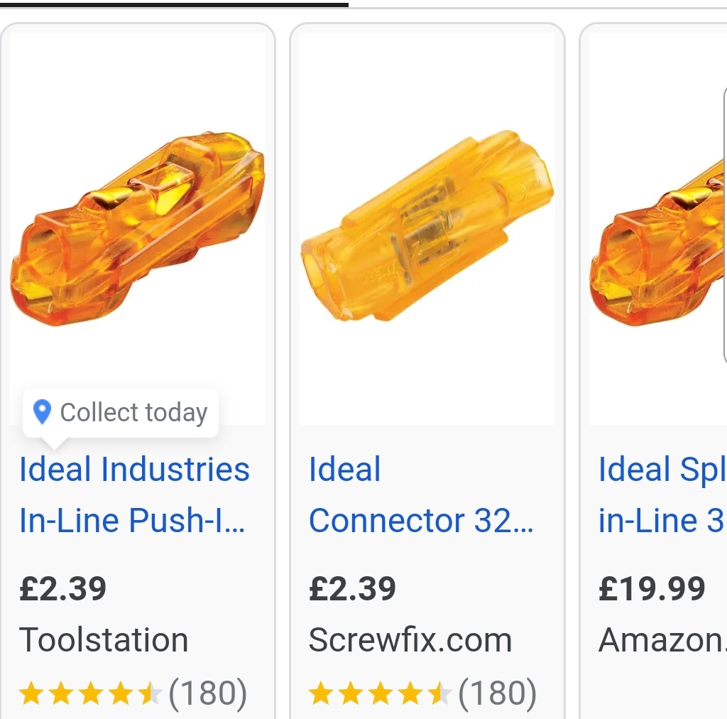

No backlash, only.....For Wago to comply with Maintenance Free rules it must be a WAGO enclosure and Wago connectors.
