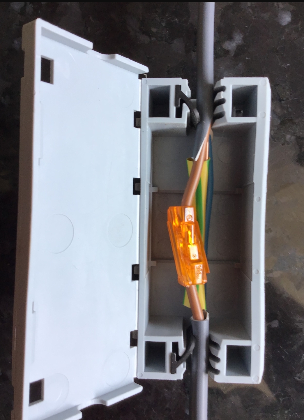

Fair enough - but, as you have been 'warned', they are very probably not categorised as 'maintenance free', and therefore may not be suitable/compliant for installation in non-accessible locations (e.g. 'plastered in').
Kind Regards, John
They look great, will get some, thanks. What do you mean by "cover with capping"?
I feel at bit guilty suggesting them now as they aren't maintenance free, but whats the other options?
Replace cable is obviously the best option but not always easy.
Fit box with blank plate, but who wants that.
Maybe sink in a slim wago box like this.

Were it me, dealing with this, I would solve it with a soldered repair.
Carefully split the outer grey, add a double length of adhesive type heat sleaving, to one end of the broken conductor. Strip both ends, then find an extra piece of the same sized conductor, long enough to overlap both of them. Bind the new bit of copper in place, along side both ends, along the entire length of bare copper, with 5amp fuse wire. Apply soldering iron and solder, then finally - heat shrink first length over the top, then a second long piece over the top of that.
Tuck other two cores, plus repaired core, back in place in the outer grey, then add a good wrap of PVC tape, overall.
For what it's worth, so would I, if I really couldn't find a way of replacing the cable, and didn't want a blank plate or suchlike staring me in the face.
I am quite uncomfortable with buried crimped joints, particularly of solid conductors - at least, if they were created with something like any tool I have.
Kind Regards, John
Totally wrong, I know, but many times I have found block connectors several decades old buried in plaster and still perfectly functional...
Same here - but I need not tell you that, even if both of us (and undoubtedly many others) have seen that done, and remain 'satisfactory' for very long times, it certainly is not something that one should do!
Kind Regards, John
