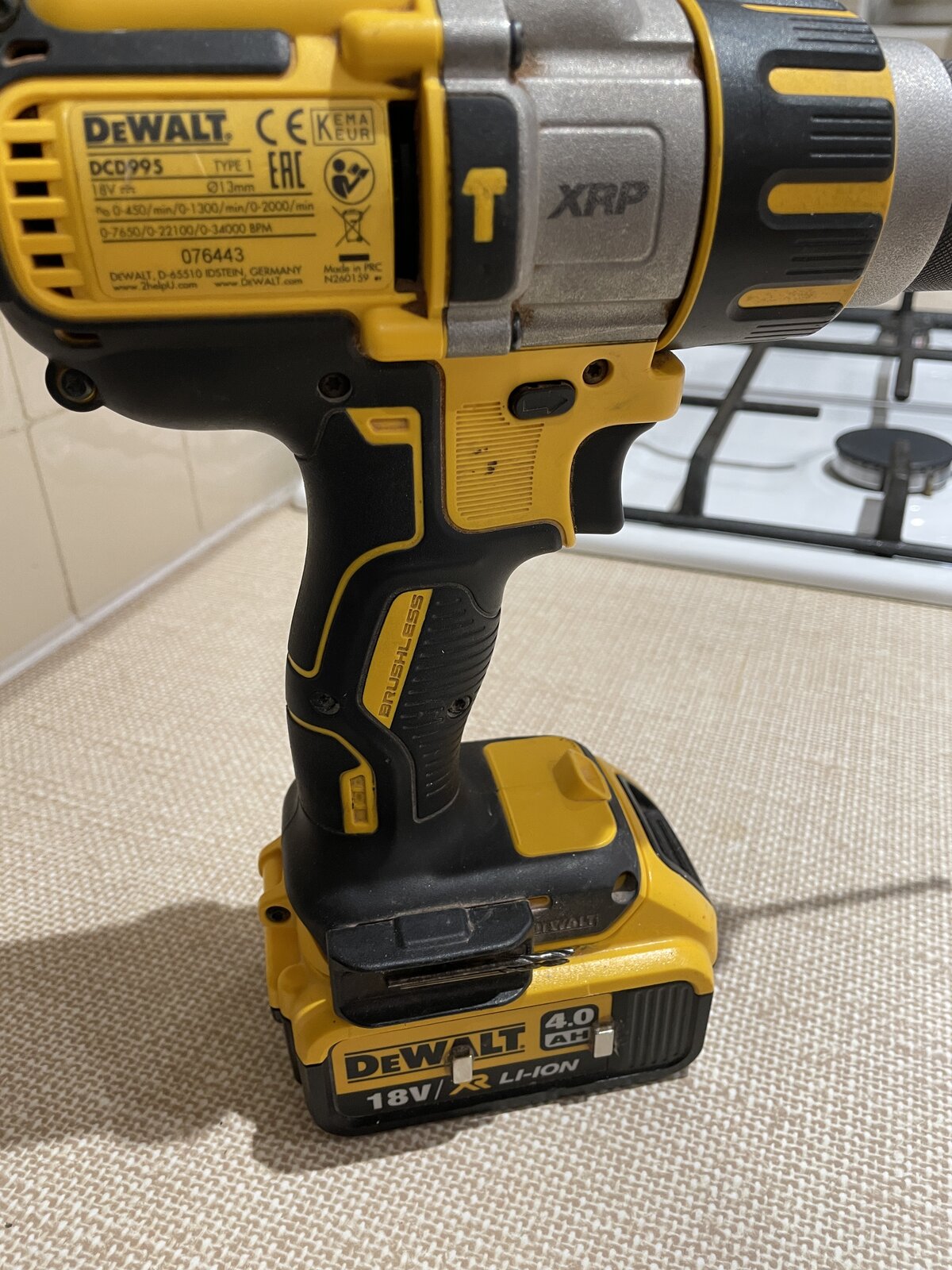

The drill is a DeWalt DCD995 with fully-charged 4Ah battery.

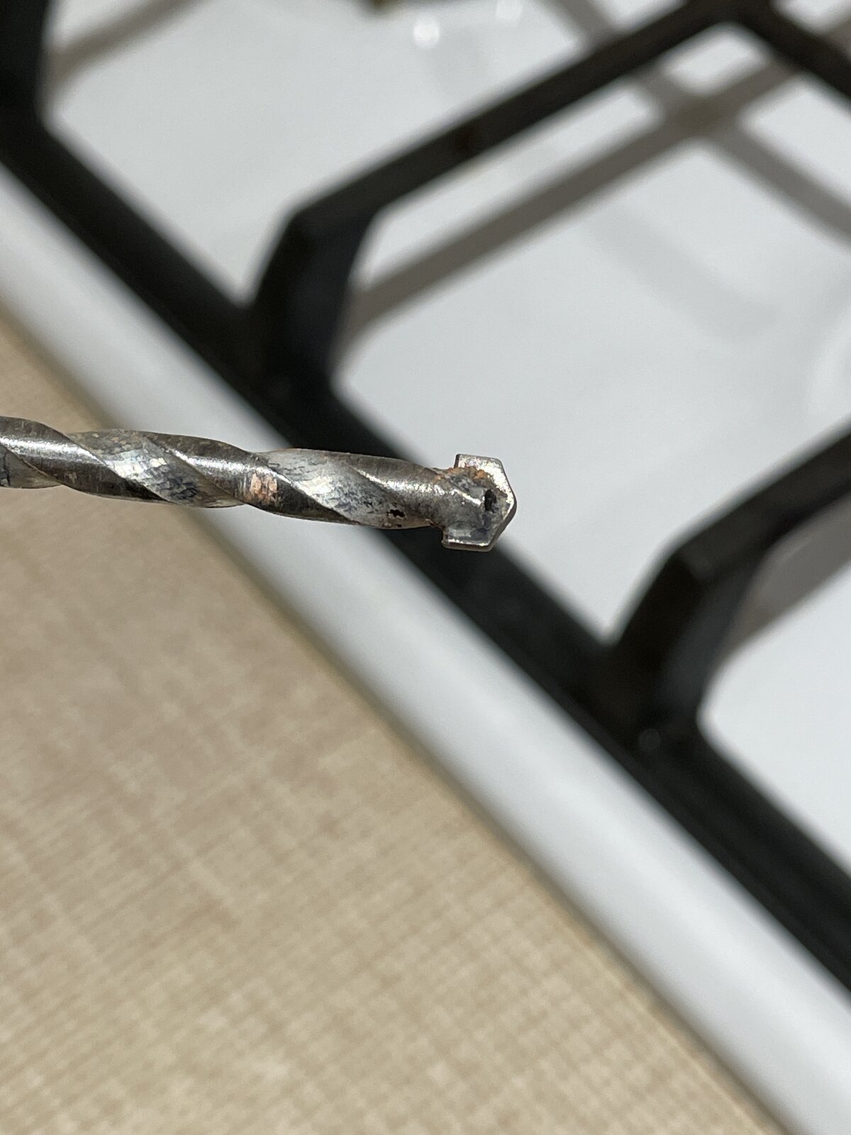

No idea what brand the masonry drill bit is - but looks okay (pix to follow). I am using a smaller (and sharper 4.5mm as a pilot).

That drill bit looks blunt and knackered to me. You will love the cyl-9 bosch ones.
It looked like that after the first hole!
I'm not surprised that it isn't making much progress to be honest!

Can we see the top of your drill to see what settings you’ve got it on please?
I lent my mate my cordless drill and new drill bits so he could hang a hanging basket - got a call saying how ****e my drill was and the he couldn’t make a hole in his brick wall with it…he just didn’t realise that there was a setting for the hammer action (which it wasn’t on).
