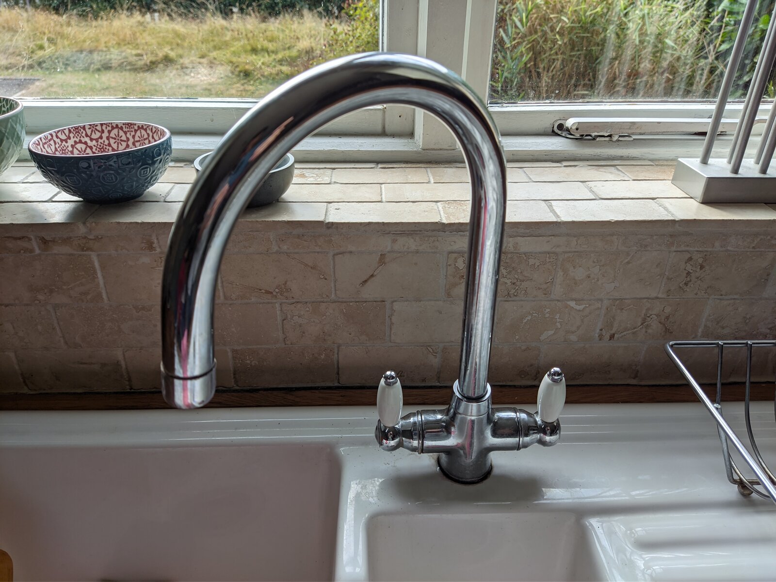

Hi there,
We've got a dripping tap - hot water (so left hand side). There's a space at the back of the tap for what looks to be an allen key but none of the keys are turning it in a way which I can get the tap off.
Unfortunately I think we might be looking at a replacement tap. I want to avoid soldering copper if possible.

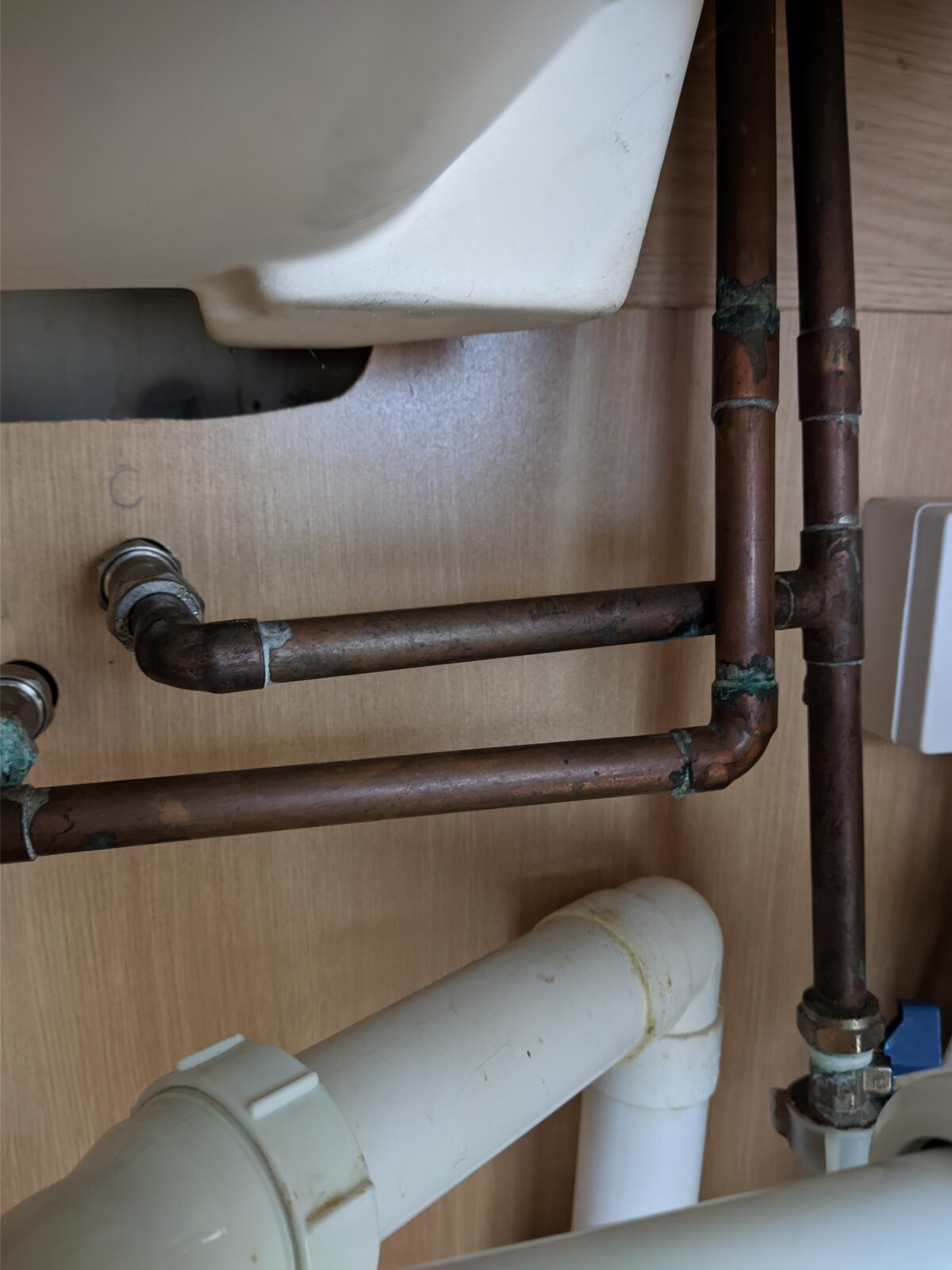

Currently - as you can see from the photos - we've got cooper tap for hot then copper tap for cold which also connects down to the isolation for the dishwasher.
Any thoughts on how best to replace the tap if I need to go down that route? Presumably it means cutting the pipes - is there a connector I can use to connect the copper pipe to the Flexi hose for the tap?

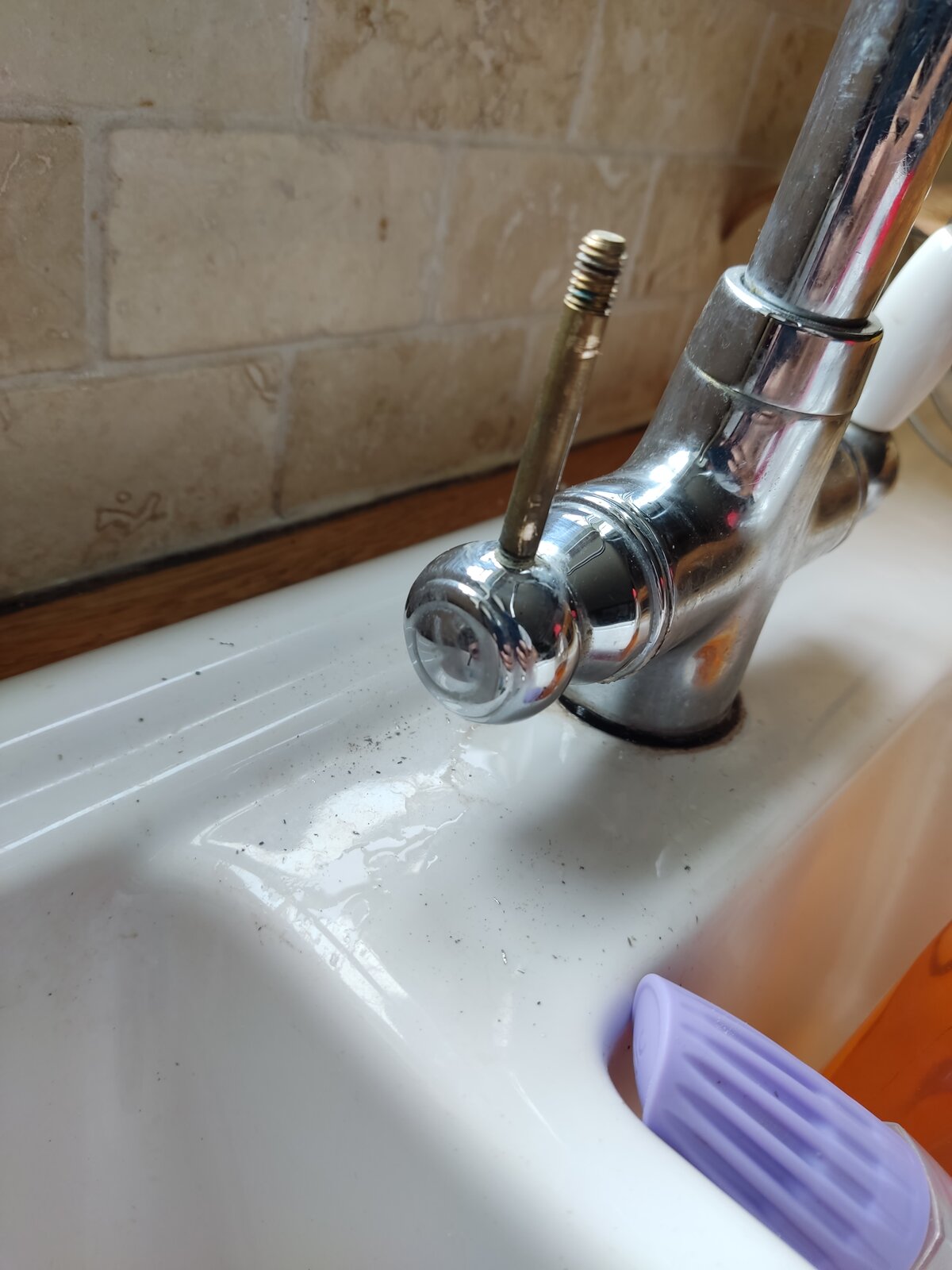

Thanks. Have got the handle off but there are no caps at the end of the tap. There's space for an allen key underneath but it's not getting the tap off. Any thoughts?

Looks like a Bristan easyfit, you're supposed to undo the two grub screws at the back of the tap to remove the tap body from its mounting plate.
Trouble is, installers never grease the grubscrews when they fit the taps, which makes removal difficult.
As said above, if you just need a cartridge, they can be replaced without removing whole tap.
Or undo the handles and there will be a grub screw revealed in the socket they screw into.
Thanks - see photo above. I've got part of the handle off but the remainder won't come off unfortunately.
Either that brass spindle unscrews and has a grub screw below or the cap on the left hand side comes of to reveal a screw.
Thanks. Yes, I can't seem get the grub screw off underneath. None of the Allen keys seem to bite to be able to remove it.
Any other thoughts?
Thanks - unfortunately there's not a cap which unscrews. I'll have another go at removing the brass spindle.
The one in my picture was a prise off - you can see the marks I made! The one I had before that had screw off caps. The ends of the taps ( not the levers) HAS to come off.
