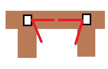

If the drive way had not already been laid then a horizontal beam extended under the drive would reduce the tendancy of the post to topple under the weight of the gate.
The problems of installing heavy gates in soft soil were discussed in this thread HERE
Remember there are two directions of topple, one when the gates are closed and the other at 90 degrees when the gates are open.
The beam across the driveway will oppose the toppling forces created when the gates are closed but may just roll when the gates are open. Extensions to prevent roll may be necessary
n-gate-beam-jpg.136868

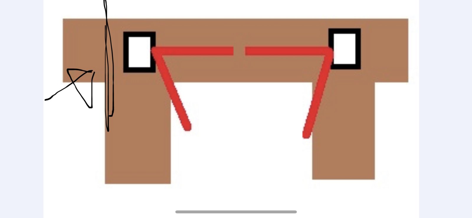

The problem here is the drive is down! There is a clear movement of the post in the concrete on the side I have marked also the hedge was just off this area (approx where the line is)and wasn’t up to where the post is!
There is only movement to the right, no forward or back or to the left ( the post will re center)

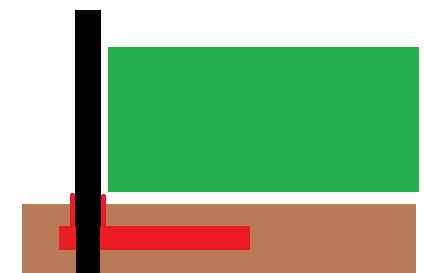

Could you extend a beam out under ( or parallel ) to the fence ?
It would need to be heavy as this beam would be trying to go upwards when the gate was closed.
