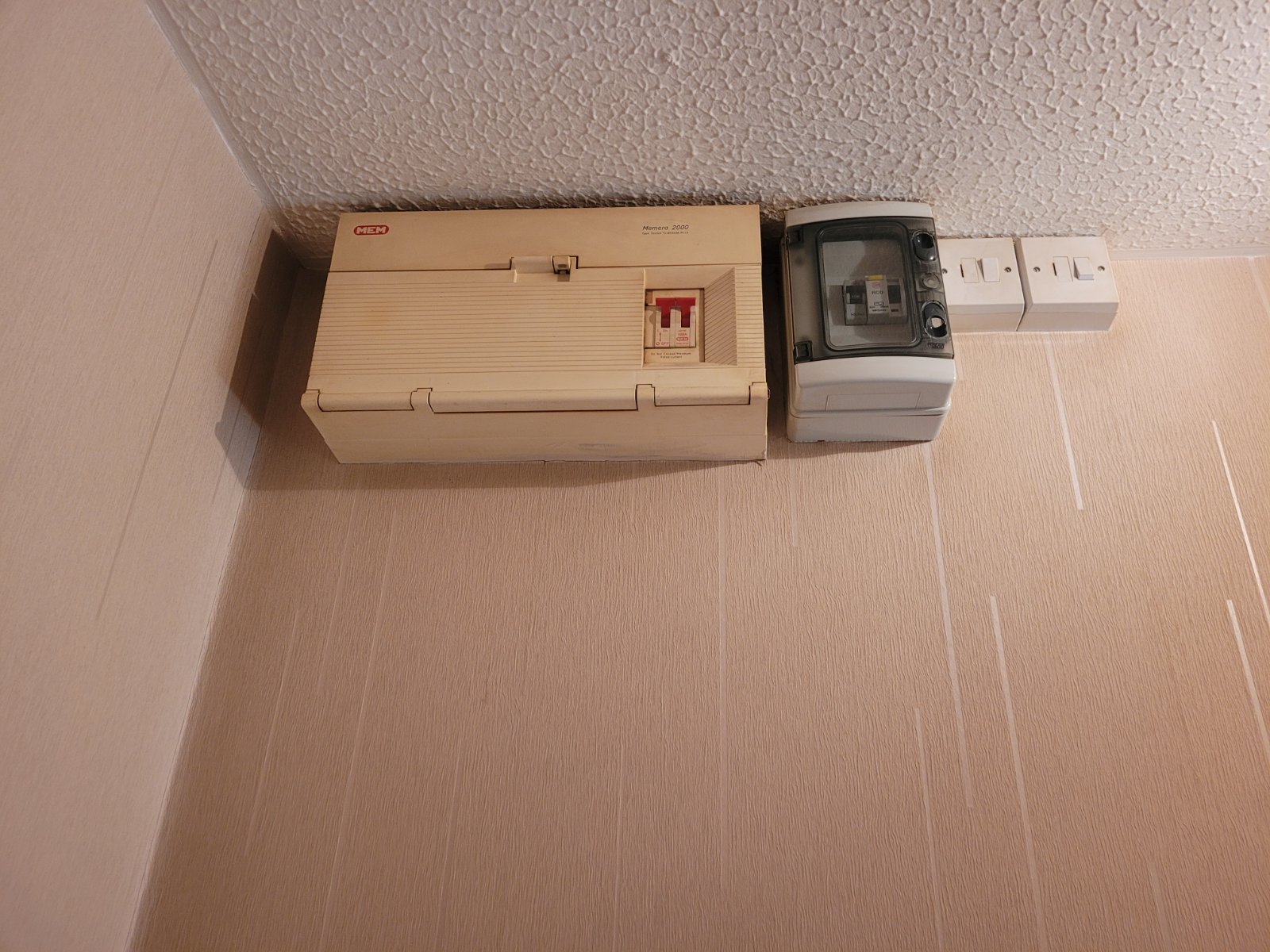

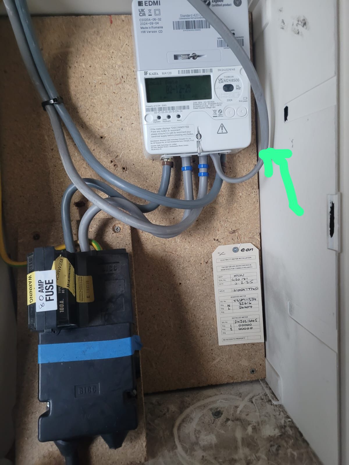

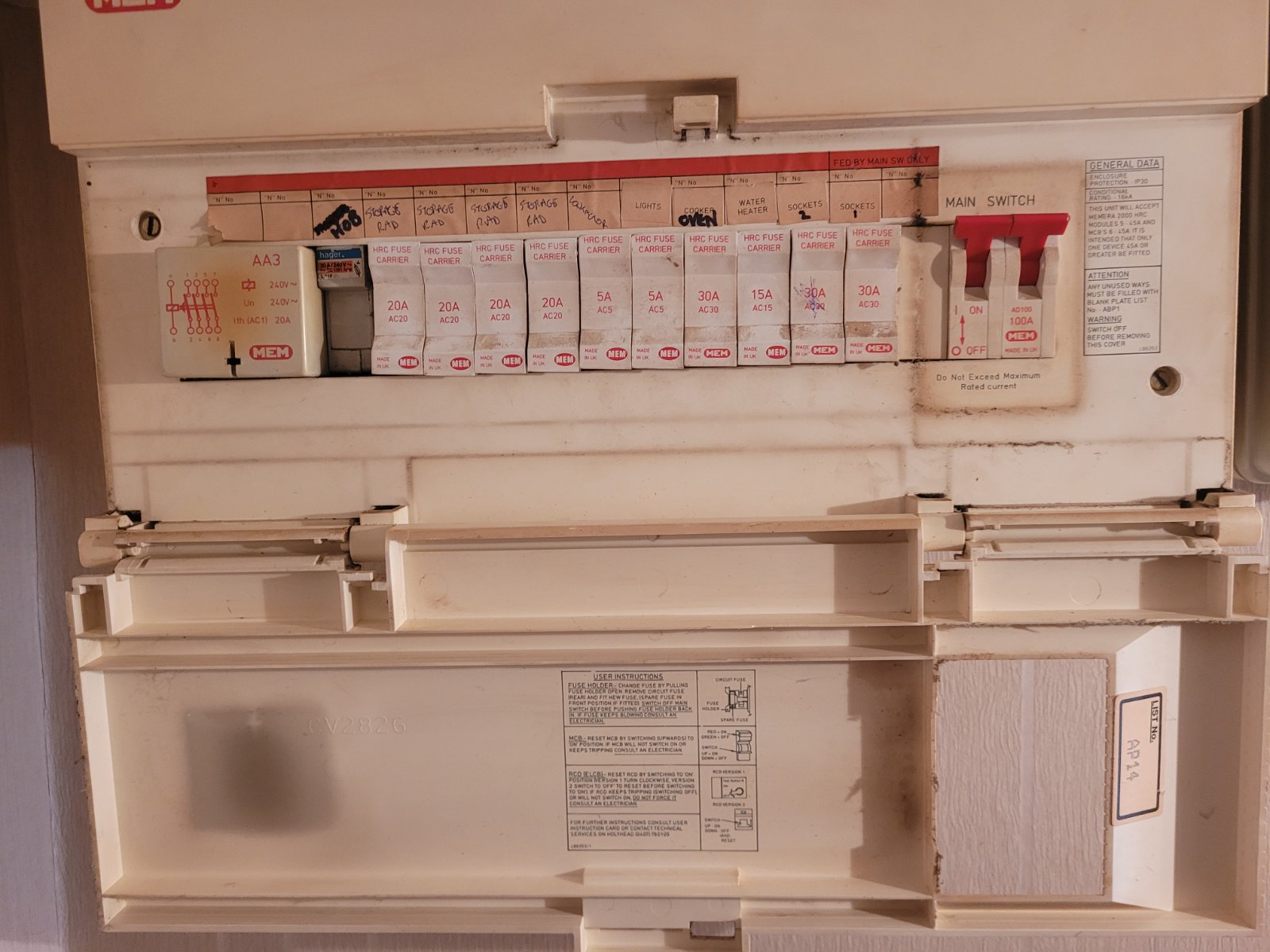

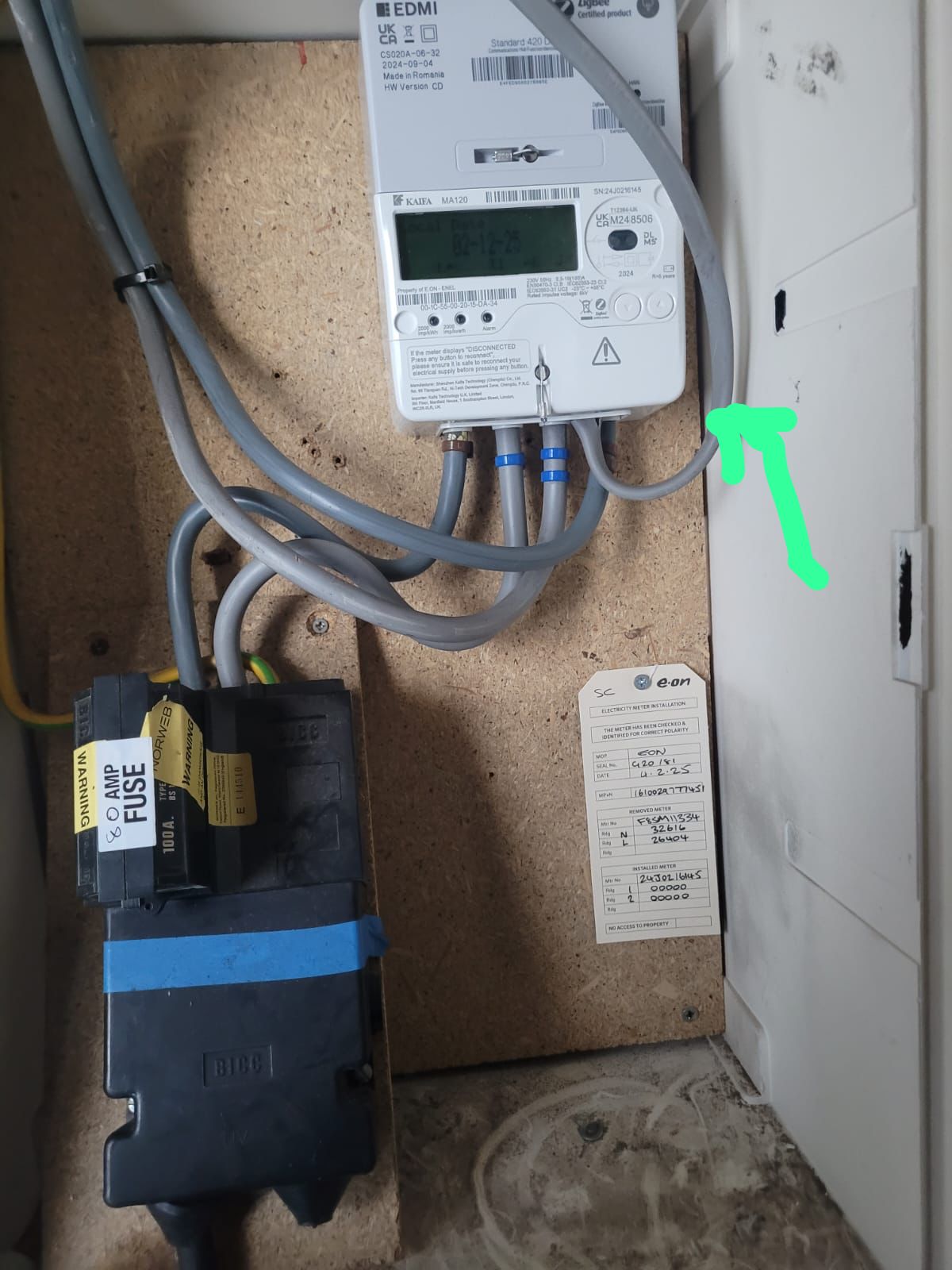

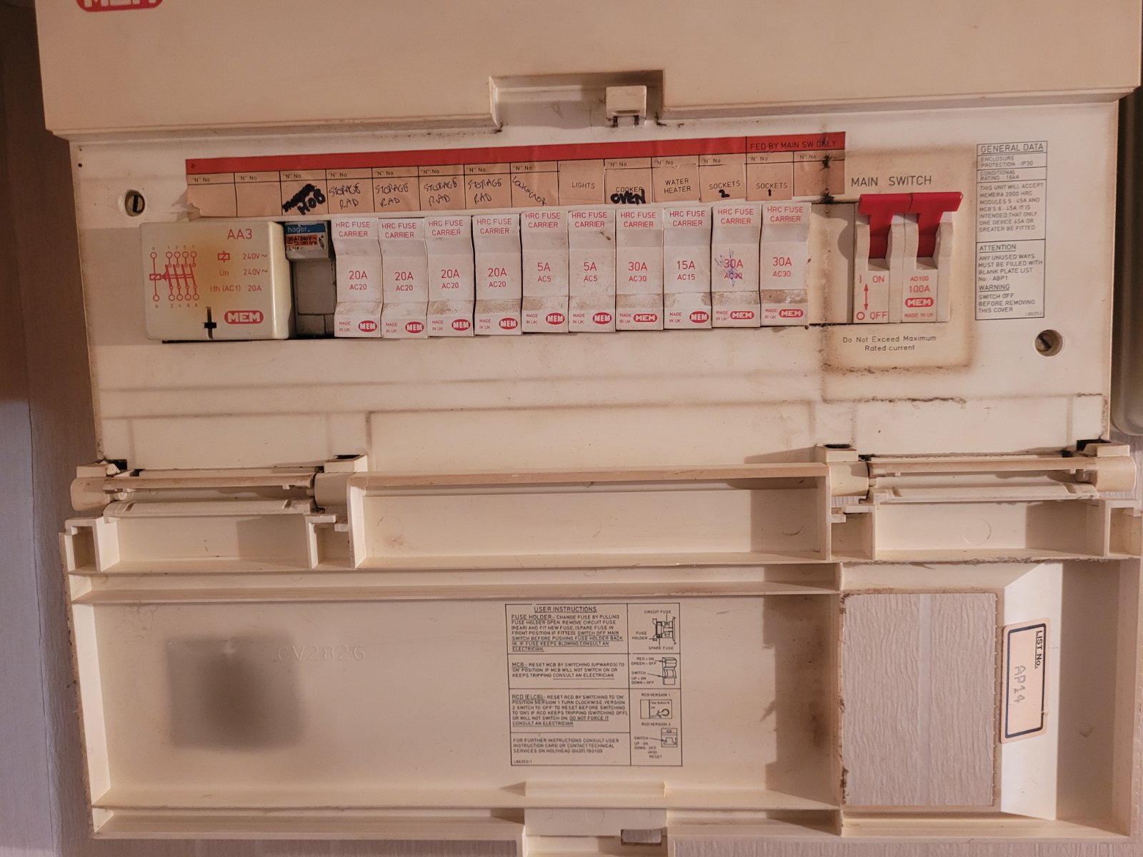

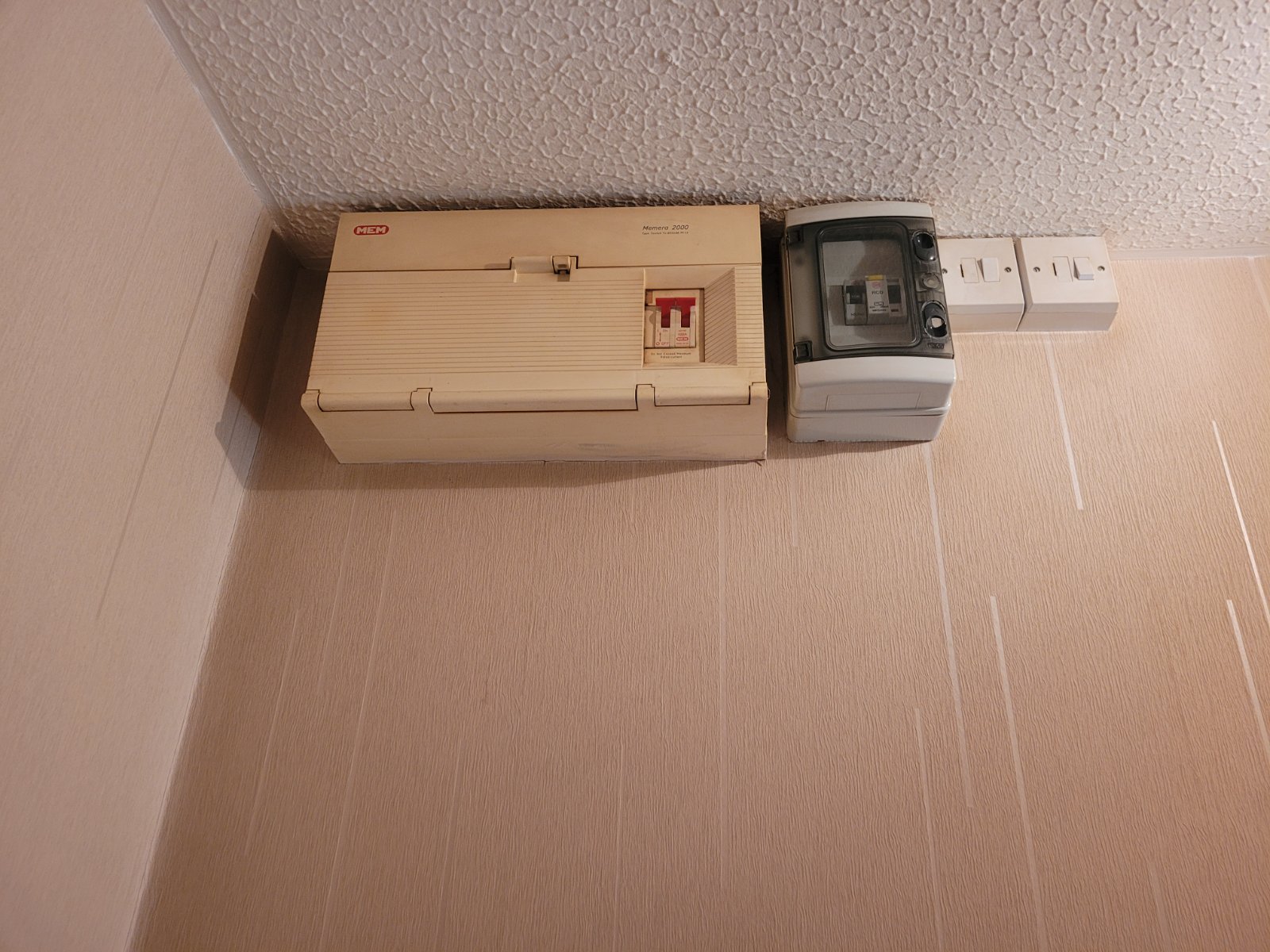

Is it better to dispense with eco 7 contactor switched by signal cable and go for dual tariff unit I.e. disconnect the signal cable.
Presumably the board will go on eco 7 at the prescribed times for all circuits,
Photos attached

4 ec0 7 rads electrician can advise but over phone he favoured contactor switched with existing signal cable, he's having gander next week

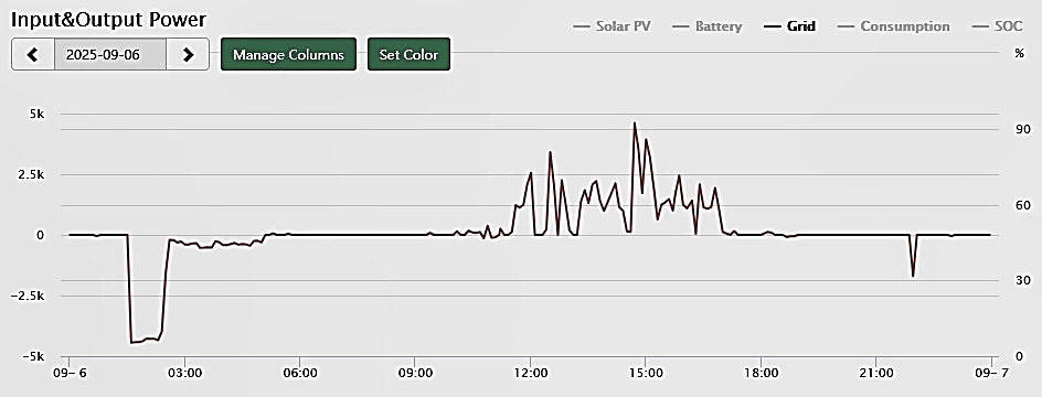

I only have 5 hours, not 7 hours, off-peak, and around 8.5p and 31p per kWh, today I ran out of off-peak at 3:30 pm as very little solar, and batteries not that large, but 00:30 to 15:30 off-peak so just 8.5 hours using peak power, as the battery means using off-peak for 5 + 10 = 15 hours, so 9 hours peak power, would be hard even on bad days to use more peak power to off-peak.

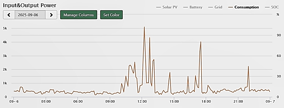

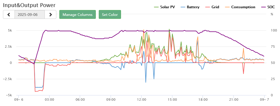

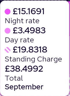

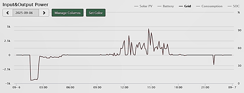

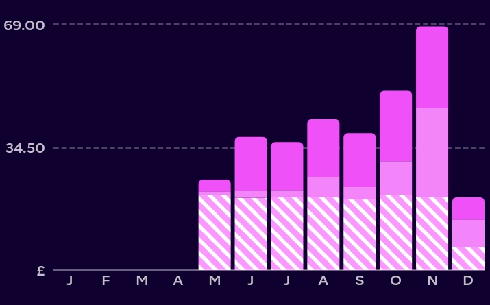

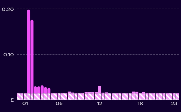

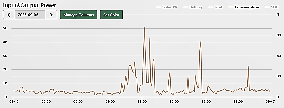

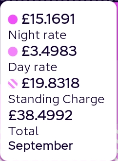

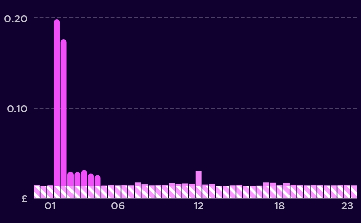

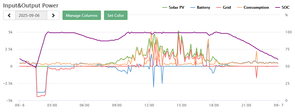

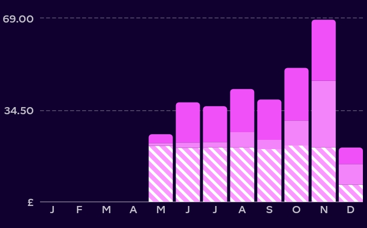

Also in summer when heating not required, one is still paying a premium for peak electric supply. If I look back to the summer I see my use is mainly during the day Temp1_tonemapped.jpgso you need to use around 90% in winter, so the average is 70% all year round. Unless one fits an inverter and battery. If I look at my grid use for the same day Temp1_tonemapped.jpg the below line is from grid, above line it to the grid, so hardly any power drawn from the grid during the day, the main draw is recharging battery with off-peak. So for me, even in summer, most of my electric is used as off-peak. Because I have solar panels, summer electric bill is a minus figure, so for me no question off-peak is well worthwhile, but without the solar panels and batteries, it would not be so cut and dried. Out of interest, this is what I look at for the whole day 1765364898688.png the interesting bit for me is state of charge of the battery, which is why the smart meter display for me is useless, but if I did not have solar and battery, I can see how the display would be handy, same day from smart meter 1765365419297.png showing main bill was the standing charge. The year display is better, 1765365622068.png I moved supplier so only from May, this is the bit you need 1765365822373.png which tells you your total use, showing I use far more off-peak to peak all year round.
