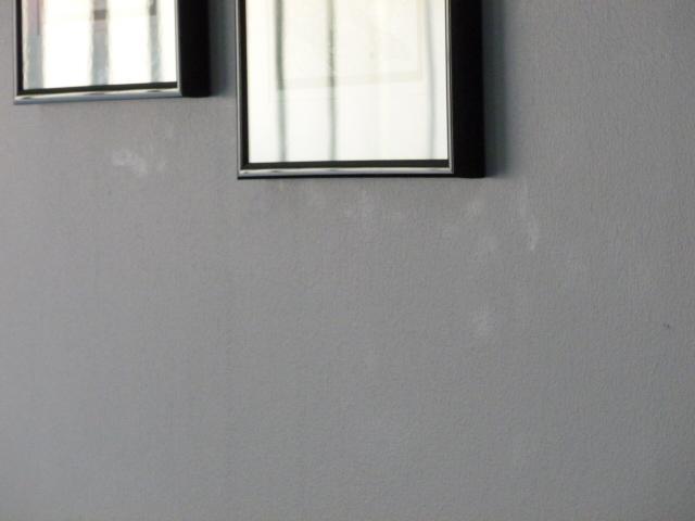

We all know there have been problems with Dulux white gloss turning yellow, so I no longer use it.
But - I've always used their emulsion, usually the mixer ones and in Vinyl Soft Sheen, which claims to be durable and WASHABLE. Never had a problem before gently wiping off the odd finger mark..........until NOW!

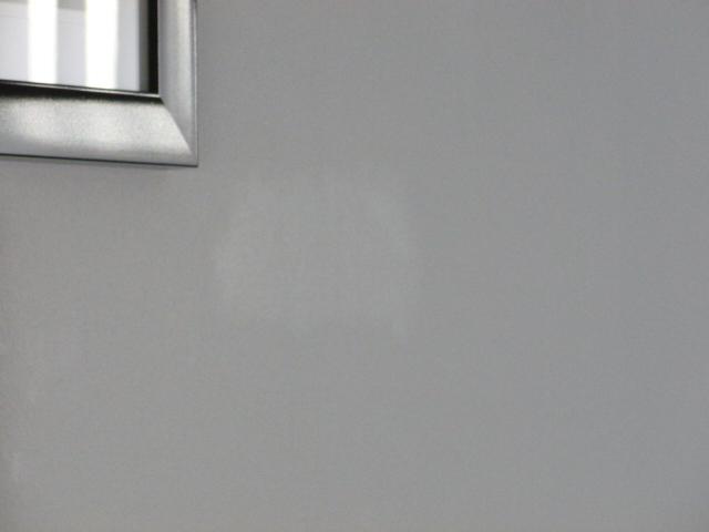

I've just used 5ltrs painting lounge/diner, used a damp, white cloth to gently wipe off some finger marks from putting pictures and wall light up (wasn't even actual dirt).
Now I have a sort of sort of shiny surface on the places I wiped, you can see it gleaming from certain directions. I'M FUMING.
Never had a problem with this before, have written to Dulux for an explanation but a bit of a moot point really, they should not be claiming 'washable', clearly it isn't.
Thanks for suggestion Chri5, but definitely not, it had been painted about a week earlier. We waited for new furniture and light fittings to arrive before putting everything up in their new positions.
I think it was more like skin moisture marks (dare I say 'sweat') where we had held the pictures up with that weird technique we probably all use. Forefingers on either side of the picture, thumbs supporting the bottom with the rest of your fingers against the wall stopping the frame from scraping it while you manoeuvre it all around before settling on the first spot you put it in. :LOL:
We use dulux emulsion and still find it ok, but wtf is going on with their statinwood?
Coverage is bad, paint goes oily in the paint kettle..terrible.
I'm no fan of Dulux but the paint needs time to fully cure before any rubbing or wiping. Not sure what Dulux recommend but i think little green say 28 days for their intellimatt.

Thanks drdec, didn't think it would be as long as 28 days! Have written to Dulux to ask what is wrong so perhaps they'll say that too. If not I've had plenty to say about their 'washable' claim.
I know part of the problem are EU 'Directives' - less preservative affected the whiteness properties of the gloss (and satinwood I believe, if that's the wood paint where you can wash the brushes afterwards).
I've gone right off Dulux lately.
Dulux emailed and said it's 'wipeable' and needs time to 'cure'.
According to Consumer Direct they are tripping over Trade Descriptions Act twice. 1) Because they specifically say 'washable' which is NOT the same as 'wipeable'. 2) There are NO additional instructions on the tin referring to 'curing' (or the timescale for it).
Advised (by C D) to return the tin to B&Q for a full refund under the Sale of Goods Act 1979 as it is not fit for purpose because it isn't actually washable. In the meantime Dulux asked for a painted sample (on a piece of white card) & offered "a paint voucher" for remedial work.

Apparently there is a breach of Trade Descriptions Act, can't say 'washable' if it is only 'wipeable', and if it needs to 'cure' it must say so on the tin #it doesn't even mentioned 'curing - let alone give a timescale#.
After I gave them a verbal wallop Dulux have started to backpeddle on the 'wipeable' phrase they used in an email, switching to 'gentle washing', but I still plan to contact Trading Standards regarding the use of 'washable' and no curing instructions.
Even got a couple of decent photo's of what's happened to the wall when merely touching it to put pictures up and what happened in one place when I tried to wipe it off!
The ONLY thing I want from this is that they change their labelling & in the meantime warn others.
