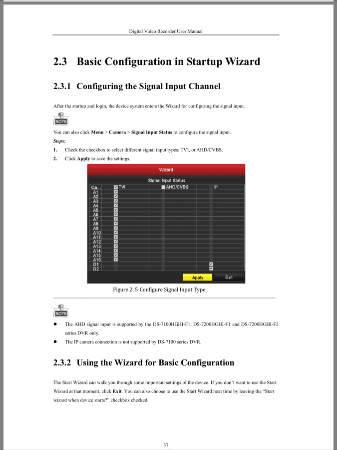

Today channels 5, 6, 7 & 8 of the DVR do not seem to be functional. Channels 5, 6 & 7 show no video at all, and channel 8 has a grainy video with multiple lines through it.
Channels 1, 2, 3 & 4 work fine.

Are channel channels 5-8 turned on in set up?
Thanks for the prompt... yes all the channels are enabled.
As four of the channels worked and four did not, I was assuming it was a hardware issue. But your post above prompted me to reboot the system (for some reason this had not occurred to me before to do so). Having re-booted the system all channels are now working.
