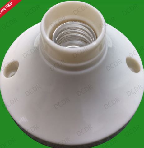

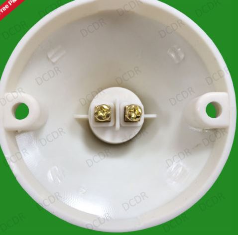

Not sure it's relevant on the bulb holders I've got. I bought them off eBay ages ago and have attached pictures showing connecting terminals. Can't remember if they're marked N and L so will have to take a closer look at one.

Thanks - I'll take a look at what part of the holder the terminals lead to and determine which connections I should be making.

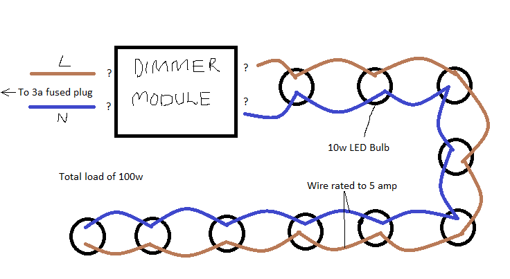

I've sketched up (used MS Paint) to show the circuit now with 10w bulbs instead. Not sure how a dimmer is wired up but I'm presuming the live goes into the dimmer 'L1' and exits the dimmer 'L2' to the bulbs, with neutral bypassing the dimmer and going straight to the bulbs?
You are right about the neutral bit, but not the L1 and L2 part. Did you read the instructions?
