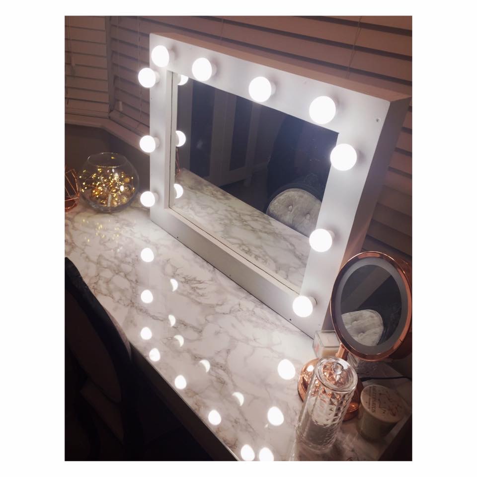

As an update, I completed the project.
Needs tidying up (filling the countersunk screw holes and a lick of paint), but it's pretty much done.
I put it up Christmas day morning at 0630 with the hope of it being a nice surprise for her to wake up to. Queue me switching it on and the equivalent of 300w of light filling the room which prompted her wondering what the hell was going on... definitely a good idea to get the dimmer put on as she can control light levels, but maybe next time with smaller-wattage bulbs :D
