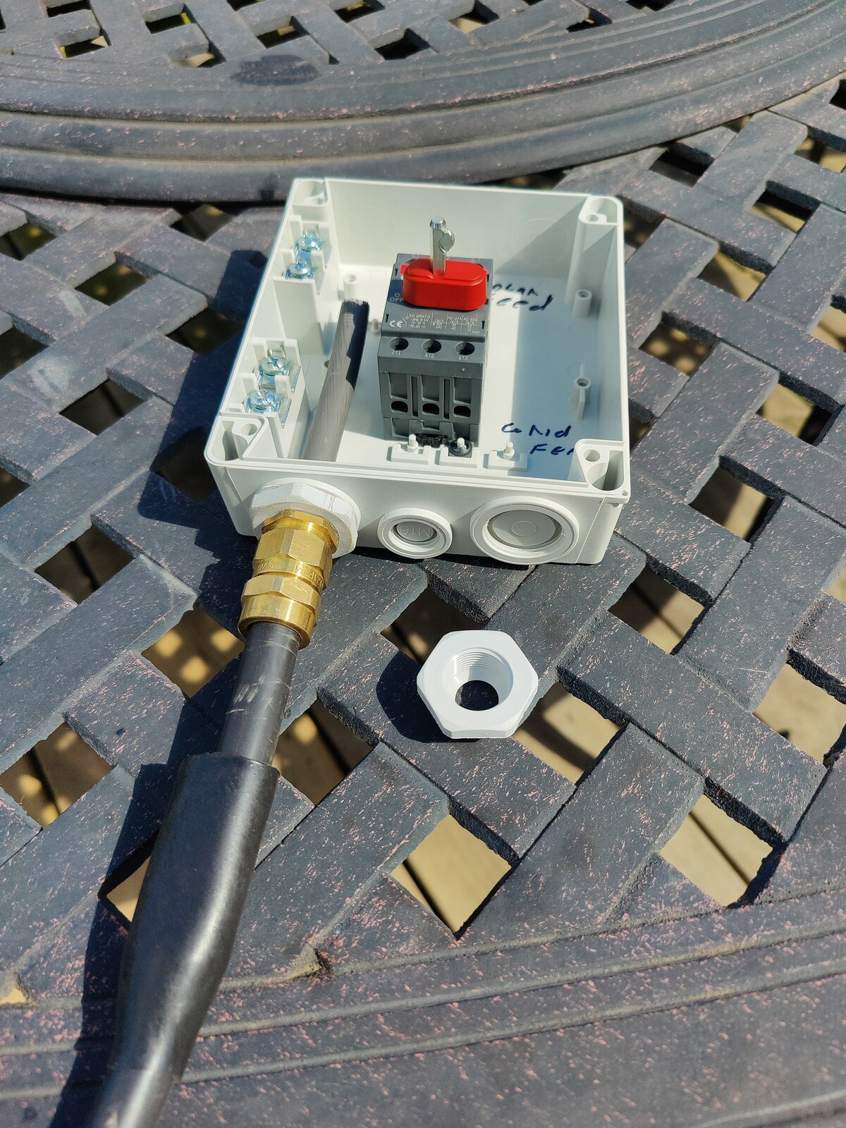

Folks,
What options do I have to continue earth through the isolator? Because my compression glad is 20mm and I had to use the threaded 25-20 reducer I cannot access the gland internally.
I will have a second swa exiting to the right of this one. Is it OK to keep earth external between the two?
I'm doing the donkey work and a sparky coming to review and sign off. Don't want to waste his time with me getting it wrong.
You could put banjo tags on with the flylead run externally, however if installed exposed to the whether, ir tends to corrode, certainly if the installer uses a galv roofing bolt...
Other options are to fit an earth nut internally after swapping the reducer for a metal one.
Could terminate both SWAs into a trouser box and bush that into the isolator, you'd probbly be best using 25mm one with two galv reducers on the SWA glands

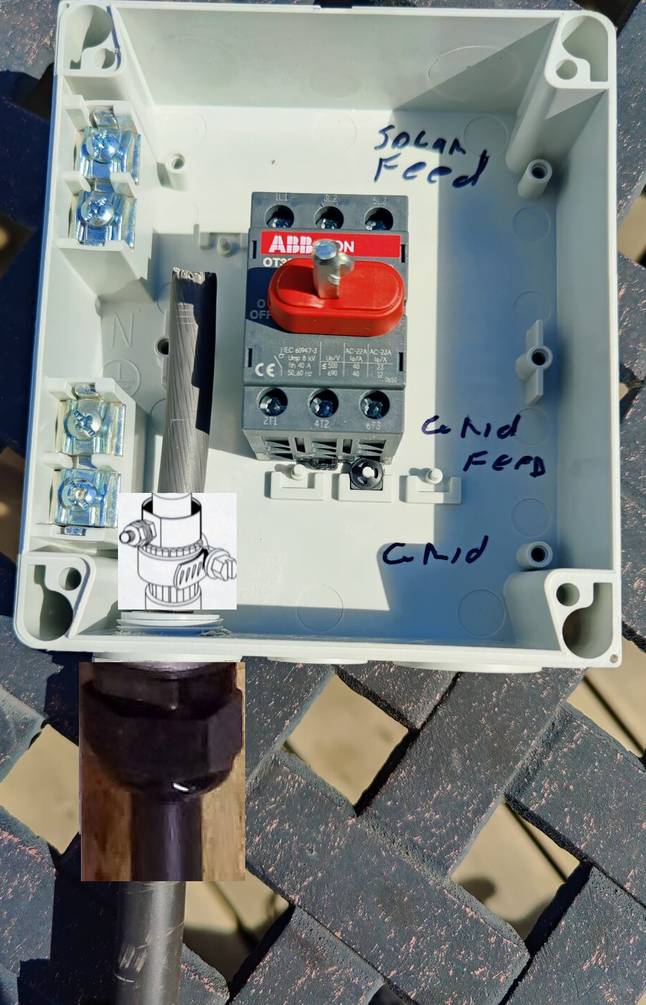

Not sure an Earthing nut would fit even with the thread protruding, looks like the fixing lugs in the way.
This again highlights the brass gland is not always the best method of terminating SWA

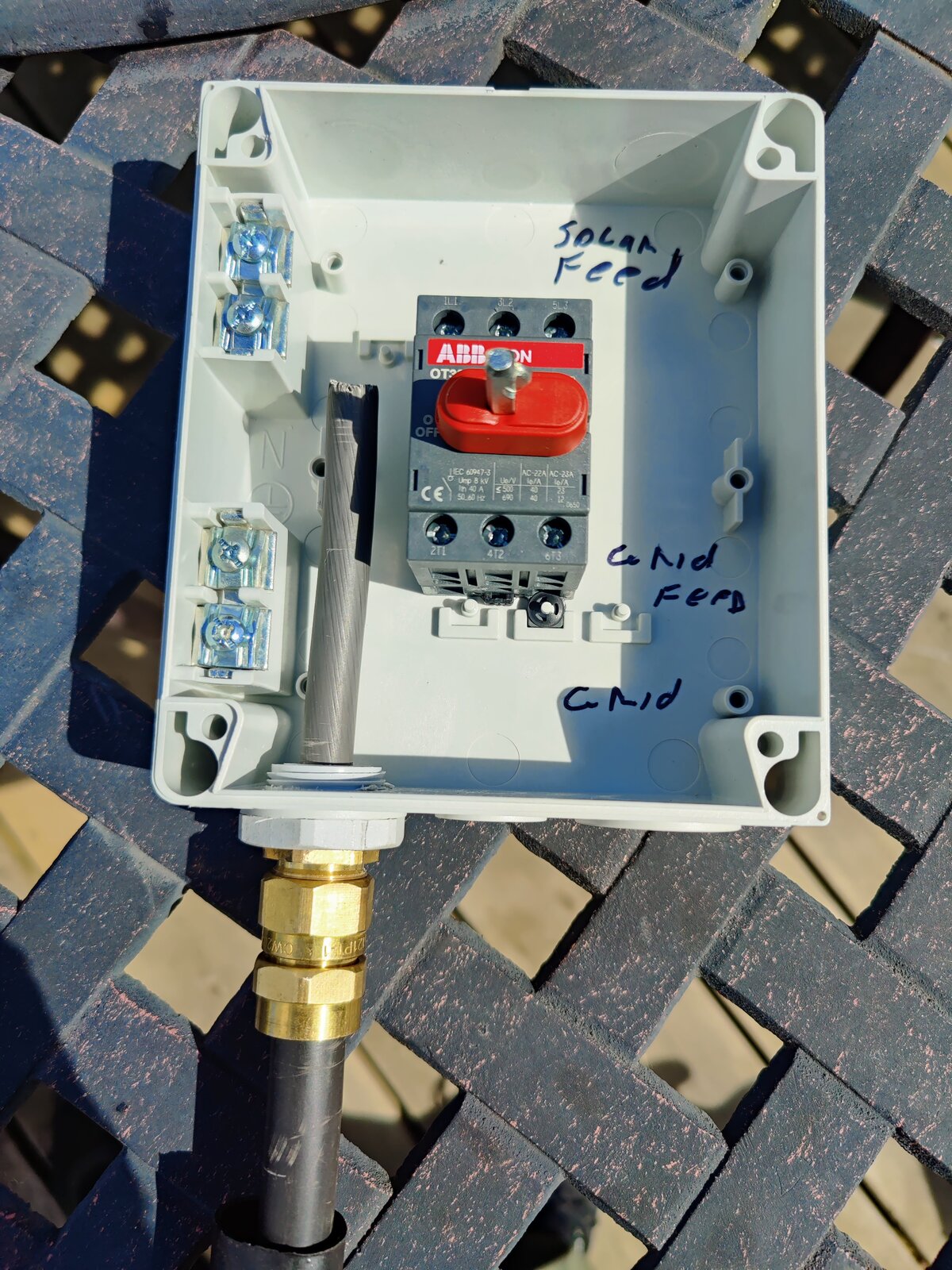

I think that the OP knows that. His issue is that he should have used, or created, a 20mm hole for the gland. The box appears to only have knock outs for 25 and 16mm. I dont know where the box came from, never seen one that didn't have 20mm gland entry options.
Unfortunately he has used the 25mm knockout and fitted a 25mm-20mm reducer. That stands the gland too far off the box for a banjo, or for a piranha nut.
@crappy my helpful suggestion
(@winston1 please note)
is that you remove the gland and reducer. Buy a pair of the smallest 25mm SWA glands and screw that direct in. No reducer required. You'll need to fit the banjo for the earth. You'll need the second 25mm gland of the pair for the second SWA!.
Think that should do it?
