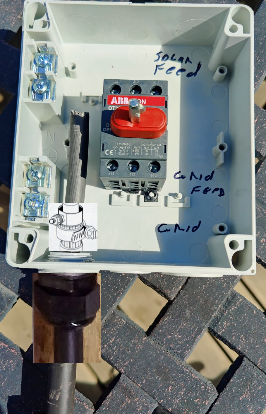

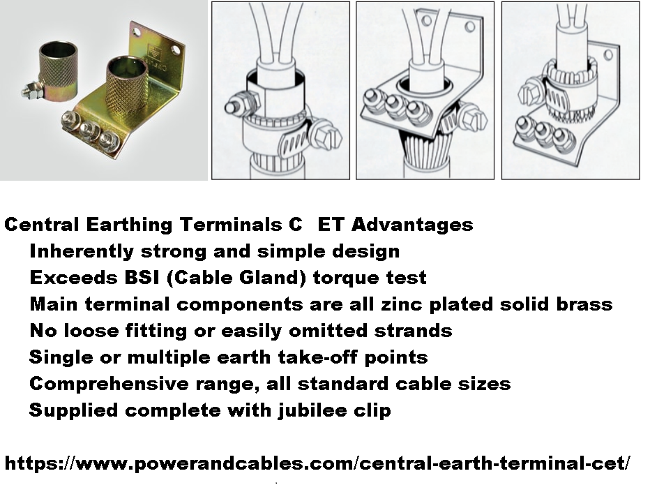

He describes fitting a banjo by trapping it between the plastic enclosure and a locknut, no sorry I don't agree on the basis I've known too many become loose where the plastic spreads under the pressure,
Totally agree, plastic does de-form under pressure and the result is a loose banjo and un-reliable Earth connection,

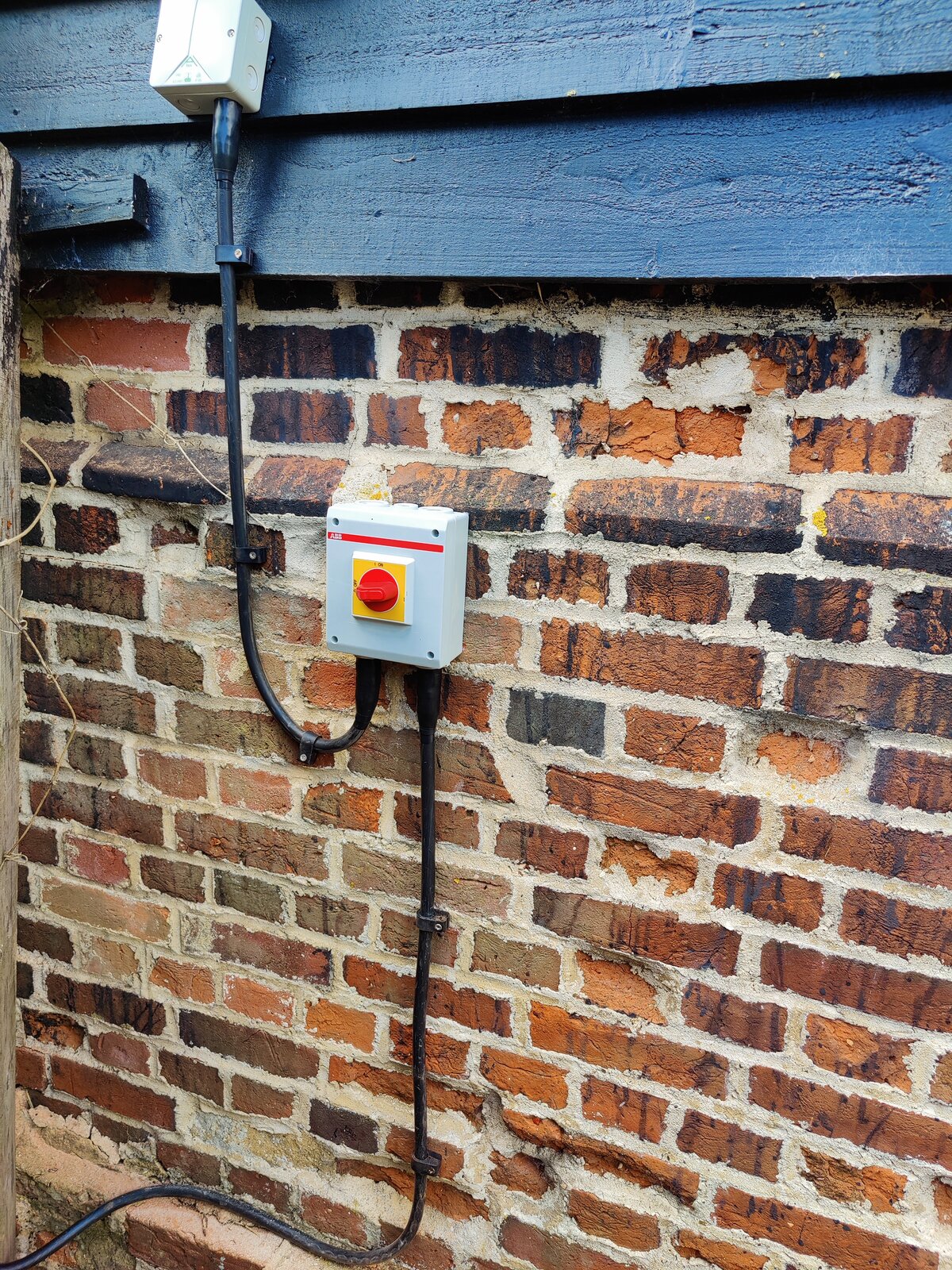

At this point I am both assistant and customer but he was away.
We've agreed on the install and I'm building to that. He was here today to see update on weekend progress. The idea that he did not laug at me is positive. :)

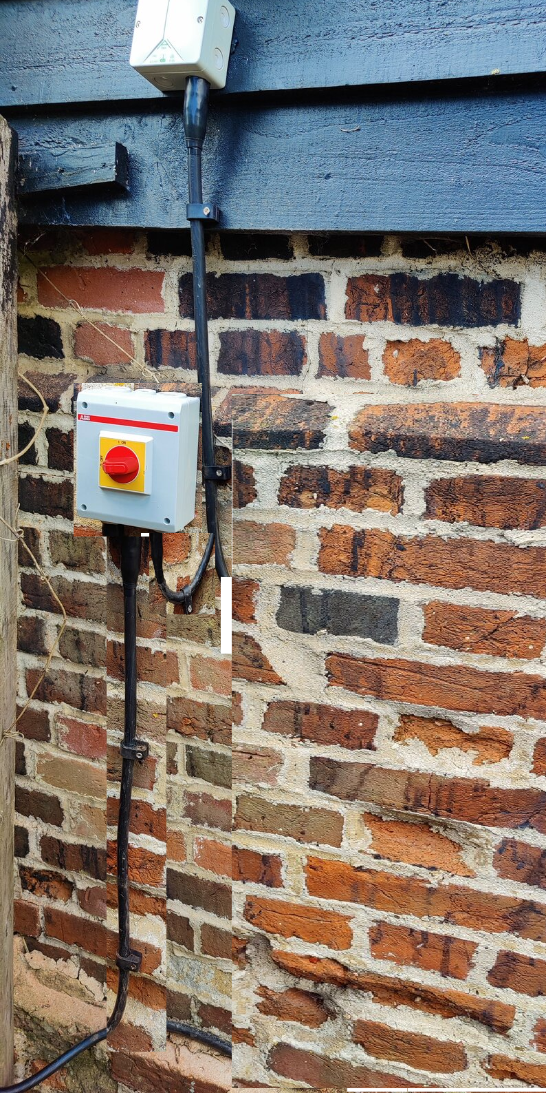

That's quite fair, I see no need to laugh at that. It's fair to say I've certainly seen some much shoddier pro jobs.
The only thing I might have suggested is moving to the left:
But I don't have any local knowledge or how that wooden post (fence/gate) affects it.
What was your final solution for eathing?
What's not clear in the pic is the fence is running in at an angle. Your suggestion puts it in a tighter spot where, in an emergency, someone with a missing left arm would not be able to easily isolate it . I jest but it is in a small space. That wall is not visible from anywhere in the garden so space is not important.
Re earthing - waiting on brass reducers and will retro fit. After taking the photo I left a large red ribbon to remind me.
