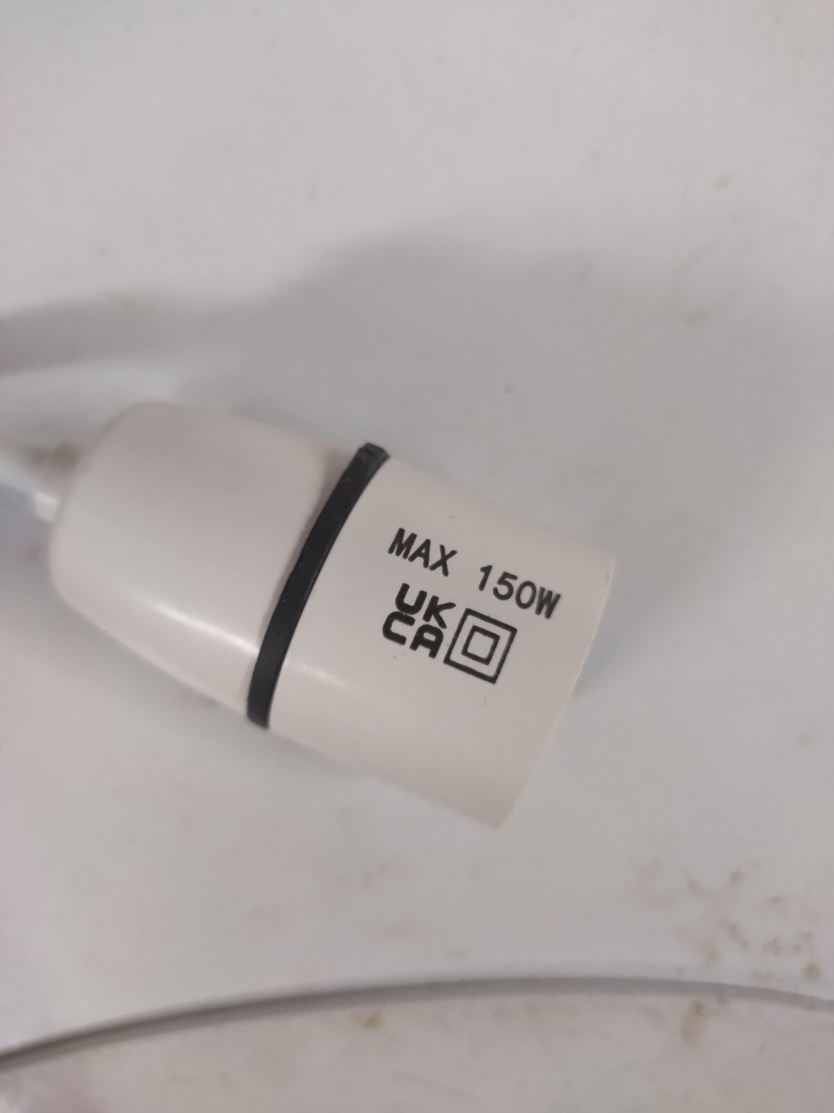

I searched the garage for a modern MK pendant set I knew I had somewhere.
Apart from the fact I didn't know a T2 lampholder could run to 150W (who uses 150W lamps anymore?), it has a Class II symbol on it, so if you have a circuit with those on, you'll need to follow that reg.

Back to the earthing topic. .... I searched the garage for a modern MK pendant set I knew I had somewhere. Apart from the fact I didn't know a T2 lampholder could run to 150W (who uses 150W lamps anymore?), it has a Class II symbol on it ...
Interesting. As I'm sure we've previously discussed, I've never seen such a symbol on a lampholder!
.... so if you have a circuit with those on, you'll need to follow that reg.
Maybe not! The regs are somewhat contradictory, but it would appear that 411.3.1.1 may well over-ride 412.2.3.2 ....
411.3.1.1 Protective earthing
A circuit protective conductor shall be run to and terminated at each point in wiring and at each accessory except a
lampholder having no exposed-conductive-parts and suspended from such a point.
May be that's because most if not all houses pre 1960's or so never had earth in their lighting circuits.
May be that was because ceiling roses with pendants were made of plastic didn't need regulation and were standard widely used.
Or even may be because specific requirements and regulations for class ii equipment were developed in the BS EN 50075 in 1991.
I'm not quite sure why the regs didn't just say "Have a cpc at each point of every circuit" to account for all eventualities (excepting 412.1.2 and 411.3.1.1) and have done with it.
No, that was not my point. There have been 60 years since then, and during that period, I have personally never seen a Class II symbol on such a lampholder - even though, as secure has illustrated, they do exist. I'm not sure when the symbol was first introduced, but it's certainly been around for much, if not all, of those 60 years.
I agree. In particular, as I've said, for someone just looking at 412.2.3.2 it might well appear to be the case that a CPC has to be run to every point/accessory in a circuit ONLY IF that circuit supplies one or more Class II items - which is clearly not the case.
