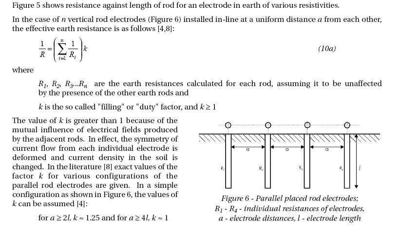

I did save an extract froma very involved document (see below). When i get a bit of time, I'll try and find a link to the whole enchilada
Simple stuff, eh? bang in a few rods, what could go wrong?
EDIT: Can't find the full tech document at the moment. There is an intersting explaination and result graphs in this article

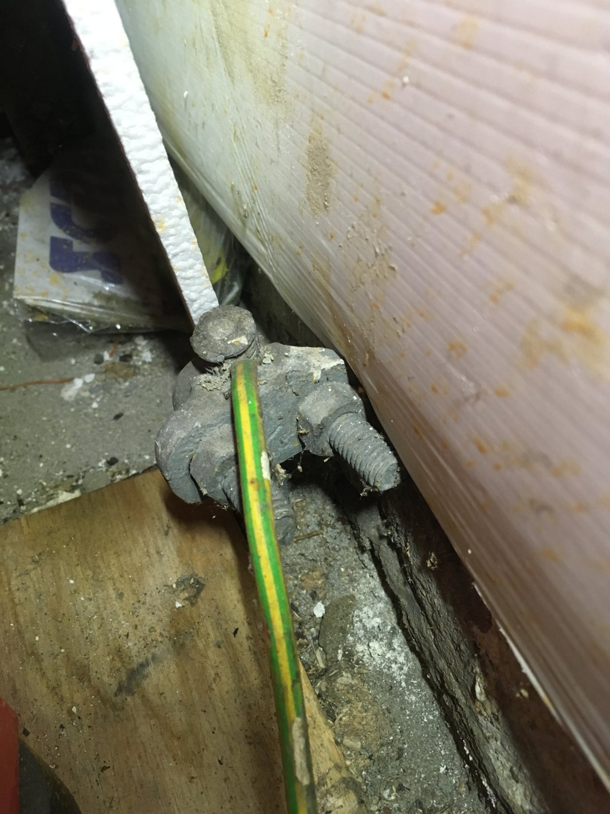

To be serious for a minute, the DNO do have a duty of maintenance on an earth terminal provided by them.
Sometimes, it is difficult or impossible to say whether the installation has been fitted with an earth terminal. I have seen conduit like yours several times, some were TT and others TNS and one, IIRC was TNC-S.
What is the other end of that conduit like?
Edited for clarity.
Many thanks.
Simple stuff, eh? bang in a few rods, what could go wrong? ... There is an intersting explaination and result graphs in this article
Thanks. I understood that (because of the interaction of fields) the use of multiple rods would result in less than 'pro rata' reduction in impedance, but what surprised me was your statement ....
Two rods can interfere with each other (I’m putting this simply) and you can end up with a worse, rather than a better impedance as a result.
If the resistance of each of the rods (used alone) were the same, say r, then that equation in what you posted would reduce to:
R = r/kn
... hence one could only end up with overall impedance (R) being greater than the impedance of one rod used alone (r) if (k*n) were less than than 1. However, given that n must be at least 2 and (the article says) k cannot be less than 1, that situation cannot arise.
However, there is something which currently makes no sense to me about the sample values of 'k' given in what you posted. They say that k=1.25 for a≥2l and that k becomes approximately 1 when a≥4l - i.e. that k decreases as the spacing of the rods increases, reaching 1 (the lowest permitted value) when the spacing reaches about 4 times the rod length. That would mean that the combined resistance of multiple rods would increase as the spacing increased - which seems to make no sense. In contrast, the graph is the article you linked to shows, as one would expect, combined resistance decreasing as rod spacing increases.
Can you make any sense of those quoted 'k' values? Am I missing something, or getting my sums wrong?
In any event, maths aside, it surely makes no sense in terms of intuition, common sense or physics that connecting a second rod to a first one can possibly result in the impedance to earth increasing, can it?
I would think that the bottom line is this. Whilst using multiple rods will not result in the degree of reduction of impedance that one might have 'expected', particularly if they are close together, there will always be some reduction resulting from adding extra rods - and, particularly for a DIYer, I would think that it would be preferable to hammer in two or more 4ft rods than to try to hammer in one 8ft one.
