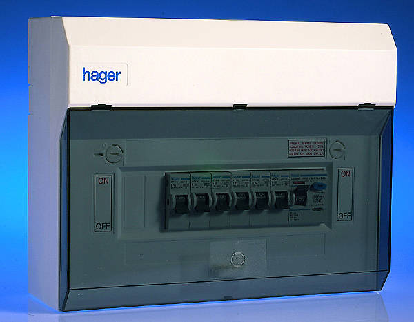

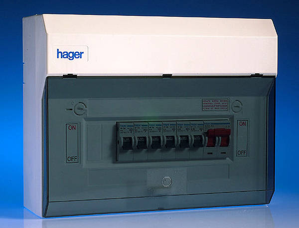

Don't know which Hager you've got, but have a close look at these photos and the main switch on the right - does yours look similar to this one:
or this one:
If the main switch on the CU says something about RCD, and has a test button, then you have what the leccy man meant by an "earth trip". If it's just a switch like the first photo then you don't.

You are a gentleman. Thank you for your advice .I have example 1 in your photo post , I guess I would like to have the rcd thing fitted to my cu and i know that it is something i wont attempt cos it means messing with raw mains coming into the house and I aint going down that road. I take it that the main switch that I have photo 1 can be changed for the rcd button type thing that is in photo 2. If you can possibly confirm this then i will buy the thingy and get a man in to do it .I dont want to change the whole consumer unit if i can avoid it .
If its possible to buy the thingy please tell me what to ask the man in the shop for cos that way i dont appear to be the dork that i am when it comes to this subject
Again thank you ban_all_sheds
you could even print this page take it with you and point at it and mumble some "foreign language" :lol:
or you could order it on line (its where ban_all_the_sheds got the picture from see) here
