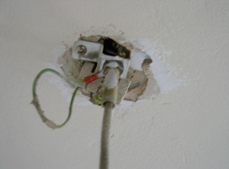

Having removed the rose from the light fitting, there seems to be an earth attached directly between the rose terminal and the light cable anchor, with a cross between a washer and a spade grip, as shown in the photos below.
My question is, will this be a good earth? It looks a bit dodgy to me....how would the light fitting itself be getting back to earth?
Also, if the switch has an earth, which it has, are the chances good that there is an earth (apart from the one shown in the photos) in amongst the cabling that I have yet to discover?
Cheers
Trev
Looks a bit messy.......it could be that this is a good earth and it is continuous throughout the circuit. Now we would need to see how this fitting is re-assembled so we can see the other parts.....this will give us an idea of the earthing requirements for this particular fitting.
Thanks for the reply. This is the old light fitting, and I was hoping to replace it with a new one I've bought which also requires an earth. So the whole thing will be going, apart from the cabling. Which means the earth will not be able to be attached using the spade grip washer type thing to the main body of the light fitting. Because it's not going to be there any more :)
If there is an earth, maybe cut back, in the exisiting cable, I should be all right. I was just wondering if the current configuration was common / safe / has ever been seen before?

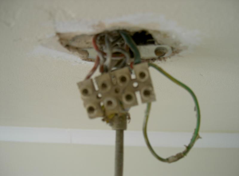

Can you show us a pic of the wiring as it enters the top of the terminal block? Also is the fitting itself metalic? Might be a CPC in the flex also.
It might be better to have the block terminated in a round ceiling box as opposed to having it crammed in there. http://www.tlc-direct.co.uk/Products/MTMDLB6.html
Photo of the terminal block - I can see a green wire going in from above on the right, so that should be OK to wire into the new rose.

Nice interesting bit of kit. You will need to identify the existing cables carefully when you change over to your new fitting. You should be able to dispense with the choc block.
