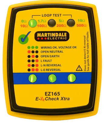

A plug in tester like this upload_2022-5-10_9-11-42.png with loop test, will not show if the earth is good enough, but it will show if an earth exists, there is also a version with a RCD test, note needs to have a loop test, in the main it shows if loop better than 1.9Ω and the pass mark for a socket is 1.37Ω and incoming supply 0.35Ω but proper tester costs around £200 but the plug in costs £50 other option is to hire a proper tester.
But if the £50 tester passes the sockets likely you do have a good earth. But don't use one without a loop test, they don't do a good enough earth test.
