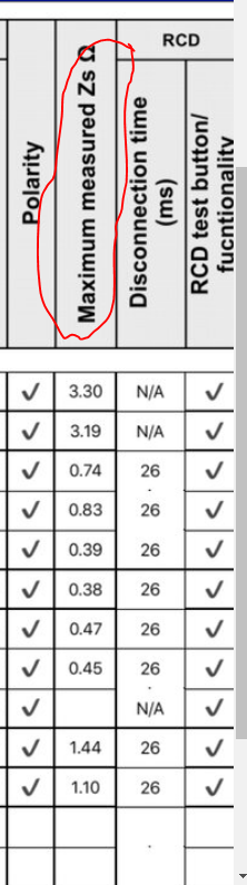

After sending an email with all the issues, constant non-replies and asking for an immediate refund they've now sent over an updated EICR (still failed of course) with the "light pendant are not cover with proper case" updated to C3 (which I didn't ask for them to do, just explain the regulation is violating and what they mean by 'proper case') and "Old type CCU non cumbastable material under stair case" to C3 too.
The only thing left as C2 is "Zs exceeded limit in 2 socket outlet" which I guess I will have to get checked before a pass... They are brand new sockets (like 7 months old) I had put into the wall when I had it replastered recently to fit on a TV. Hopefully, there are no issues under the wall and maybe just bad sockets... Now to find a local sparky to investigate.
And if my understanding is correct, I just need to get someone to investigate/fix/replace, write a letter confirming it's been done, and along with the failed EICR, that I would be compliant?
None of the values on the test results is over the limit - although circuit 9 has no figures entered for 'number of points' nor 'maximum Zs'.
And I note there are 3 RCD times missing and marked N/A. If there's an RCD then N/A isn't a valid result. Either they tested it and it didn't trip (properly/at all) in which case that would warrant an entry in the defect list. Or they didn't test it, in which case, why not - there's no reason I can think of for not testing all the RCDs in one go while your MFT and leads are set up for it.
So a "report" that's not fit for purpose.
Given the short timescales, you could be struggling to find another electrician - I hope you do. For the sockets over limit on Zs, one potential fix for that would be to simply downgrade the circuit by fitting a 25A or 20A breaker - but your new (and hopefully competent) electrician would be able to advise on that.

As EFLI observed, none of the recorded Zs figures appear to be 'over limit' (although one is missing).

OK, I should have written something like "if it turns out that ... then that can be fixed by ..." It may be that the missing value was for sockets that are over limit for Zs
