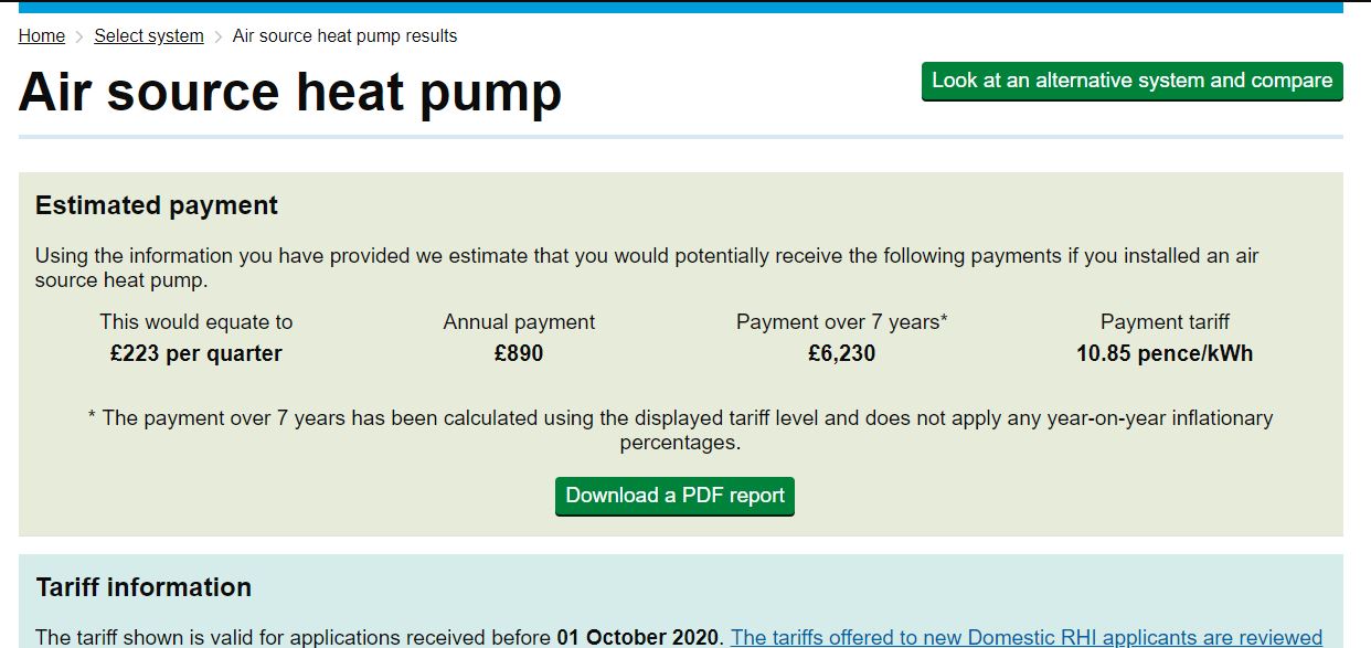

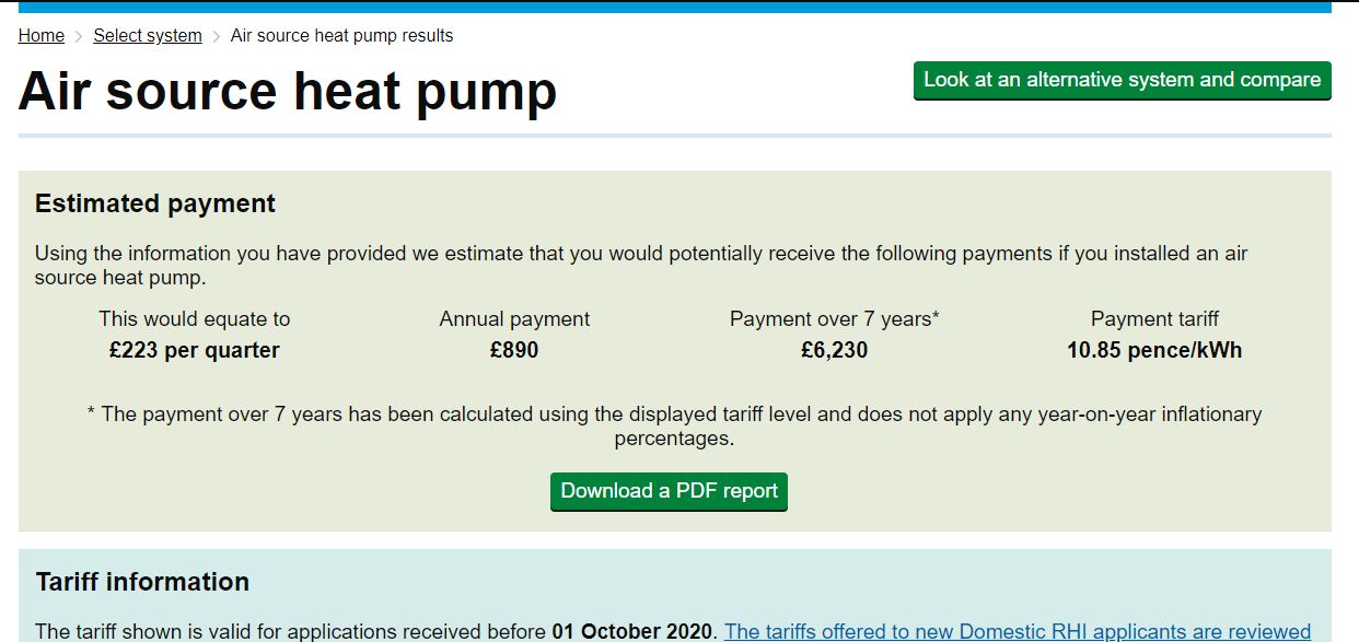

Given that you have solid walls, you would get a reasonable grant if you install air source heating to replace an older oil heating system. I get just under £800 per year and it is paid direct to me quarterly.
