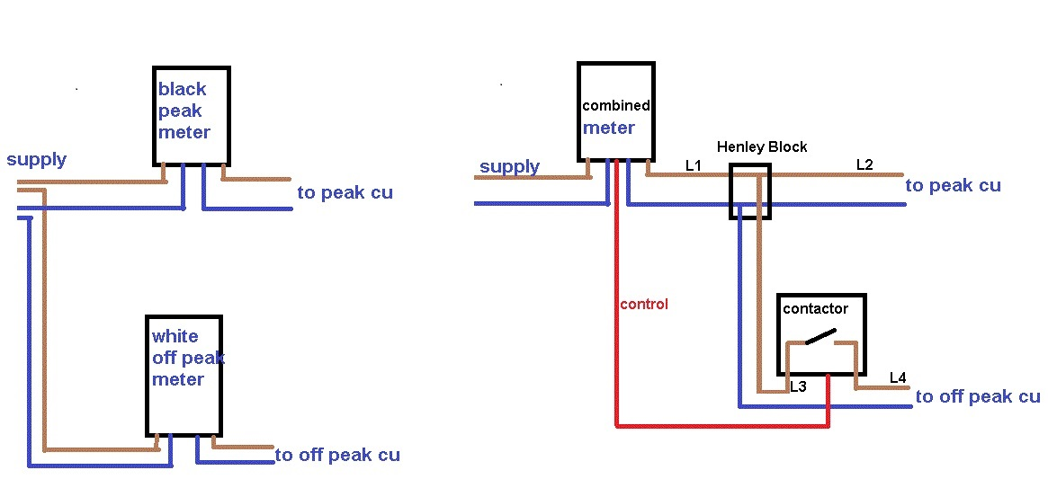

In the distant past, we had two meters - the usual black peak one, plus a white off-peak one. From memory, the entire supply, was either connected to one meter, or the other - so it was down to us, to have our own system(s) to switch on/off at the correct times.
We're both somewhat scraping the barrel of our dusty ancient memories but, like Sunray, I have a feeling that what you say is not quite correct.
If I recall correctly (goodness knows :-) ), the concept of 'cheap rate electricity' being available 'for everything in the installation' is something which 'came later' - and that in the early days of 'white meters', only the storage meters were wired to them, so that they were the only loads which enjoyed the cheap 'off-peak' rate. What I can't recall with certainty is whether, in those days, the switching of power to the storage heaters was done by consumers' time switches or ones supplied with the meter.
I remember the White meter which as you said fed its own dedicated fuse box, consumer units not out back then, there was a special unit for the immersion heater with two feeds, one from each fuse box, but can't remember how it worked. Can't remember where the time clock was, don't think the radio telelink was working back then, just a simple time clock.

That property I mentioned did indeed have white and black meters, AFAIC in my meter box I had just the 2 meters, the cut out and wires. In those days I didn't have a digital camera or mobile phone (which wouldn't have had a camera anyway) to sadly no pics.
In the property is trunking up the wall leading directly to the CU
There has never been a timeswitch of contactor after the meter box for the NSH's
The NSH's had no form of timers
One NSH had a second supply (13A plug in the ring final) for day time boost
The immersion heater was fed from both supplies with a Horstmann (Sp?) time switch. Still that controller except just the 24hr supply
I have only ever worked on one other white meter service and it too had had no form of additional contactors or time control within the property, either DNO or customer owned, that one had dual immersion heaters, bottom on cheap rate - top on 24hr
Heres one I made earlier
AFAIC the white meter switched the supply.
