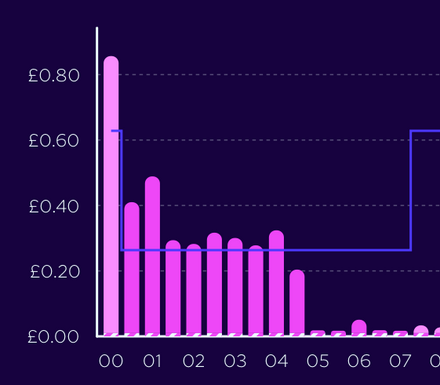

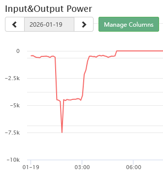

I set my devices to turn on late rather than early, if I look at my own use 1768868076928.png at midnight battery discharged, so there is some grid usage, but I don't start the charge of the batteries until 1:30 am, as I know they will be fully charged by 3:30 am, so since I have off-peak until 5:30 am I have 2 hours leeway.
Now with storage radiators they likely take longer,

I set my devices to turn on late rather than early, if I look at my own use View attachment 405275 at midnight battery discharged, so there is some grid usage, but I don't start the charge of the batteries until 1:30 am, as I know they will be fully charged by 3:30 am, so since I have off-peak until 5:30 am I have 2 hours leeway.
Now with storage radiators they likely take longer, but like with my batteries this shows View attachment 405276 that only 5 hours are required, and they have 7, so no harm in starting the charging of the storage heat battery late, it seems however looking at around 1.35 kWh per day, so peak - off-peak in my case is 31.94-8.50 = 23.44p/kWh extra x 1.35 = 31.644p and a timer able to handle 3 kW costs around £10, so 32 days to pay for its self.

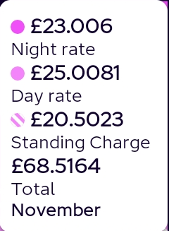

However, need to work out totals first, not sure a single storage heater pays for its self to start with? For every month I get one of these 1768869748231.png 1768869873082.png so average 13.616p/kWh so that for me is far lower than the 26.91p/kWh standard rate. For me, the difference is so massive, no real need to do all months, I can easily see the split tariff is better for me.
But with storage heaters, in summer Economy 7 will not save anything. In fact, it will likely cost more, so before spending out on timers, need to be sure it is going to pay. With my heating, I select when I want to heat, and to only heat as and when required.

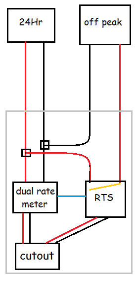

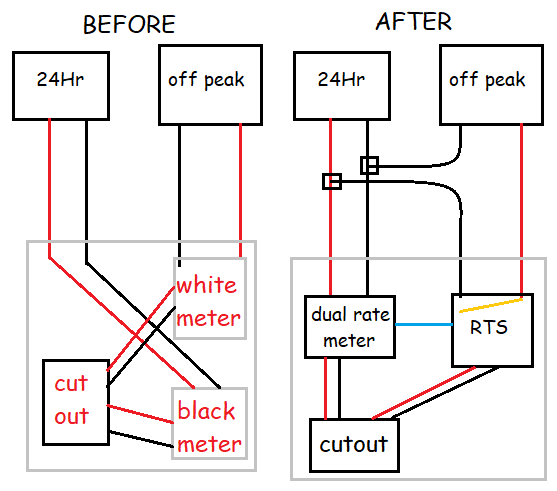

In the distant past, we had two meters - the usual black peak one, plus a white off-peak one. From memory, the entire supply, was either connected to one meter, or the other - so it was down to us, to have our own system(s) to switch on/off at the correct times.
Erm are you sure about that?
One of my flats had 2 meters when I purchased. At the change of ownership it was decided to change the twin meters. A fitter came out and stated he was not permitted to make the alterations at the 2 CU's (actually both ends of a single CU) as the 4 tails plus earth went through the wall then in trunking. I received a letter stating I had to do some rewiring at the same time as the meter change and included a drawing in advance for the attention of my electrician and they would supply the connector on the day.
On the day the fitter handed over a used Henley and said he had not seen a white meter for a long time.
This was a bit over 20 years ago. I'd been in the meter box to read the 2 meters and AFAIC it was wired as BEFORE with the black and white meters & cutout. I had no form of switching in the house
Why it couldn't have been done like this I don't know
as there was plenty of space in the meter box. and ruddy awkward to fit the Henley by the CU.
As it happens, when I changed letting agents later; one of their requirements was a single main switch which I was able to reconfigure without too much effort which I wouldn't have been able to do as easily.
I set my devices to turn on late rather than early ...
I've always done that with my E7 water heating, which needs power for only about 2.5 hours even if the cylinder starts 'cold' (which is very rarely the case - 1 hour or less of heating is more normal) - so I can have it coming on 'hours' after the start of the off-peak period 'to be safe' (and its obviously better to have the heating happening towards the end of the cheap period)!

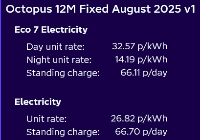

But I did the research some time ago, and rates have changed, I looked at the time 1768920225114.png night rate more expensive, but runs for longer, but my battery will charge in 1.5 hours, so for me 5 hours is ample. But EV users, 5 x 7kW = 35 kWh, which for some is not enough, but looking at 50p per night saving using Economy 7 if using the whole 49 kWh, and a likely loss if not using it all, and my son pays 6p/kWh as he got the car from Octopus, together with whole installation.
