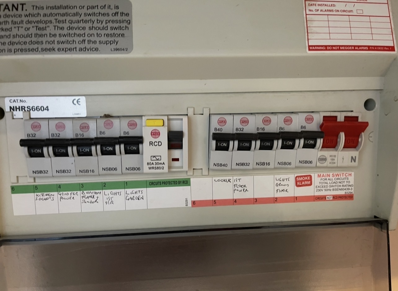

Hi Folks,
I have a small house which I am thinking of renting. I know I will need to get an EICR to do this.
The distribution board I have was installed under the 17th edition of the wiring regulations.
This means I only have one side of the board protected by RCD.
Does anyone know if I will need to change the standard unprotected MCB’s with RCBO’s to pass an EICR now or will it just be a C3?
Thank you to anyone with the knowledge willing to tell me :-)
I think you are getting your editions mixed up, your install looks like a "16th edition" configuration to me.
If all of the following are true.
* The inspector follows the guidance from electrical safety first (which is the closest thing we have to official guidance, but is still not particularly official)
* The inspector believes that first floor sockets are unlikely to supply equipment outdoors.
* The labelling on the CU reflects everything that is fed from the breakers
* There are no other issues not visible from what you have shown us.
Then I think the install should only get C3s and be marked "satisfactory".
I agree with you for an EICR not specified for rental property, it can be considered OK for continued use.
However, it is not really a standard EICR with rental property, the IET divides the inspection and testing into two groups, the installation, which does not include current using equipment, it is only the wires, sockets, and protection devices, and what it calls in-service electrical equipment, which we tend to call PAT testing.
The landlord law uses a different split, being portable or not, so that items like tumble drier and dishwasher can be included in the testing for the general house.
The general requirement has dropped code 4 does not comply with current edition of wiring regulations, but the landlord version is tided to BS7671:2018.
As an inspector, we use our judgement, and for an owner occupied home, the report is not really transferable, but with a rental, we have to expect all sorts, including wheelchairs, as to how far we take it, is up to us as the inspector.
