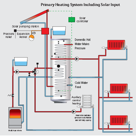

We now have a split tariff with low overnight charges for electric, and we have seen where hot water is stored, this system is very expensive to install, Torrent pipe example.PNG but my brother-in-law had it in his last house, and the massive storage tanks, I would guess around 200 gallons, did allow use of off-peak electric to heat the house, the storage tank was in fact two tanks, on a reinforced floor to take the weight, his solar was PV only, which heated immersion heaters, he had LPG and a wood burner, and his heating bills were very low, but when he moved to install that system other than when first built, just cost too much.
