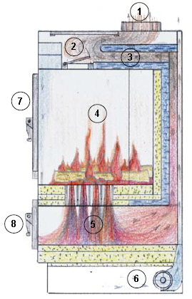

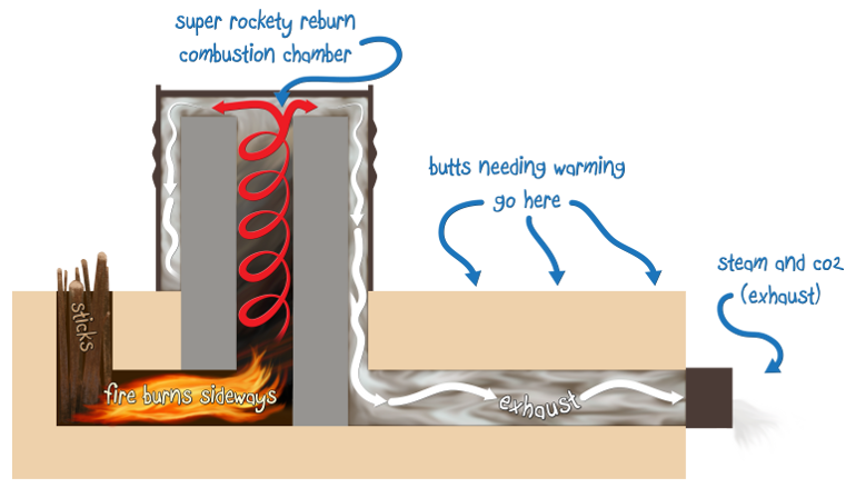

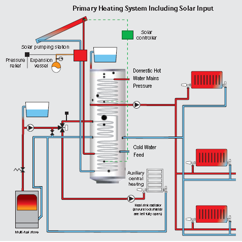

The wood burner I assume some thing like this?

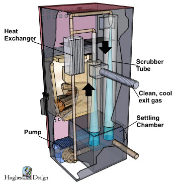

As to how efficient I don't know,
the unit shown is super efficient however most people use the cheaper types,
however today the units are rather complex even with simple types to stop particulate emissions, no longer do we have open fires, in most places they are not allowed, and the new units have a fixed burn rate to keep the temperature in the flue to 150°C the top one has horizontal plastic flue as gases so cool, but it needs the store shown in top picture as the fire does not vary much in output, in fact oil fired boiler have the same problem, where a gas boiler can deliver 6 kW to 28 kW oil is more like 18 kW to 24 kW at best, many are fixed output. As is the wood burner, however unlike oil you can't switch wood burner off/on 20 times a day, so a burn say 6 pm to 10 pm heats the water which then keeps house warm when wood burner not running.
So the electric systems is very much a part of the wood burning system, and as diagram shows maybe even solar panels, although to be frank in North Wales water solar panels don't work, great in Turkey, not so good in UK. So often solar panels are electric and excess is used to heat the water store.
Even possible to add heat pumps, however the problem is cost, all very good on paper, until you cost it.
There are home made wood burners that are very efficient, however as to if you could get insurance is another question. With last picture it is a mass of stones and concrete which stores the heat, not water. But you need to look at is as a whole, not individual parts. So much depends on what you have.
You can likely get away with a non compliant wood burner using it at Christmas day, but all year around is another story.

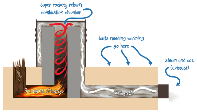

Even possible to add heat pumps, however the problem is cost, all very good on paper, until you cost it.View attachment 162691There are home made wood burners that are very efficient, however as to if you could get insurance is another question. With last picture it is a mass of stones and concrete which stores the heat, not water. But you need to look at is as a whole, not individual parts. So much depends on what you have.

I was asked to write a web page stating how bad wood burning was. I felt uncomfortable with this, so first decided to do some research before writing the web page, and it seems the guy was right as to how bad burning wood is when done in a cheap and nasty wood burner as sold for DIY install by likes of B&Q and in the main the clean air act, and building regulations will not allow it. The heating in the house can be changed for one with a slightly lower efficiency rating that what is already fitted, I can't remember how much, but cheap wood burners are often down to 40% efficient which could not be used instead of oil central heating at around 80% or more.
I was surprised there was only one condensing commercial boiler running on wood, the picture says Hughes design, what seemed wrong was there seemed to be no safety cut out in the case of a power failure, so not sure it is really an option, the home made last picture is also condensing however again not likely to get insurance, so third picture or similar is about the best we can get, only around 80% efficient but it also complies with clean air act by taking the gases to such a high temperature, there are other methods including scrubbers in the flue, but one is looking at around starting price of £1000 for the fire not £150 B&Q special.
