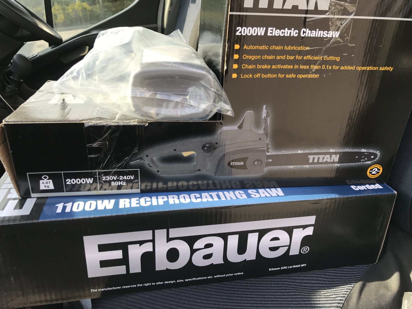

I would go for a leccy chainsaw.
I bought the Titan chainsaw for cutting hardwood boards at work. Its a great saw, with a clutch so when you release the handle the chain stops instantly, but the motor slows down normally
Bear in mind it is a budget saw with plastic parts- Im on the 2nd one at work, the first one wore out the spocket and bar tensioning, but it did do about 3 years of work in a joinery company, so for DIY use I would say it would be fine for years.
https://www.screwfix.com/p/titan-ttb355chn-2000w-230v-corded-40-5cm-electric-chainsaw/92771
personally I would think a recip saw painfully slow -I tried one for cutting up logs etc and found it bounced around too much.

(did you get some new blades for the Rep Saw as the ones they come with are not very good).

Thanks, I hadn't noticed that the Black and Decker isn't an alligator.

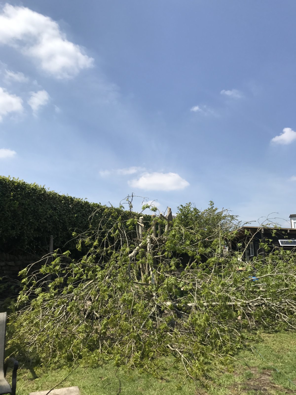

I've had a go of the chainsaw and love it :). I chopped a few small ones first then a big one over the wall, I can see a bit of sky through there now.
The chainsaw needs the chain and blade? attaching and then filling with oil before you use it. The closer you have it to the wood the smoother it cuts.
I need to work on my technique now.

I guy half through that then pull it into our garden. Managed to fall over when it went :LOL::LOL:

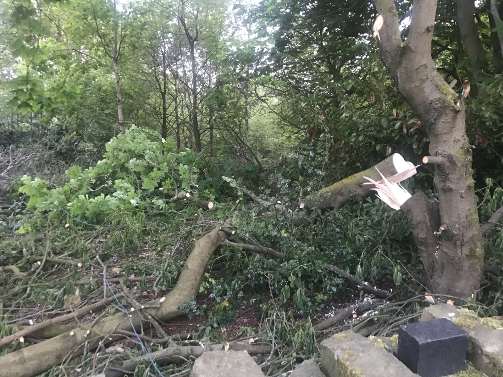

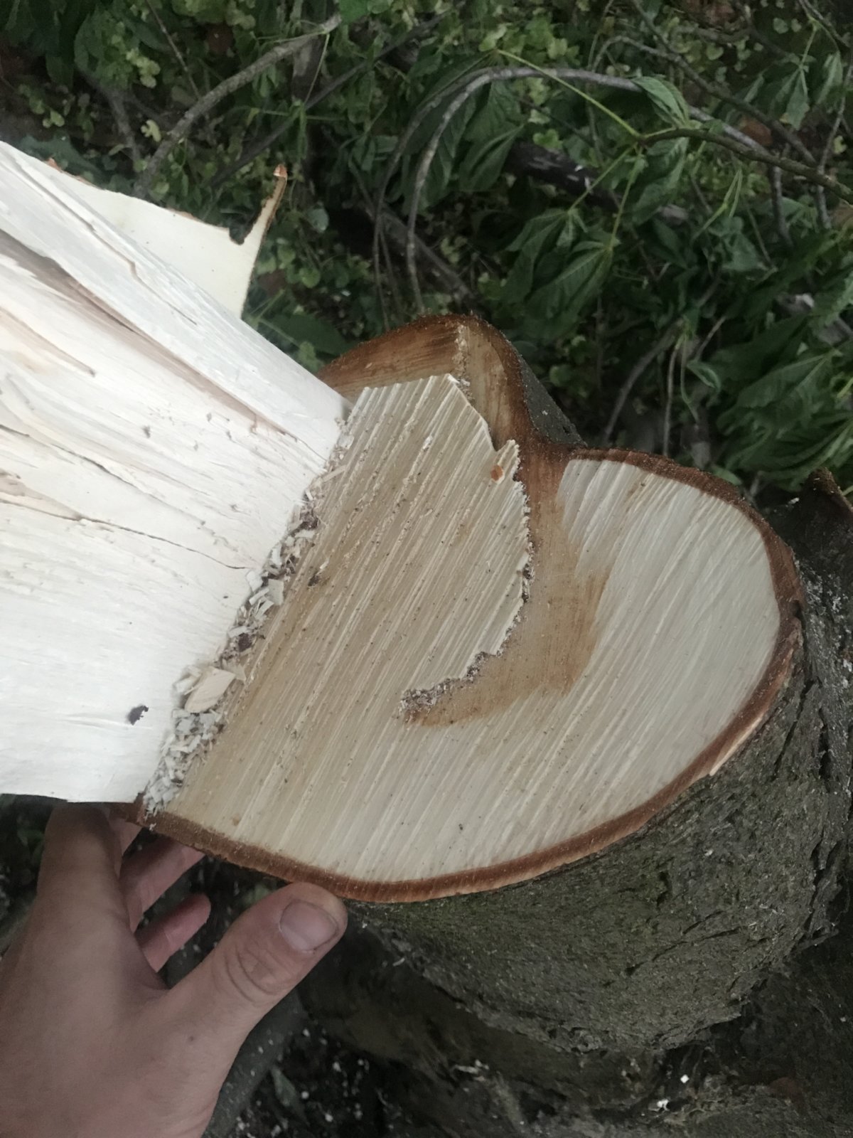

I can see from your pictures your not putting a sink , aka gob cut, before cutting the tree/branch off which should help with tearing but you look to be having fun?
litl
I'm having great fun!! But I will take your advice and see if I can do it better :)
