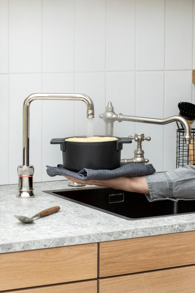

A Quooker is basically a vacuum flask of near-boiling water that's kept hot - it doesn't heat the water instantly.
If you use all of the stored boiling water, you will have to wait until it has heated more.
Thanks, I hadn't realised.
That's really interesting, and not something that's featured on their advertising bumf!
Especially when they have pictures of pans being filled!
