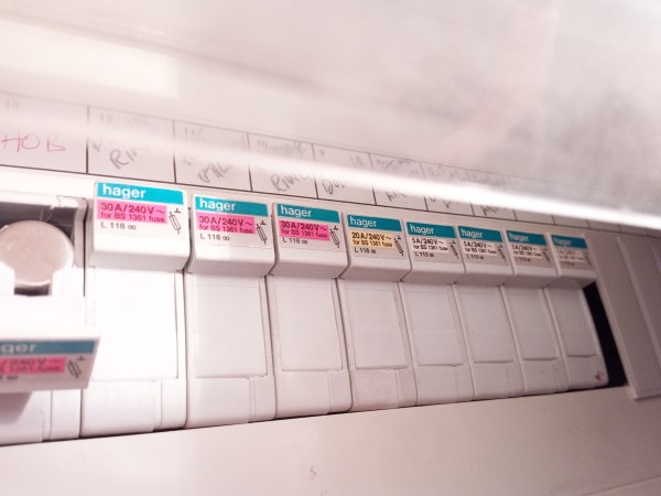

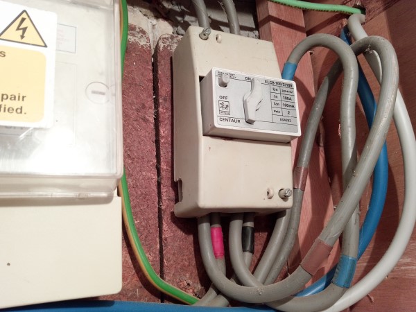

No it's a fuse, Sorry maybe i am not explaining correctly. I know what an RCD looks like and I dont have them. So to explain if all my fuses were in place and i turned on the electrics the main switch would trip and everything would go off. opening the fuse holder for each section e.g. upstairs ring, downstairs lights, cooker etc I have managed to work out what circuit is causing the issue and that's the cooker. hope that has explained it, please put me right if I have explained it incorrectly.
So which is it?
A fuse or a switch?
How about a photo?
Sorry it's both the electrics have one main switch that turns off all electrics, the fuse board is made up of about 10 fuses different sizes. Please see photos
