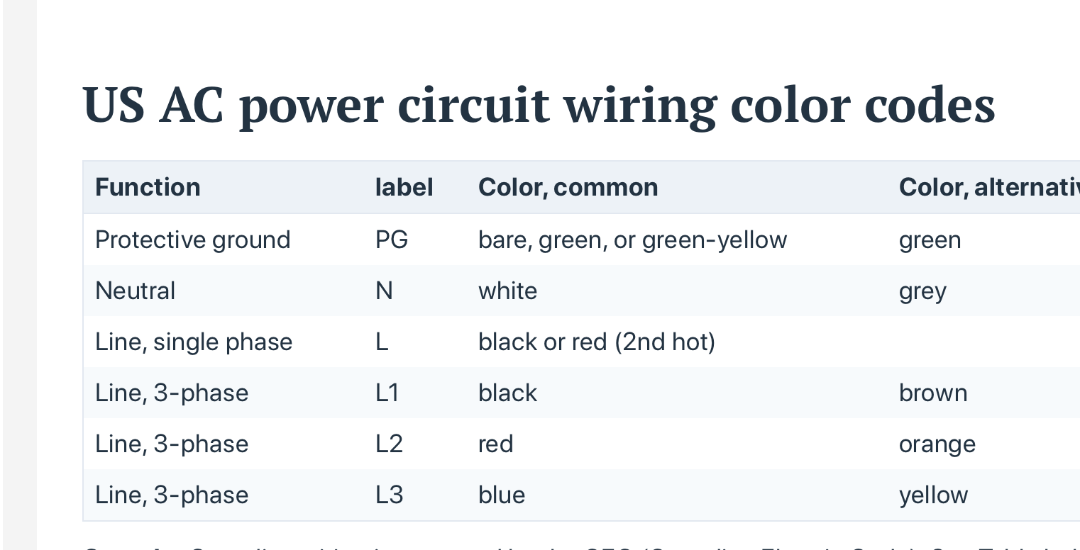

I have a ladder-style heated towel rail, not cheap, but I suspect from China...
The problem I have, is that the three core flex has a black, green and WHITE conductor in it!
Any convention for what each might be? Green for earth is logical, but any help appreciated.

EDIT: Found this US coding...
Are there no instructions with it?
Well, that is quite clear.
HOWEVER, if it is for the US, it will, presumably be 120V and so unusable.

Reread the spec/order. Paperwork states 110 to 240V. I plugged it in for a test, seemed ok.
Ok. I don't know if anywhere that uses those colours is on 240V.
Have you a link to the product?
Mmmm. It says currently unavailable and there are no reviews, so...
Anyway, It does say 110 - 240V so I suspect any U.S. customers will be disappointed because IF it is 162W @ 240V (although it doesn't actually say that) it will only be 81W over there. Or vice versa.
If you have had it working without burning out or getting too hot then I suppose it must be sort of alright. :)

Well you could rethink your calculations. Halve the voltage, you halve the current and the power will be a quarter, namely 40.5 watts.
But it may of course have some form of switch mode supply meaning constant(ish) power over the range.
But, whatever, it is illegal for Amazon or anyone else to sell it in the UK with US wiring colours. I would be reporting it to Trading Standards.
