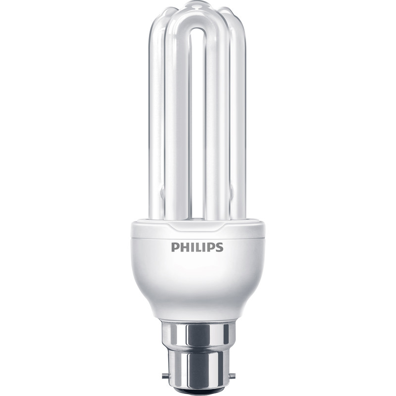

My eldest son visited us last night and ran round the house counting the number of electric light bulbs left on so now I have to do something about them and I need help.
To start with we have four wall light bulbs marked, "220-240V50/60Hz24mA" They are approximately 100mm tall, 35mm wide and the bayonet is 20mm wide I don't have the faintest idea what that is in watts, more to the point what power efficient bulbs I should replace them with and whom from. This could be an interesting journey.

Pretty sure they will be LED lamps. Possibly they are CFLs. Either way, The electricity used is negligible. Post a photo to confirm.
From your description they are 6Watts each. You could leave one lit for 160 hours using 1 unit (1kWh) of electricity costing (depending on your tariff) around 15 pence.

Simple way, is to feel each lamp when it has been on a while and if hot to the touch, then they are incandescent - so you should consider replacing them with LED versions. Look at the wattage of the lamp, and dividing by around 10, will give you an equivalent light output in LED. 240v at 24mA suggest LED and around 5w.
Changing CFL's (compact florescent lamps) which were a replacement for ordinary lamps and tubular florescent is less important, as they are almost similarly efficient.
FYI, this is a CFL (compact fluorescent lamp) and almost as economical, not worth changing, except perhaps in a WC as they take a while to warm up to full brightness.
A lot of these were given away by electricity companies to save energy. They last for years.
