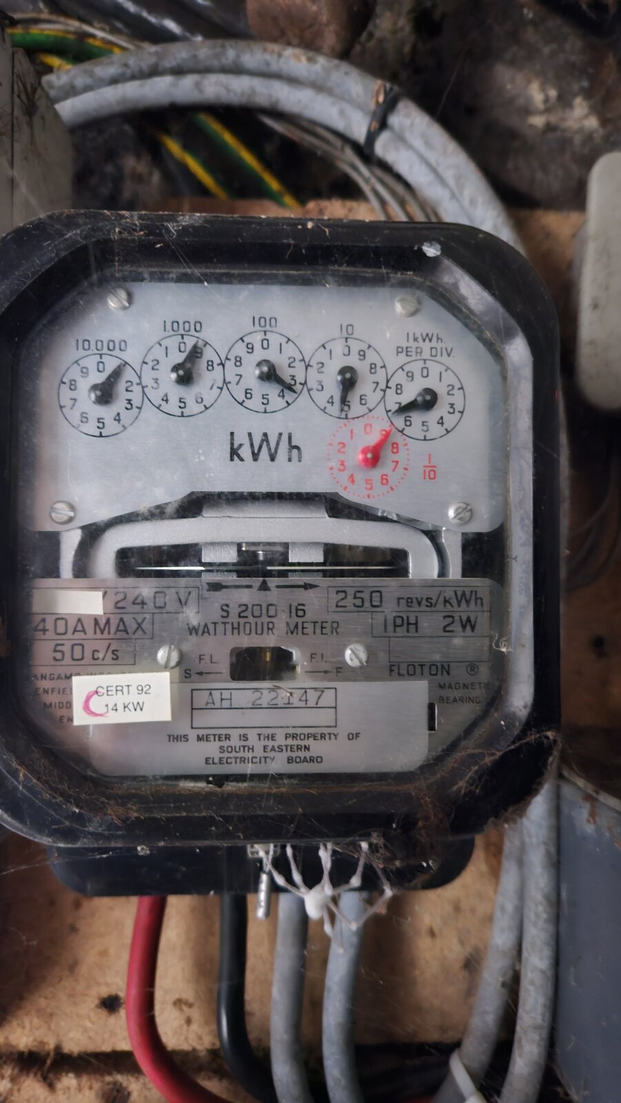

HNY 2025 - despite my best intentions and following instructions, often get it wrong so thought I would double check what people are reading.
83241 kWh
I am sure i got it wrong again :-(
I believe that's 09346 kWh
The meter has over cycled in the 10'000 kWh range.
I'm afraid I have no idea how you got to 83241?
9346.8
On dials where the numbers count up clockwise, look for the nearest number anticlockwise of the needle
On dials where the numbers count up anticlockwise, look for the nearest number clockwise of the needle
amazing - thanks so much, I will never never get it right! I should ready get a smart meter installed - but as it is for the communal hallway can't really bother - and unsure of the benefit for that communal hallway anyway to have smart meter vs that old dial one.
09186 last year - only 160 units used? Is this meter for an out building?
Edit - I've just seen the communal hallway comment above.
Love the mummified spider!
Anyway, better than the 74'000 units you were about to submit. I would make that around an £18'500 electricity bill? :)
yes indeed communal hallway from Freehold - yes hence why wanted to double check - do one submission every January now - but i do not trust myself with the reading!
gosh and then it would have been a fight to get this corrected if i had submitted that wrong number! they so eager to take your cash! lol
