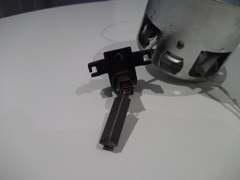

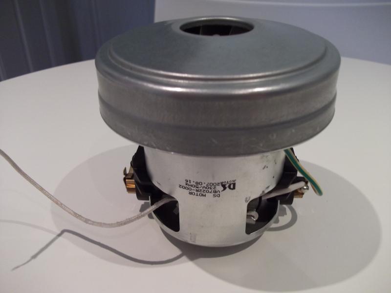

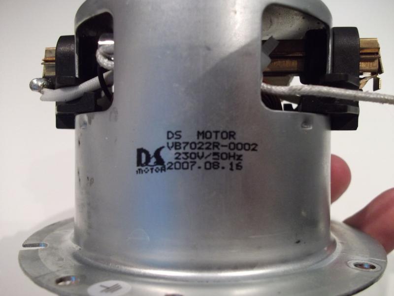

Its a DS Motor 600watt Motor (230v / 50hz). I have taken it apart, please see the pics:

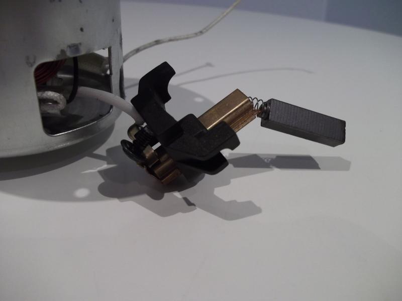

Brushes look fine.
Whats the resistance thru the windings?
Fine emery on the rotor and brushes reassemble and try that.

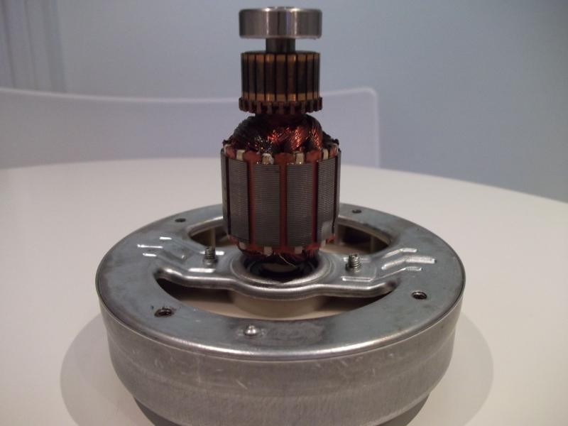

As posted elsewhere, the motor looks to be in good condition.
I suggest re-assembling it and trying the methodical approach.

I agree,there's definitly nothing wrong with the brushes

As stated, the brushes look fine, in fact a new set would probably only be a fraction longer than those so you can rule them out.
Lightly clamp the motor in a vice, making sure it is secure, then apply the required voltage across the two mains leads. If the motor starts then the problem is elsewhere, if not then you can do the following;
LIGHTLY polish the commutator with GLASS PAPER NOT EMERY.
Emery contains metal grit and will lodge between the segs of the comm causing shorts. After polishing brush the dust away with a small DRY paint brush then a good strong blow of air from your lungs. After assembling make sure the brushes are in full contact with the commutator. Check the ends of the brushes are contoured to the same curve of the commutator, if the ends are flat they need to be 'bedded 'in' by wrapping 1 1/2 turns of smooth glass paper around the commutator, replacing the brushes and manually turning the armature, (the rotating centre part), about a dozen times. Remove the brush and examine to see if it is contoured correctly, If not then repeat until they both are correctly bedded in.

That looks like a vacuum cleaner motor as used with the larger commercial vacuum cleaners. Each cleaner would have between 1 and 3 units and they were fairly universal.
I converter a concrete press to use those motors rather than using a Pnewvac unit saved on air use.
Have a look Here these look very like your picture.
Likely you can also get all the spares you need.

RF, nothing burnt out there mate, its just the enamel colouring of the windings. There are no indications around the slot edges of burning and the comm looks an even shade with no visible spatter or burning.

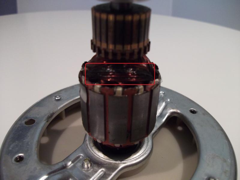

Apolgies for the general ignorance but is the "Windings" the many strands of copper wire? There is what looks like some burning on a section. See the picture below, would this be the fault? If thats the case is it a new motor?
Yep, the windings are those pieces of copper wire.
It isn't looking too good for the motor to be honest, if it is the windings then it will probably be more viable to source a new one than to rewind it.
When you get a multimeter stick it on ohms range and measure the resistance across the commutator from one side to the other, then work your way around each pickup pair keeping the multimeter leads on opposite sides.
The resistance of the windings ought to be equal all the way around the motor, if not it is bin fodder.
