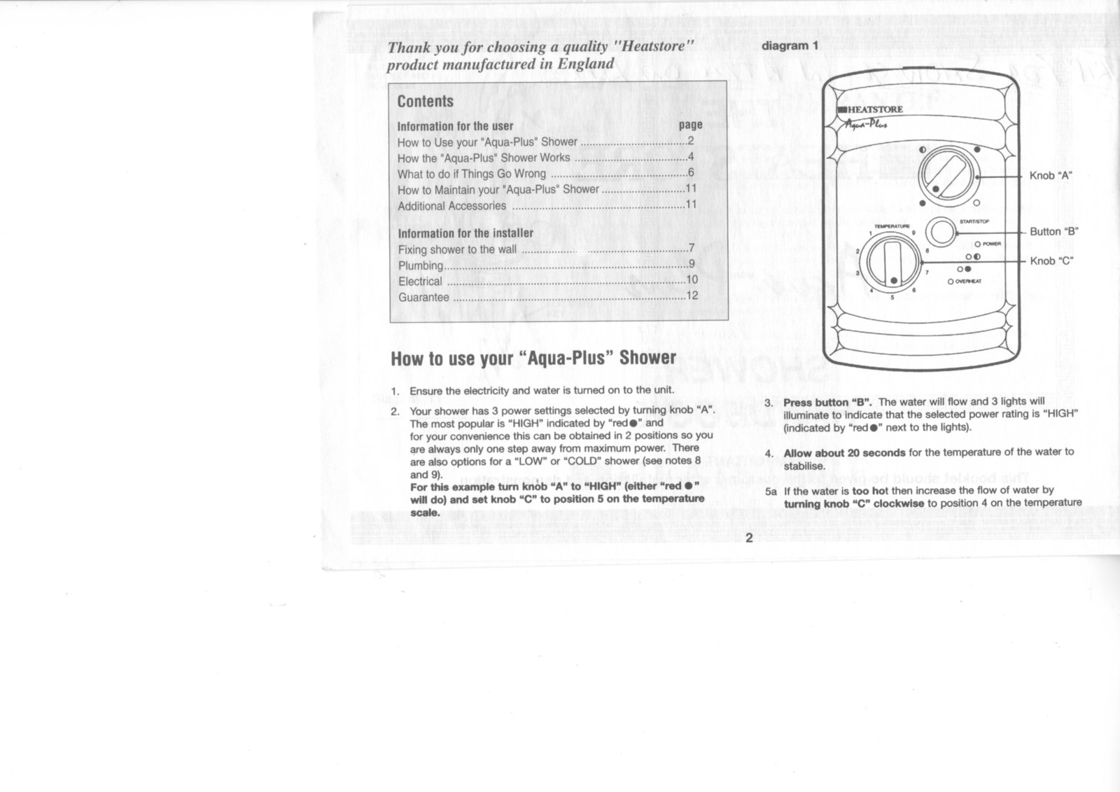

Posted photo. Unable to find out if 8.5 unit. What size of fuse would it be
Most electric showers have an identification label on them somewhere (usually near the outlet) with the kW rating on, something like this example:
That's Not the Consumer Unit, which was requested jd? If your shower is indeed 8.5 KW : 8500W/230V = 36.96A .
The Fuse maybe overloaded on Full power so over a period of time may become hot while the Shower is running, it's there to protect the wiring not the shower though.
