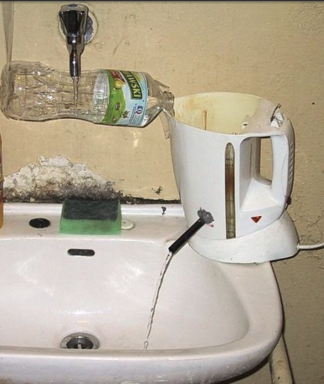

One reason I noticed these things is to make a water warmer for a handwash in my shed, I had a few different shower units for spare or repair and decided to measure element resistance so I did a quick calc for each different rating then observed measurements.
What was wrong with your first attempt?
Sadly I didn't take a picture, before the days of cameras on phones, but a lot of years ago a friend had an unused upright freezer in the garage, in the hot summer he took the door off, cut some holes in a sheet of ply and fitted a couple of ex PC fans then screwed the ply to the garage door from the house and stood the freezer tight against is. The freezer was in the garage so the fans drew the chilled air into the house.
The poor freezer was obviousely working flat out and doing it's best. Of course it was not particularly effective but it did make a difference.
I am glad that you posted this picture of this first attempt my friend ;)
