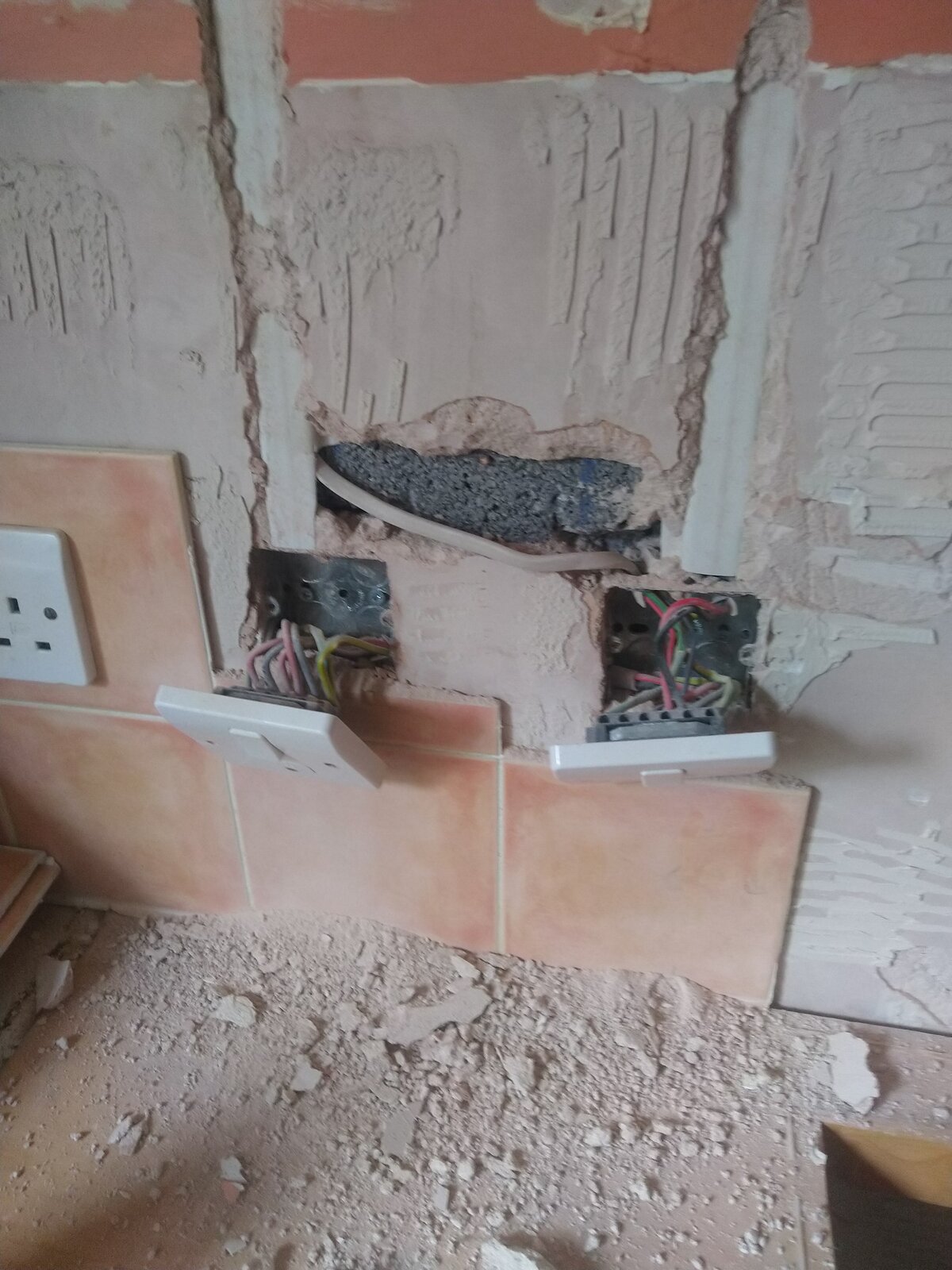

Hi all, DIY isn't really my specialist subject so just thought I'd ask before I went ahead and did it.

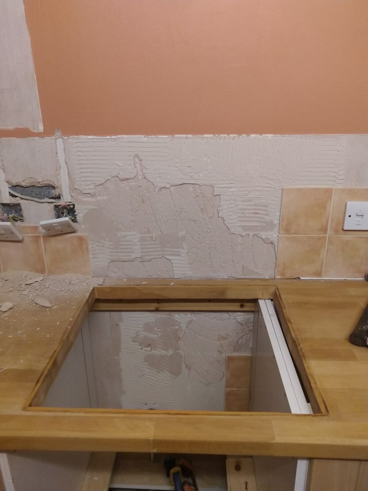

I'm changing my kitchen but the worktops are second hand. The hob is roughly 50mm further left than my stand alone used to be, and what with having a splashback and a cooker hood I'm having to lose an electrical switch that controls the original built in ceiling extractor.
Around 100mm to the left is another electrical switch that controlled some sort of weird heater matrix thing that broke years ago. That switch will be staying but I want it to control the cooker hood instead.
The right hand switch that's going is the one with the feed to it, then it's spurred to the left hand switch.
Can I use chockblock or a junction box to connect the feed to the spur, bury it behind the splashback/tiles then use the wiring for the original extractor to supply the new cooker hood?
Apologies if I've gone about describing it the long way round......:)

No, because the feed to the switch you are losing will no longer be in a safe zone.
If that grey cable coming from the left and going to the right hand switch is the feed to the right hand switch then you should be able to connect it to the left switch and, possibly, do away with any form of connection block.

In general cables in the walls must be horizontally or vertically in line with an accessory, though there are variations near corners or ceilings. These are the safe zones. The switch you intend to remove appears to have wires coming down to it. If you remove it those wires will no longer be in a safe zone.

Basically the zone are the routes where cables are allowed to be installed. Basically these are in a line horizontally or vertically from a socket, switch or other wiring accessory. Plus some other areas near corners and ceilings.
It is described here https://www.diynot.com/wiki/Electrics:walls

So would my only option be to trace the feed from the right hand socket back up the conduit and then feed it back down the conduit to the left hand socket that the feed to the electric fan goes up?

I don’t think you mean ClickFlows. They are large connectors. Wago connectors might be more suitable. You could make the joint in the box and put a blank plate over it to denote the presence of cables.
Obviously not disputing what anyone's saying but seems odd it's not a safe repair if it'll be behind a splashback and cooker hood.
A future owner of the property will not know the cable is there and could be electrocuted should they drill into the areas fit a knife rack etc. It has happened. STORY
Yes. In fact I can see a contravention in the existing wiring. The cable that comes down the left hand conduit is routed diagonally to the right hand FCU. That is outside the zone, so needs sorting in any event.
