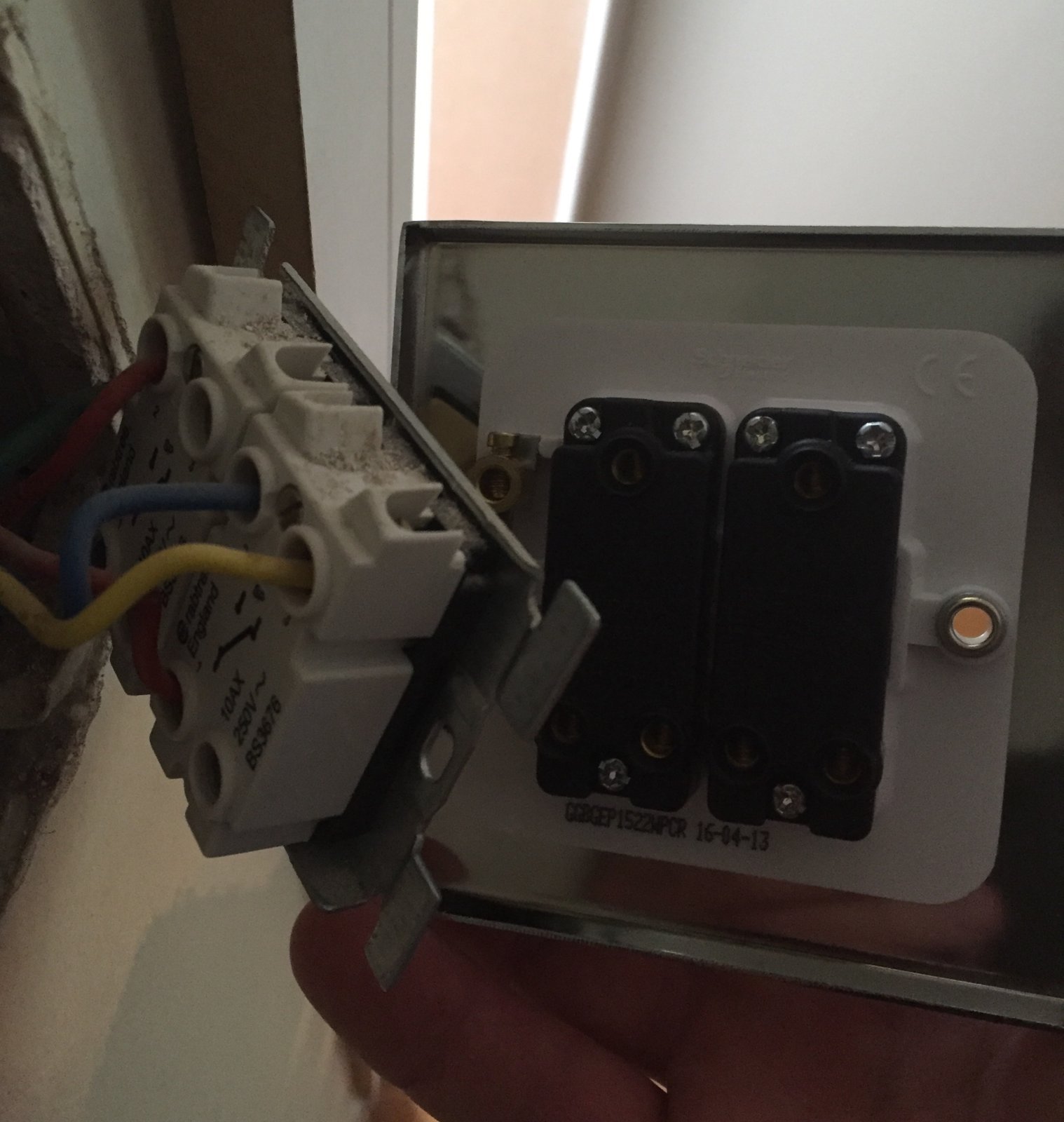

Hope someone can advise me how best to wire the new switch replacing the old one on the left (see photo).
This is a downstairs hall switch controlling lights one upstairs and one downstairs in the hall.
The new switch has COM and 1 Way & 2 Way ports.
The old switch has 1 (In) 2 and 3 (out).
Any assistance most welcome.
Cheers
1 = COM (the single hole at one end of the switch)
2 = 1 way ) the two holes at
3 = 2 way ) the other end of the switch
If the light is on when it's off and vice versa, swap 2 and 3.
