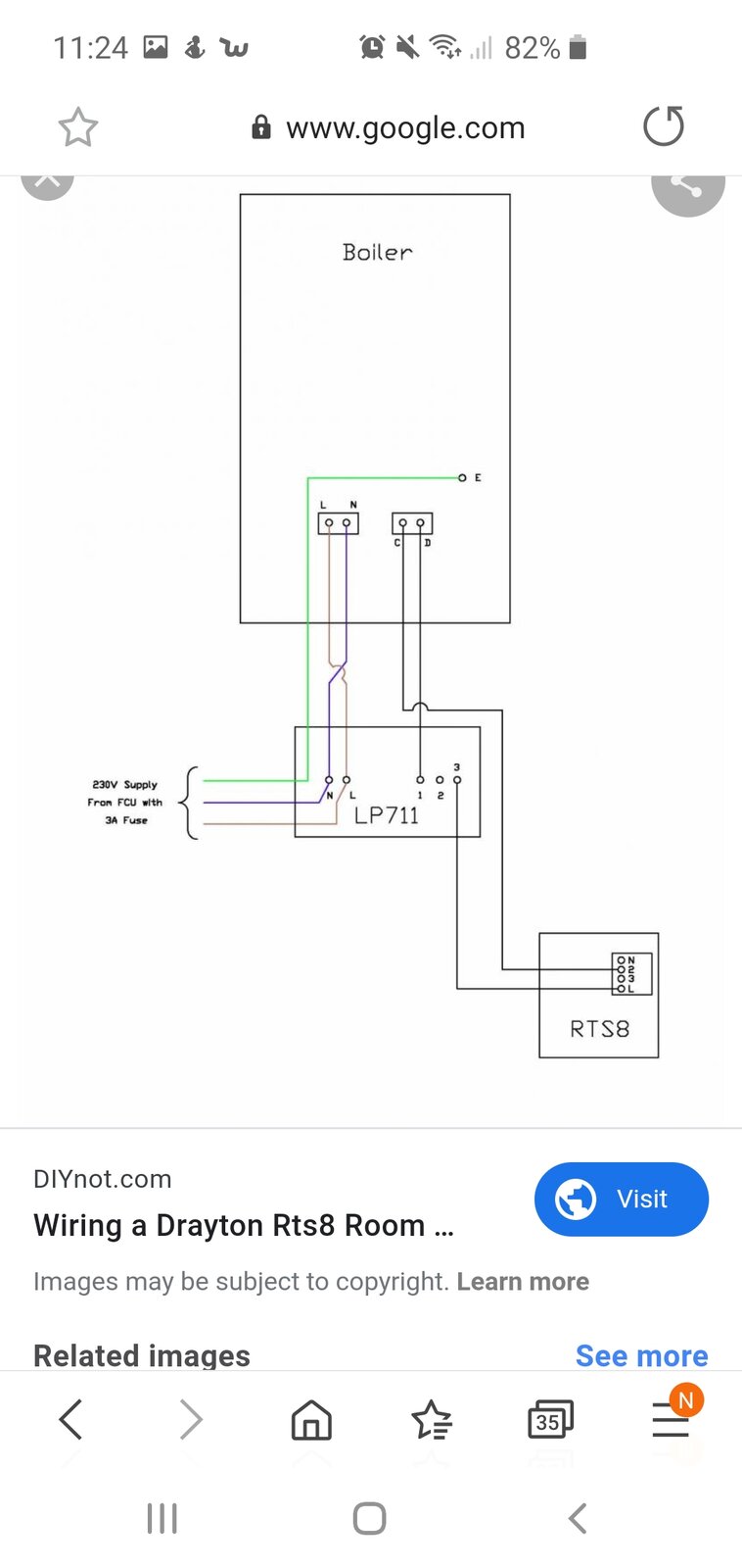

I have a drayton lp711 timer fitted but have no thermostate control, can I connect a RTS8 straight to the timer ?
What does the timer switch on and off? just the heating?
If so, you can connect via the timer. Do you know how to do this?
Yes its just the heating. Not sure yet I have a diagram below but its says connect straight from boiler. Help please.

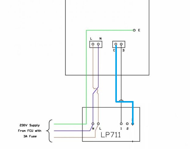

Yes, but without the thermostat you must have this:
You need to split the blue wire somewhere - anywhere - and connect the thermostat.
Where are you going to put the thermostat.
So I need to cut the blue, do I then put it in to a junction box then into the thermostat.

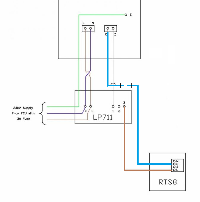

The thermostat will probably go near to the timer.

Depends where it runs. It might not be blue in real life.
Just disconnect it and use a connector behind the timer.
Thermostat Instructions are here colours mean nothing, although blue could be neutral it is not always neutral.
