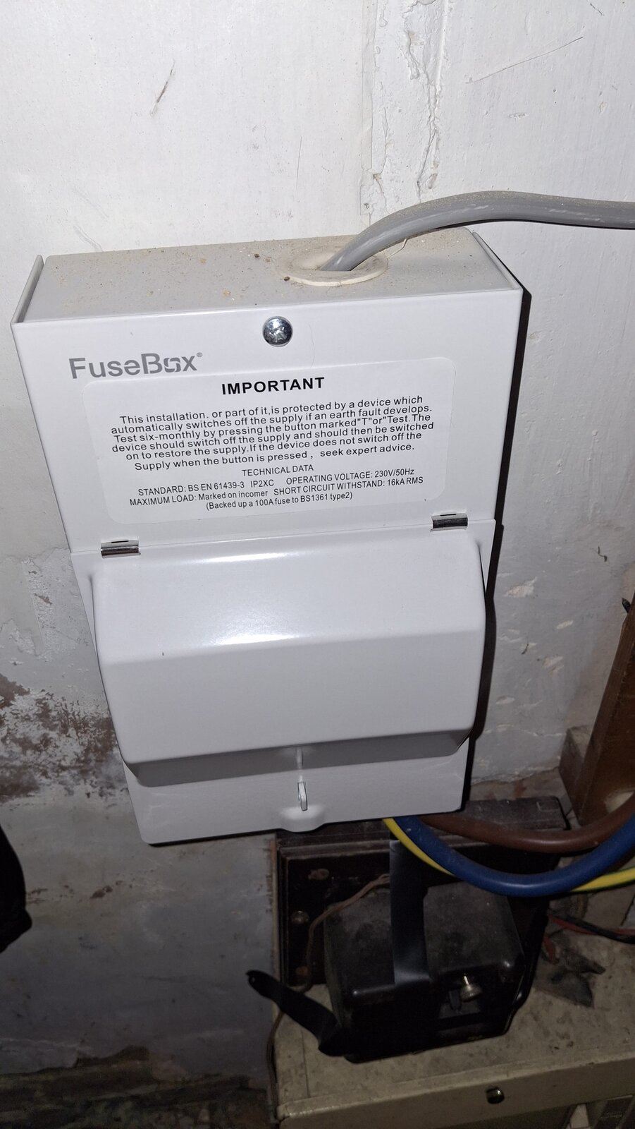

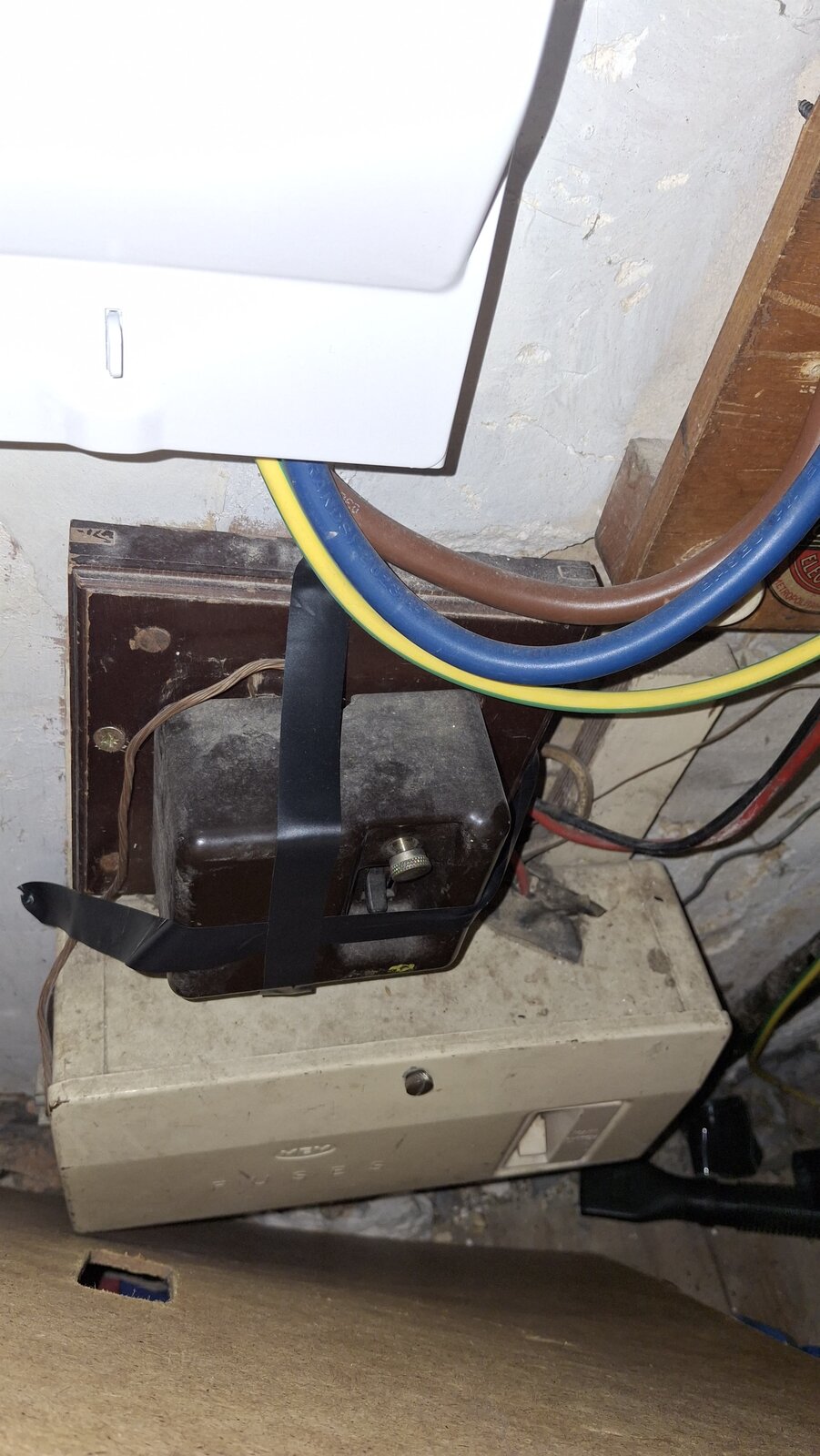

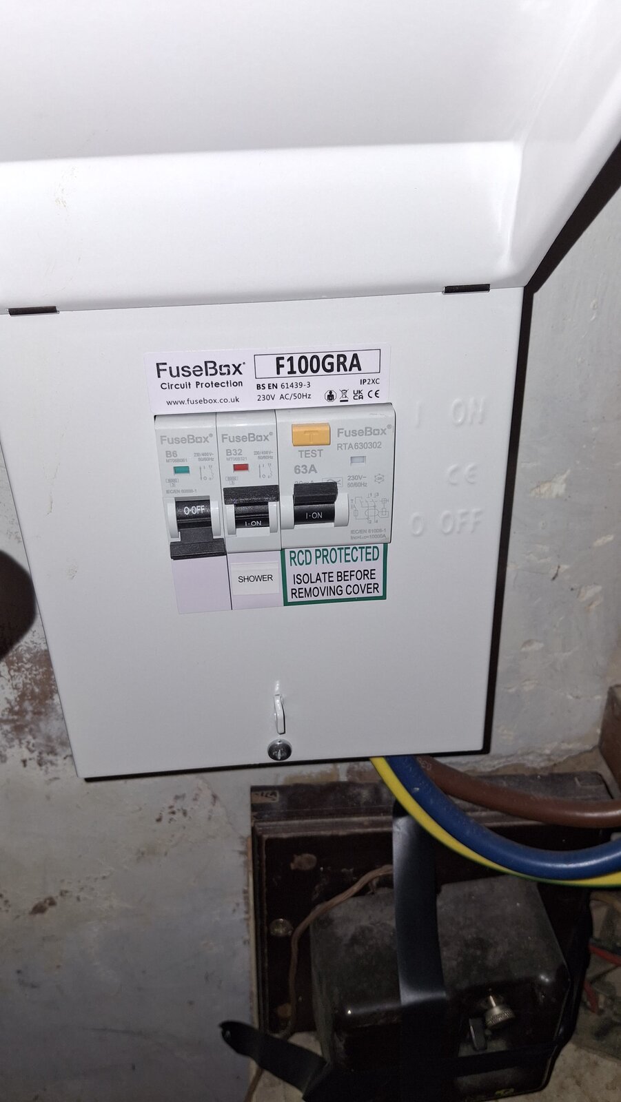

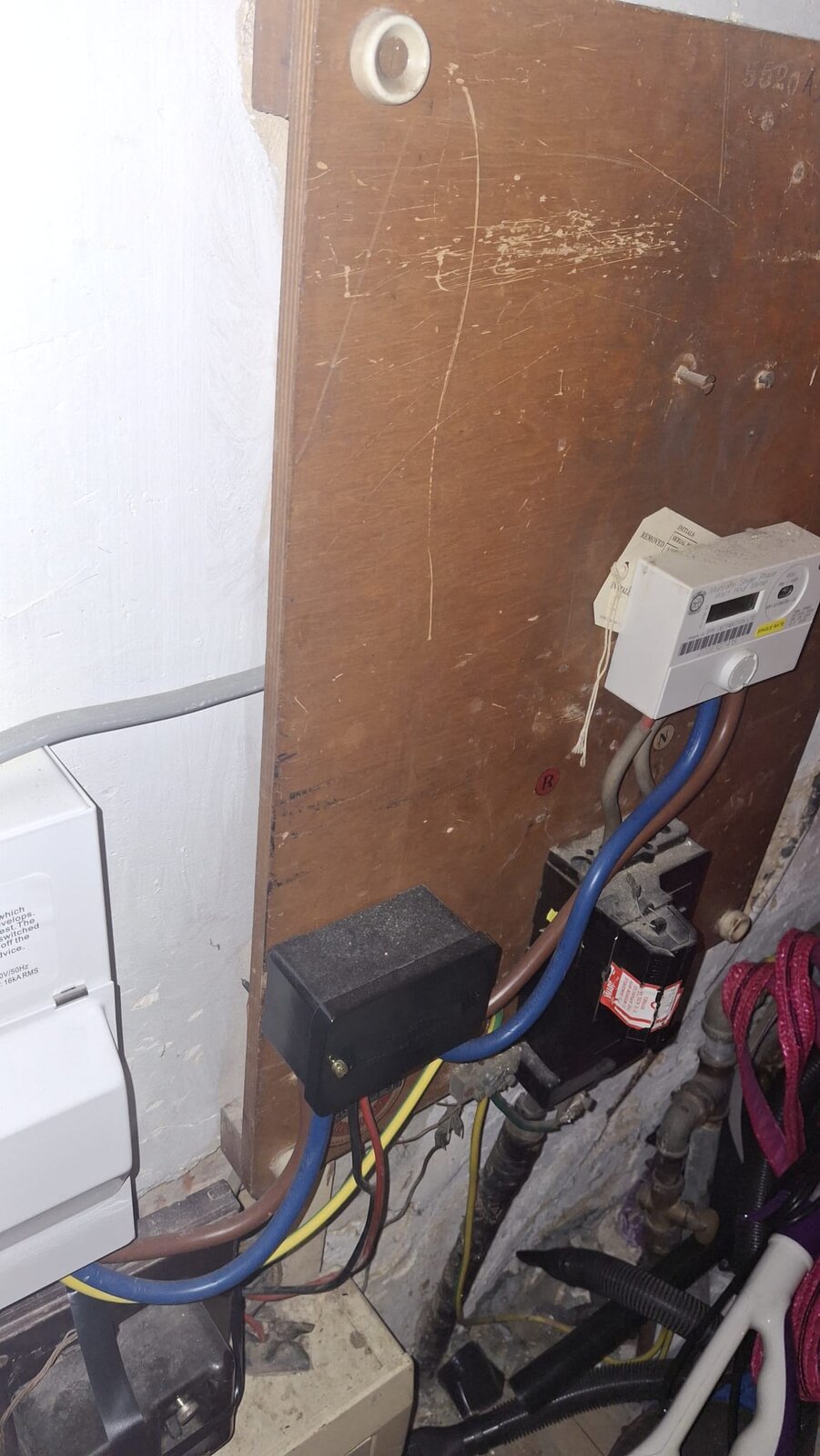

Thank you to everyone for their kind advice.
I've attached what is under the stairs. The white box was installed when an electric shower was installed last year.

The brown bakelite thing and the cream MEM box are a lot older. But not 1939.
What did the electrician who fitted the shower last year say about the state of the other electrics? I.e. did they suggest that it should be upgraded, and with what urgency? They will have had a better understanding than we can get from a few photos.
An important question is whether your wiring is using ancient rubber-insulated cables, rather than modern PVC (which was introduced in the 1960s I think). If the wiring was replaced, e.g. some time late last century, then maybe you don’t need to rip out and replace everything. If you still have ancient wires then you should certainly plan to rewire everything reasonably soon. You will need to find someone who is competent at neatly installing new cables to every socket, switch and lamp; you don’t want to have to redecorate every room after they’ve finished.
Your extra new CU should really have an SPD in it
Were you advised to get the property inspected properly then?
That old MEM board is a bit of a warning sign

I advise having the installation inspected and tested via an EICR preferably with a contractor who will gain from the outcome then you might have a reasonable idea if a complete rewired is required
