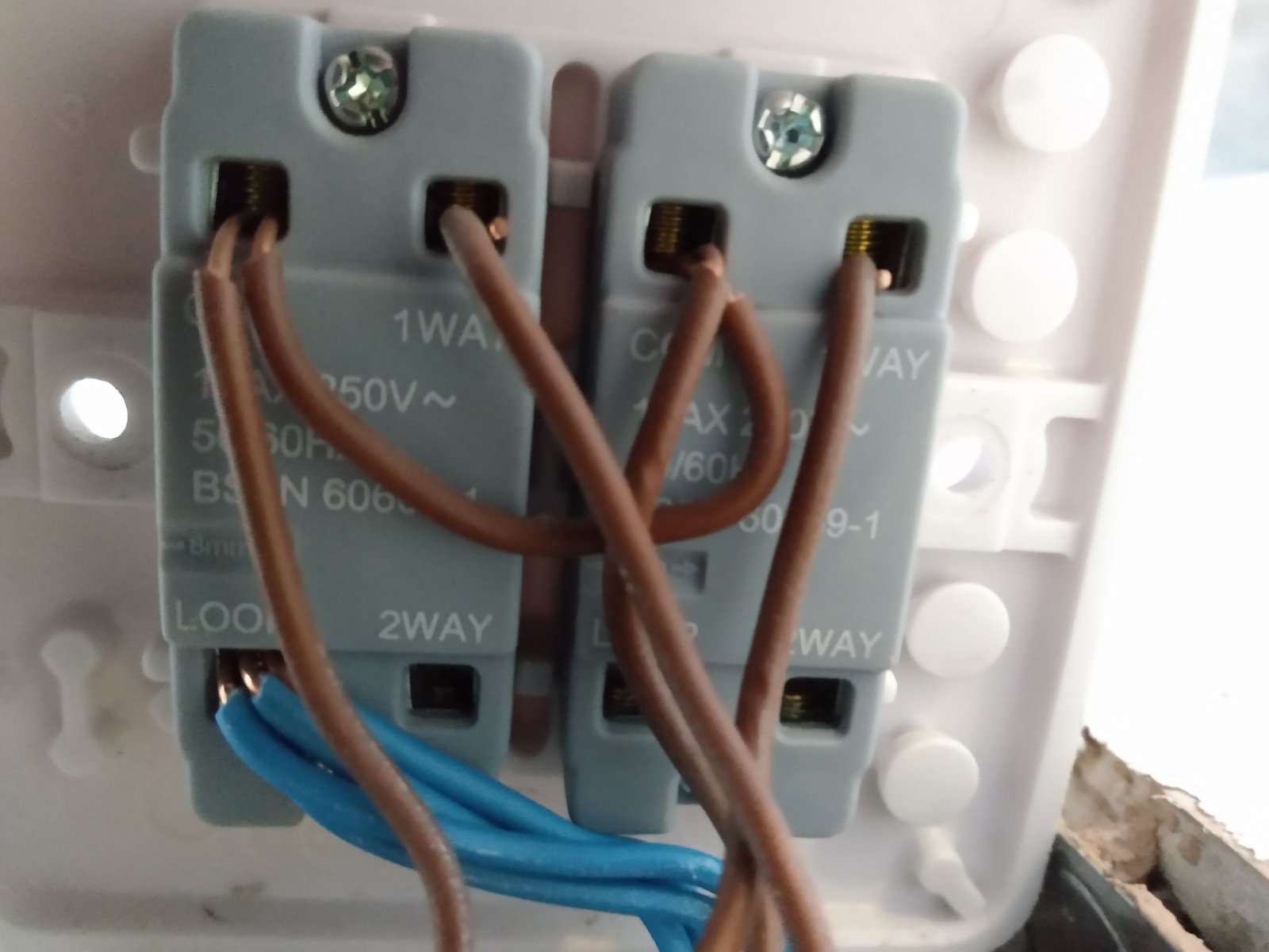

Inside the switch there are 2 cables, each 3 core and earth - 2 brown, 1 blue. I must admin I haven't seen that wiring before, is it possibly because they haven't used junction boxes due to the floor being screwed and glued (taking a board up means it gets destructed in the process)?

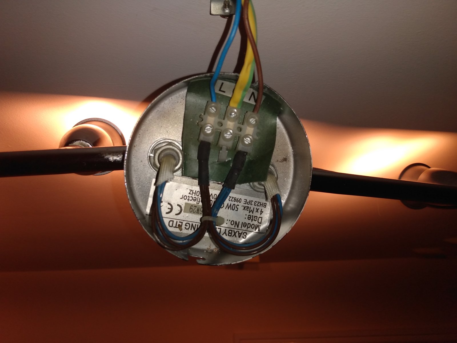

Now he has me worried. Either there is something really wrong with the wiring or he's maybe a bit of a 'novice' and not up to the job. Can perhaps some learned members have a look at the photos and give your opinion?
I must admit I was a bit concerned when I saw the wires in the light appeared to be reversed. That light was fitted by the builders and hasn't been touched until now, neither has the switch - I was/am a bit concerned by the exposed conductor, but it's easily fixed.

The wires at the light are wrong (L&N reversed). Easily fixed.

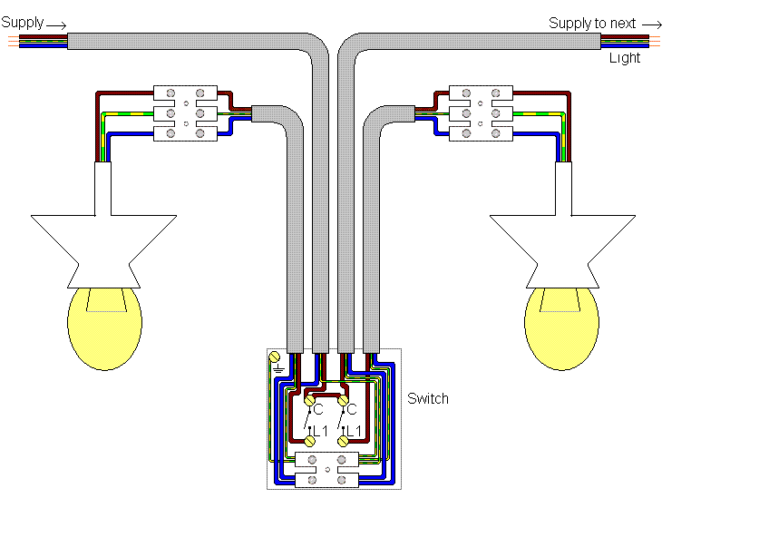

The wiring at the switch is entirely standard and exactly what you would expect in a modern installation.
To change that to a 3 gang switch and add another light controlled by that switch just requires a cable from the switch to the location of the new light.

The wiring at the switch is fine and perfectly normal in modern houses.

If it was an actual builder who fitted the lights then he needs his eyes testing, although it's not the end of the world and is easily rectified.

This is what you currently have in your installation. This is a standard circuit layout taken form our wiki.

Maybe he hadn’t seen switches with loop in terminal. That could be a wtf moment

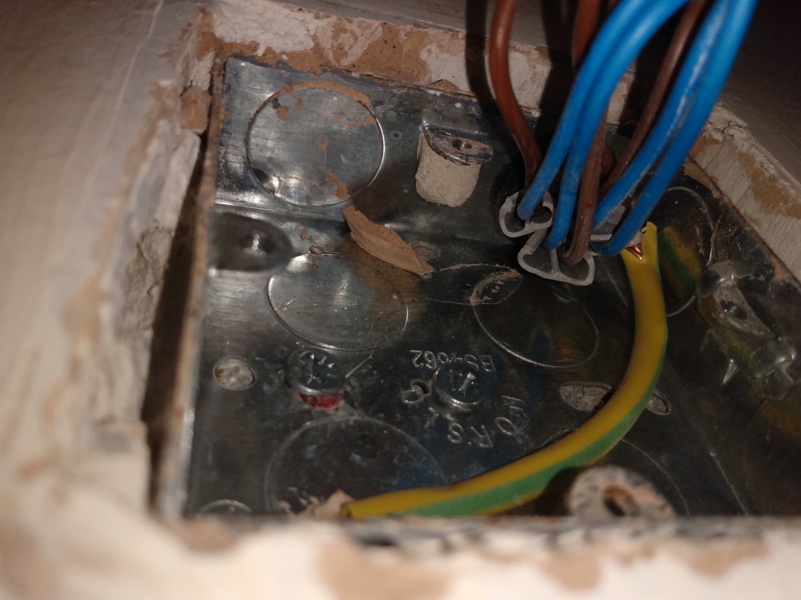

The truth is I'm worried about disturbing any of the wires and getting shocked so I simply looked without touching. I've had another look and tried to move some of the wires. I've done another picture looking at where the cables enter the box. It seems there are 3 or maybe 4 (as the later comments suggest) cables. Where they come in is very cramped and they won't move much but I can see the ends of the cables and some are definitely 1 brown, 1 blue & earth. In reality I think there are 4 cables each with brown blue and earth. My apologies, I should have thought about what I wrote (and did the maths!).
I also had a look at another switch to see if that would help - it didn't. Even though it's a single switch there's even more wires : 5 brown, 4 blue, 1 black and what I think is grey tucked in with the blue. But that's an odd number so maybe there's another I couldn't count.

I think you are aware that there will be some damage to the plaster in order to get it done. The real question is to what extent. Lifting the floor is not an option judging by your posts, so the options are to stitch the way across the ceiling and possibly down the wall. There is a way to avoid damage to the wall, but that means a bigger hole in the ceiling above the light switch to work on the cables that go in to the ceiling. The rest is just finding the least intrusive way across the ceiling to the new light position. It's a mornings work for some who knows what they're doing and maybe a couple of hundred pounds, plus your lights and then the plastering over.
