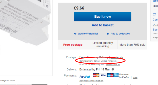

Hi all,
I have three rooms I let out above a shop, where the rent includes all the utilities as they are shared with the shop.
I want to have the ability to charge residents for excessive electricity usage, and have found these, which look like I could have one per room in the fusebox (the flats have their own fusebox, and have one circuit for each room, one for communal, one for all lights and one for the cooker).
The problem is I can't really find much information on them, whether they work well, and how they fit into/are connected up in the fusebox!! If anyone has any experience of them any advice would be appreciated.
Thanks!
I would advise against those.

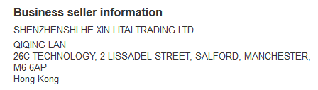

So where is the seller
  1. Jersey?
  2. Salford?
  3. Hong Kong?
  4. All of the above?
  5. None of the above?

Thanks TicTak, that link is very helpful! Not something I had thought of, and the examples don't really fit what I am planning on doing. Basically I am one of the good landlords - I currently include all the utilities, I have the heating on constant at 21degrees, and really I'm pretty easy going, but as I have the heating on what I don't want is someone having an electric heater on 24/7 as well. My plan would be to say X kWh per month is included in the rent, but anything above this would be charged at my current rate. I'm not wanting to use this to make money, just to stop losing money if the tenants take the pi$$! I'd take a reading on the 25th of each month (I submit all my readings on the 25th, so it will be part of my routine!). I'll keep a record of each month's readings, so there'll be no problems proving usage.
To be honest, that was the first one I found to link to! I hate that about ebay, you can select UK only, but the seller could still be in China with a UK address for shipping. Thanks for the advice though.
I was confused because from the diagrams I could find said that the bottom terminals were for live & neutral, but in a standard consumer unit there's a common live rail along the bottom. I'm hoping someone has fitted one like this and could confirm how they connect them.
As you CU is full, you'd need a new one to fit those meters, and is that worth the cost. There is no breaker on them, so although they fit on the rail, it would seem you have to wire them in to the CU alongside the MCB you're measuring. But even then they may not work. They have a live and neutral in, and a live and neutral out, so you'd need to take the live wire out of the mcb, and feed it into the meter, and then fix the live wire into the other side of the meter. In the same way, you need to take a neutral into the meter, and then take the neutral out of the meter to go to the relevant room. And you also need to make sure that the meter will fit your CU as well.
