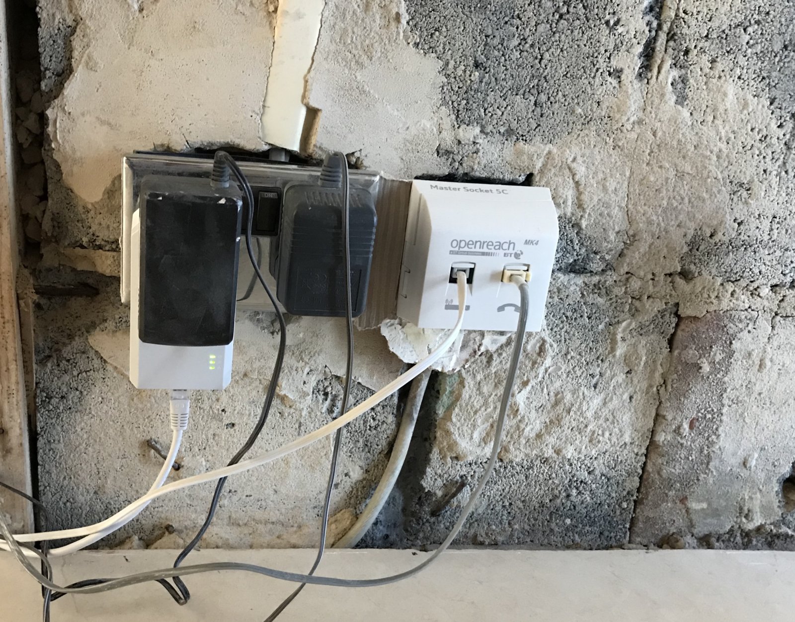

Perfect, that makes sense guys. Yes, shower to be removed and then it’ll just be a nice square room with a toilet and sink next to each other and then a unit with a socket, router and phone the opposite corner. A long way from any splashes or hazards.
Regarding the the bt line. It comes out of the floor one side of the wall and would basically need moving from one side of the wall to the wall behind. I’d even be happy with leaving the master socket where it is and then having an alternative provision on the wall behind it if that makes it easier?
I just hate phone extension after phone extension like the used to do. Looks terrible now you can have cordless phones and put additional hand sets in other rooms easily. I know in a power cut they stop working though and that’s the downside.
To get the bt socket on the wall behind it, is it easiest to leave the socket in situe and run another point off it behind it?

So, how would you suggest getting a BT socket on the reverse of this wall?
Yes that’s right but they work fine for what I’ve got them in for tbh. I don’t rrakly want a full rewire to run CAT6 to everywhere do I tbh? A lot of disruption in order to do that. I agree that having network cable in would be great but the home plugs do the trick.
