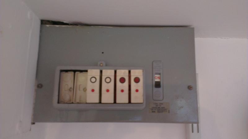

Hi my wife is renting an office with a friend and there is a tiny kitchen area which has one of those hot water tanks over the sink fed from an adjacent spur. There is also a socket to the side near the floor and a light switch on the wall to the right, basically a few electrical items close to the sink, see pictures
This is the fuseboard not sure what make that is, anybody know?
What I would like to know is are these items ok being so near the sink and shouldn't there be some sort of RCD type protection involved?
Also what would you suggest as cheapest/simplest solution if anything needs doing as my wife will probably end up paying for it and is not to bothered how it will look within reason?

Fuseboard is Wylex. Older design, could be anywhere from 1980 onwards.
Depends when the stuff was installed as to whether it has RCD protection or not. In this case, it does not. That means it is not to current standards. The kitchen is not subject to the same regulation as a bathroom, so electrical items can be closer to sinks and taps (in a bathroom a socket outlet cannot be closer to a bath or shower than 3 metres).
It's a standard dated fuse board, that alone does not make it unsafe

If you are wanting additional protection via RCD, the simplest solution would be to replace the fronts of socket outlet and FCU (to single point water heater) to ones that have integral 30mA RCD protection.
But this would only offer protection against a faulty appliance and flex.
But as this is a let property, this should be down to the landlord and alteration should not be made without their written consent.
Has the landlord had a report done on the the condition of the electrical installation that your wife has a copy of? As the landlord has a duty of care to prove that the installation is safe for continued use.

positioning does not appear to be a problem, but the Electricity At Work regulations will apply, and that old fuseboard looks like it might not be touch safe with the fuseholders missing and the gaps where the fuse cover is removed.
I would suggest that if any earthed (not double-insulated) portable appliances are used, an RCD adapter be used for added safety.
