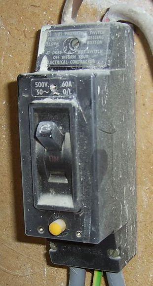

The main switch is a pretty old looking thing with a yellow button beneath.
Is it one of these:
If so, then 35+ years old, and it should have been replaced years ago.

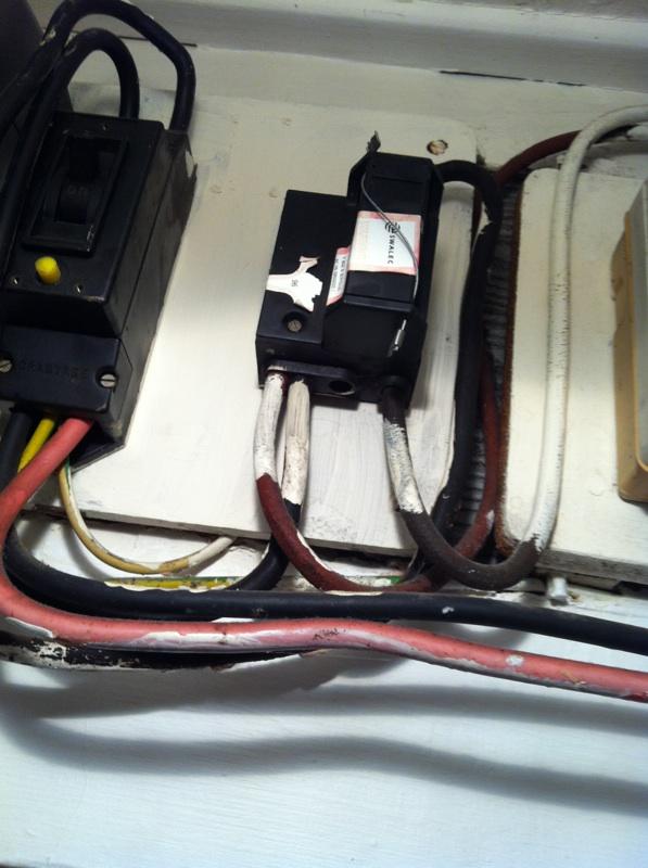

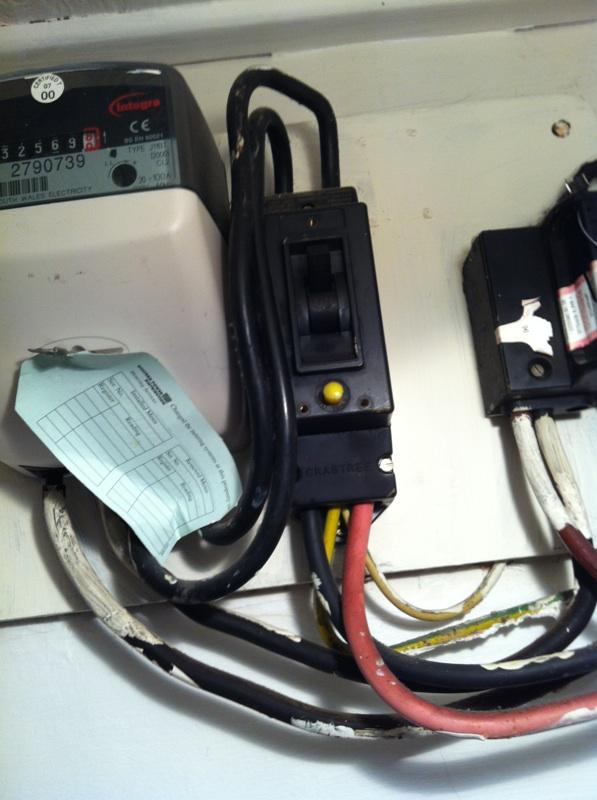

Heres some pics of the dreaded wiring!
No I am more interested in the cut out fuse to the right of the VOELCB.
As said the VOELCB has served its time and it is recommended that they are replaced.
I can't see much green and yellow cable which is your earthing/CPC.
I do think you will need to call in an electrician.

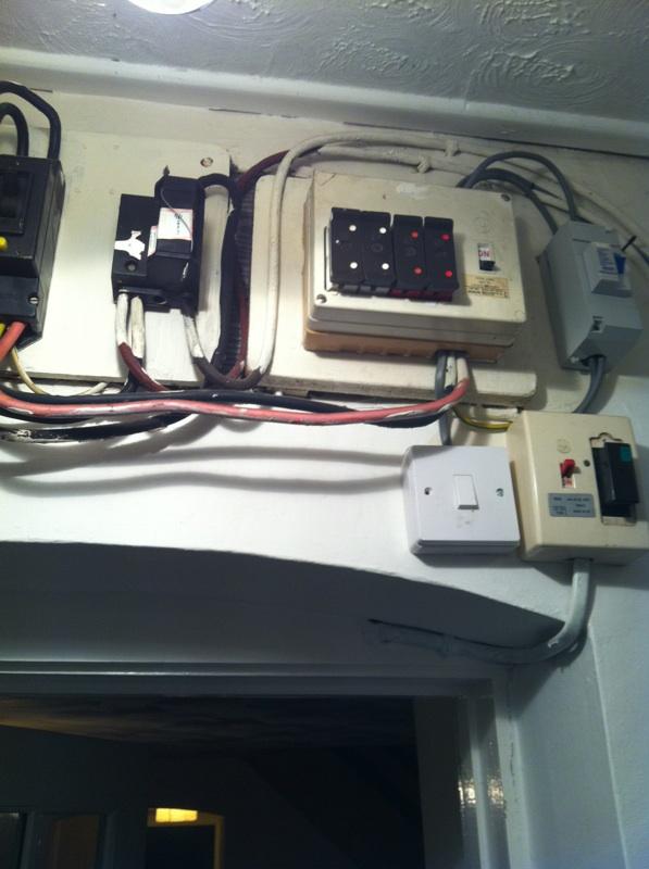

Is this what we're talking about next to the VOELCB? Heres a close up of consumer unit and spaghetti 'prince phillip' wiring :oops:
Hard to tell from the photo but is the neutral fused rather than the live?
Are you thinking that the incoming cable going to the bottom left of the cutout (the unfused side) is red? I think it's probably a brown sheath, with goodness-knows what colour insulation beneath it. The feed to the fuse side of the cutout (bottom right) has a black sheath - so, again, one doesn't know what the insulation colour is.
In any event, I don't think one can assume anything about the colour-coding of DNO conductors from overhead supplies (it seems to depend on 'what they have in their van'!). Per the piccie I've posted a few times in the past, my (overhead) neutral arrives in my house as a red-insulated and brown sheathed cable!
