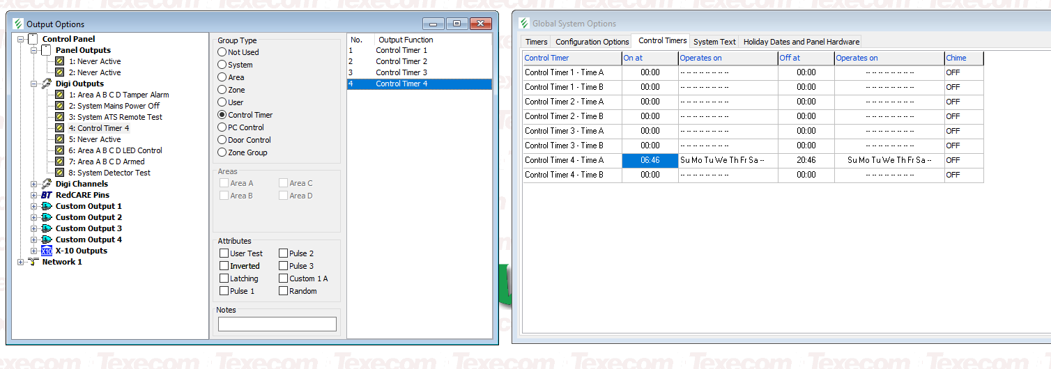

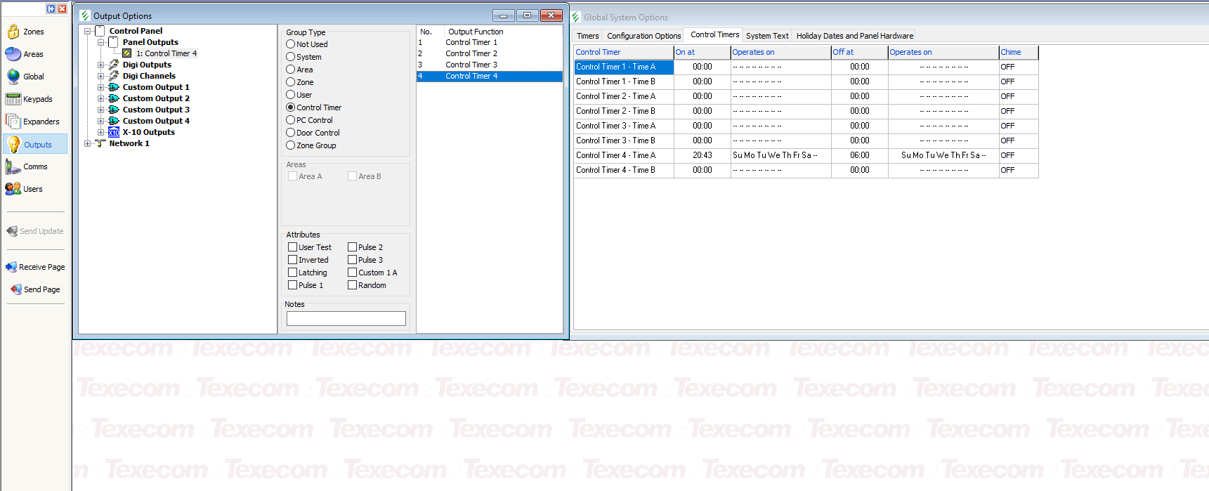

ive been swappping settings about in wintex,
global systems /control timers .. set times and days on and off.
panel outputs / control timers , selected control timer 1. output function.

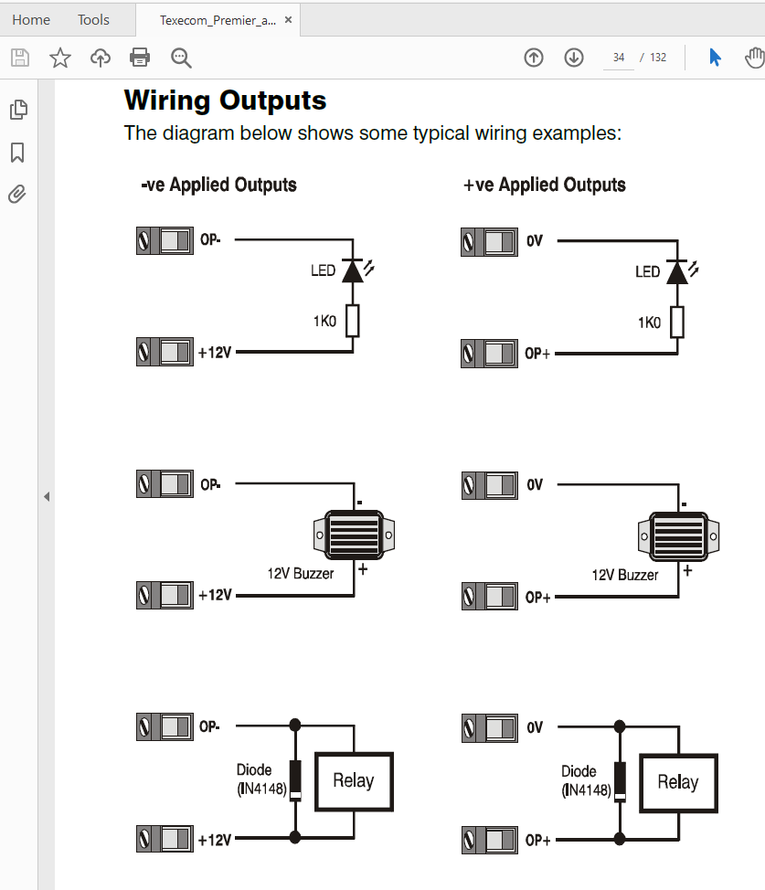

the down side is with the multi meter on OP- and 12v+ the output just seems to be on all the time..
can some one tell me what im missing please..
