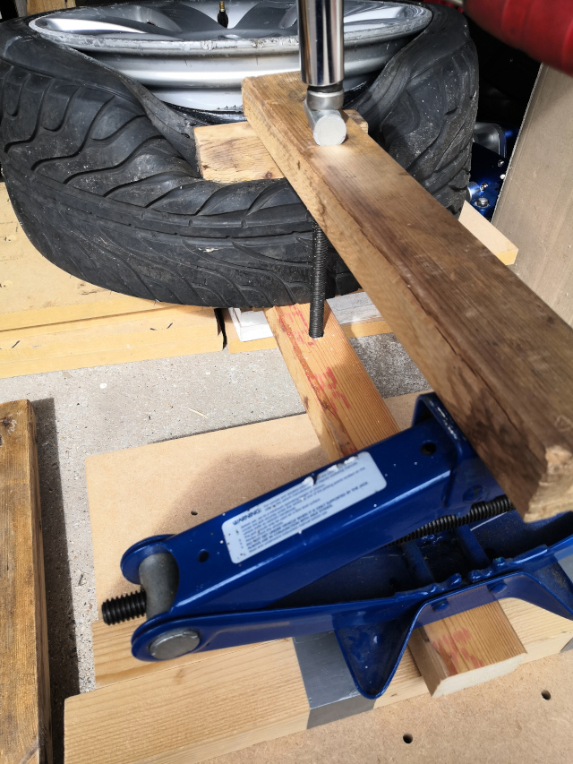

Tyre crushed. Not possible to succeed unless willing to crush. The wood beams were just adequate at 37mm x 62mm cross section. The Lead screw was M14 from the broken twin of the scissor jack shown. The other bead was slightly more challenging owing to the previous use of bead sealer. The sealer turned into glue and could not be broken by hand. The glue was easily broken by the bead breaker but had to be done around the whole rim.

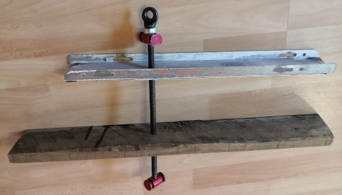

Here's the failed V1 bead breaker to illustrate the structure and ease of fabrication. The design was sound but all of the materials used were too flimsy for the task.
Just drive the bloody car wheel up onto a deflated wheel that is laying flat on the ground, just missing the rim if you want to break the tyre bead. No extra tools needed.
I didn't think you cared. Isn't it better to go to shop? No need to drive up anything.
I’m on holiday and in a good mood. You’re driving to the shop anyway so drive on the wheel.
