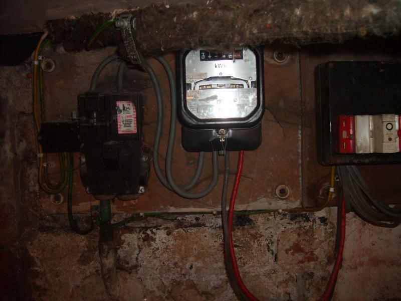

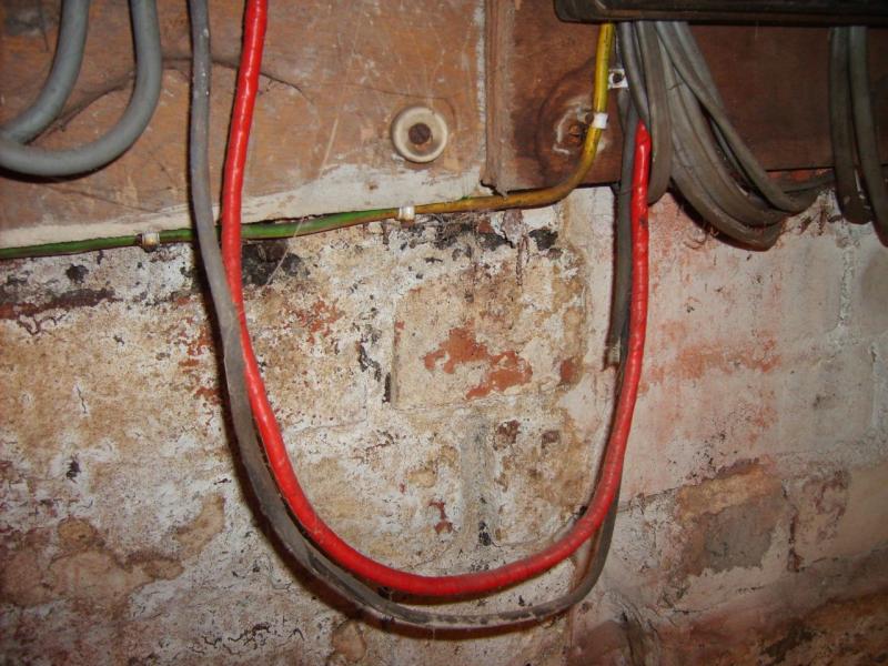

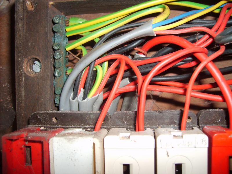

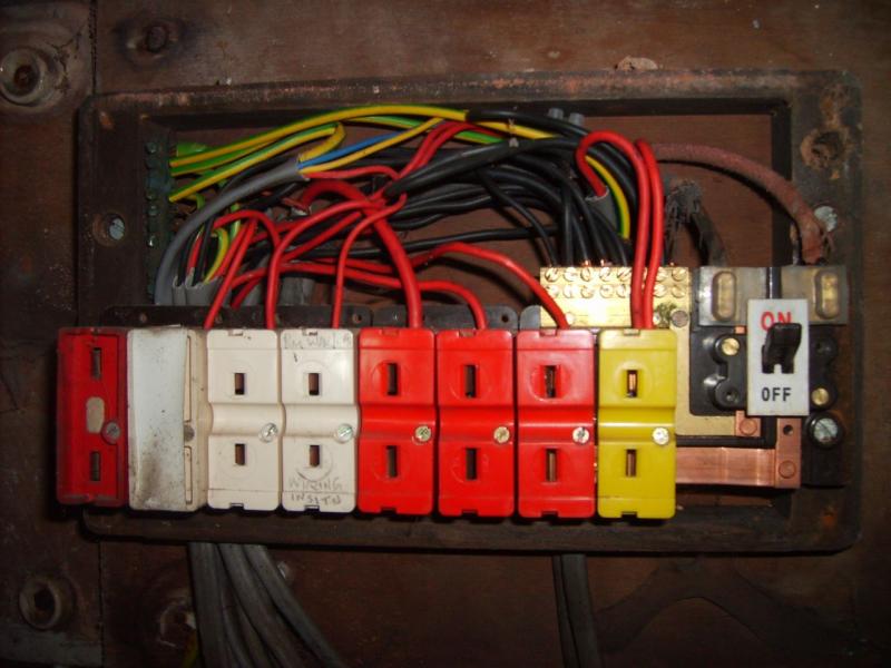

Here we go then.
Earth bond wires can be seen here.
CU With cover off
Looks like the lighting wires are definitely connected to the earth terminals. Lighting MCB is white one, third from left.
OK, the earth wires look OK in the CU. But you said you have earth points seemingly unconnected? With luck you will find a ceiling rose where the CPC is cut back, and you can fix it. If you are not lucky there will be a junction box hidden under the floor :x

I can't see why you have a 3-core Red/Yellow/Blue cable in there :?
Another major point:
Your meter tails to the CU are horrible. Looks like perished rubber insulation and might be brittle, think I can see a split at the top of the main switch. Avoid touching, bending or moving them. They are also undersized and might be 10mm or even 6mm. They predate the CU. I expect you are starting to think about saving up for a CU replacement as the brown Wylex is overdue for replacement. As the tails go into the meter you will not be able to change them without having the meter unsealed. You can ask you supplier if you can have the meter opened to fit new tails (use 25mm) but they may charge, or refuse unless an electrician is involved. You could have a 100A isolator fitted at the same time, I like them but opinions differ.

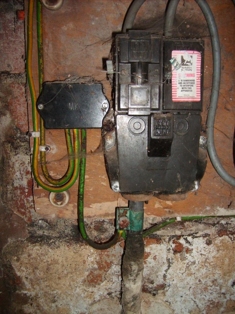

I can't make out the earthing at the service head. Lighting is poor. I think you have a clamp round the incoming cable sheath and there is an earthing block, I can't see if it attached to the service head, or just fixed to the board close to it. Main earth should be 16mm and main bonds s/be 10mm. I expect yours will be undersized.
off topic, you might like to pull off that felt pipe insulation and fix stiff foam like Climaflex, it is more effective and does not generate dust.

Here is a better view of the earthing situation.
You are correct about the tails, they are a mess.
The red is just insulation tape.
