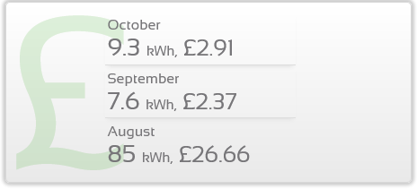

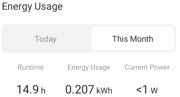

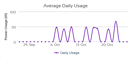

1761390579338.png1761390608471.pngThis is the dishwasher, except for August where it was looking at the AC. I think I now have a good idea what a dishwasher costs, so it can be moved to the microwaves, I now have many monitors which can also switch on/off this 1761391094403.png is the outside light on the shed for example, but a power cut of just a minute will turn it off, I only have one which is a monitor only. Plus one which in manual, and does not connect to the PC. Which is a pain as a power cut resets it, the two button cells should hold the data, but they don't seem to last long. Put it on microwave, and set microwave clock, but it shows no stand-by use, it is not enough to register on the energy monitor.
