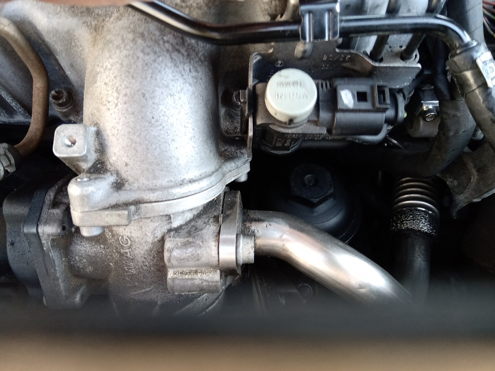

Hello, I've just noticed a tapping/ticking sound from the engine. I'll add a picture as I've found where is coming from. There's a little round cap with made in USA on it and the noise stops of you just put a finger on it. Does anyone know what the thing is or any suggestions what can be done.
Cheers
This is an EGR exhaust gas recirculation vacuum solenoid valve.....if its chattering its faulty.
Not that expensive, around £20 I think.
John :)
Ebay or Amazon would be able to provide, no doubt but on the Nissan I did - which looked identical- it was a main dealer part.
You’ll see two pipes connected to this thing, and if you suck them there should be a restriction.
John :)
There is a second identical valve buried under all the vacuum pipes etc to the left top of your picture but it would take a little dismantling to get to. You could just swap them over to test but it is laughably common for them to buzz...
