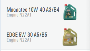

I was recommended Castrol Edge 0W 30 by the Honda dealer we bought the car from new. It has a 2.2 iCDTi engine without DPF.
That's what I have always bought.
I was looking at buying a new lot from Amazon when I came across this:
https://www.amazon.co.uk/Castrol-15...le=866-62&replacementKeywords=0w30+oil&sr=8-3
Labelled for Honda to Spec C2.

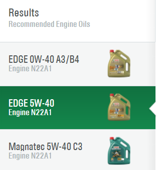

Then I go on Castrol's site and see this:
Having searched the forum, I find Mannol is a very good brand.
https://www.amazon.co.uk/MANNOL-Leg...=1&keywords=mannol+0w30&qid=1598108684&sr=8-4
You might say it's a bit late when I'm 145K down the road, but which oil should I be using?

When establishing the right engine oil, visit a few oil websites, Castrol, Exol, Millers, Morris, ... etc to establish the grade/specification of oil for the engine. What's the car manual say?

As the car has 145,000 miles on it, I think it might be wise to use a slightly thicker oil than 0W30 so I think a 5W40 would be a very good idea indeed. Using a slightly thicker oil is beneficial to maintain good oil pressure in older cars especially in hot weather and at low engine rpm.

Here's a quote from a Honda TSB (Technical Service Bulletin) I received in June 2018.
'N16A1, 1600cc, 1800cc 2.2cc Europe and excluding North America and inclusive of Earth Dreams engines -
'It is essential that only the correct specification SAE 0W-30 fully synthetic low ash oil is used in these engines or internal engine damage can occur. Some owners have tried using SAE 5W-30 or SAE 5W-40 lubricants but these are of too high a viscosity rating'.
Honda didn't specify what mileages were involved or what kind of engine damage resulted but there we are.
