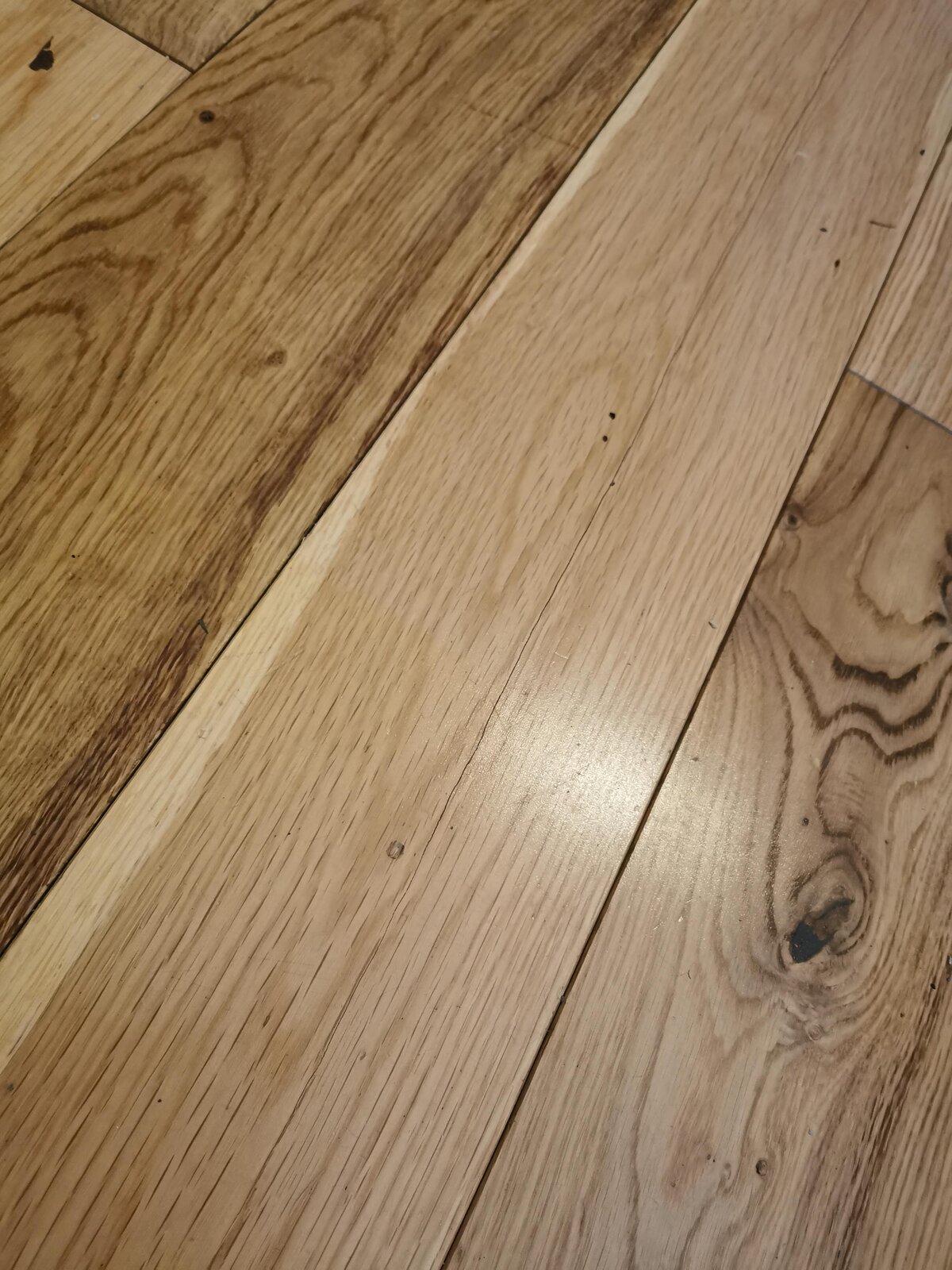

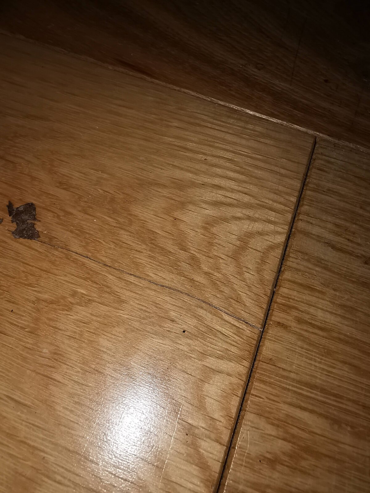

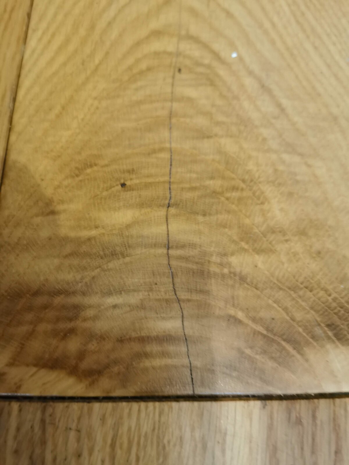

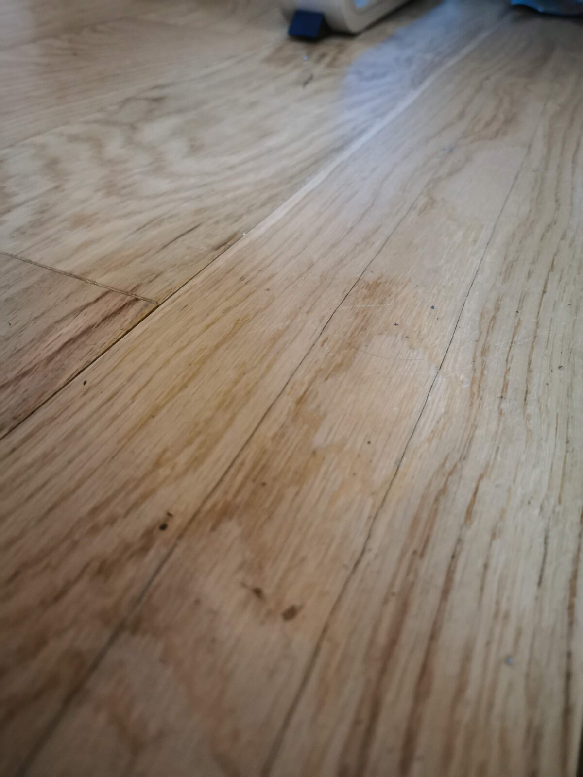

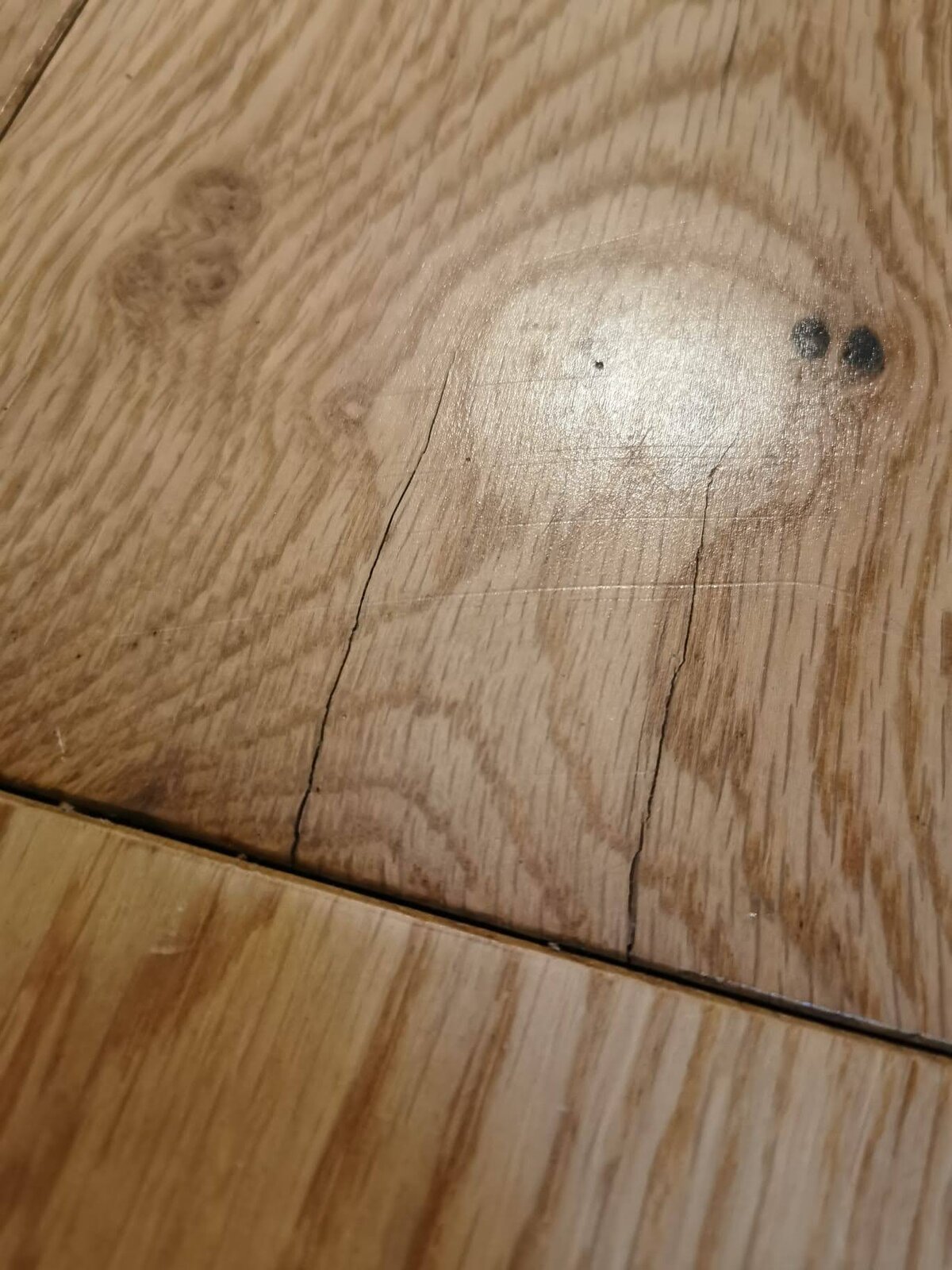

We purchased and installed engineered oak flooring as part of our living room renovation a bit over 12 months ago.
The flooring was installed over a screeded wet UFH system using Bona R848 Flexible wood adhesive. The screed was given plenty of time to dry before we installed the flooring.
However recently we've started noticing that some of the boards appear to be splitting. Some are just at the ends, but a couple appear to run pretty much the whole length of the board.
Attached are a few photos of the worst boards.
IMG_20220106_152859.jpg IMG_20220106_153038.jpg IMG_20220106_152849.jpg IMG_20220106_153139.jpg
Has anyone seen this before? Any suggestions on what could be causing this? Is this a product defect, installation error?
I've also emailed the company I purchased the flooring from to see what they think. The flooring is advertised as having a 25 year guarantee, so for it to be splitting after a little over 12 months feels poor.

The issue with the floor will be down to humidity and/or heat. Splitting is normally attributed to heat/drying out rather than excessive moisture. It would be worth double checking the specs and use of the UFH system compared to the recommended max temp specs of the floor, I suspect that the manufacturer of the flooring will point a finger of blame at the UFH being used at to high a heat for the product.
So I've just pulled the cabinet apart to get to the ufh manifold, and it looks like inlet side was running at about 50c, with a return temp of around 40c... So possibly was a bit high...
I've tweaked the inlet temp and flow rate and just letting it settle for a bit...

Found this on several sites, seems yours is way too hot .
Your underfloor heating must be designed in such a way where you do not get hotspots beneath your floor. The underside of your flooring must not reach temperatures above 27 degrees celsius. If any areas of your floor exceed these limitations it may cause damage to your floor.
Foxhole is correct, the floor has seemingly been laid way outside it's temperature operating parameters by the looks of it.
