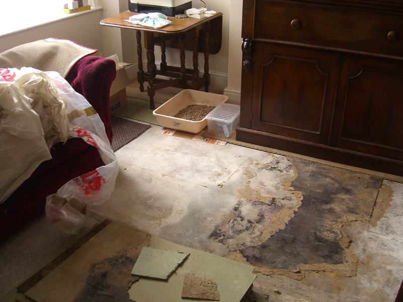

I just discovered a damp patch in the middle of the concrete subfloor. I presume I can put down a black polythene DPM before the usual fibre underlay?
I'd be inclined to put a liquid DPM down (it won't move), but a 1200 gauge polyethylene DPM should be fine
Not really, depend where is the damp from?
If it's just residual best to let it dry out first.
If it's a broken DPM then the floor will keep getting wetter until it is drying out as fast as it's rising into the floor, ie it comes out the edges. Depends if that's a problem.
I wouldn't be surprised if it doesn't have a DPM. I think it leaches in through the gable end wall because the house has no DPC and the road level outside (gable end) it is pretty much at floor level or maybe worse. Not a lot I can do about that. I can't see the council digging up a road surface that has been that was for a century, for me.
You'd need to seal any DPM to the dpc, normally you lap the DPM across the wall with the dpc in the same layer and it's completely continuous.
In practice you may get away with it not sealed but I'm not sure where the water would manage to leave to be honest.
Edit old houses are complex beasts usually in balance in their early years, any modern interventions can upset that balance and cause dampness in the long term. You'd need someone with more experience than me!
How is that better than polythene? Isn't it just and impermeable skin either way?
might not be if you have serious amounts of water coming up, but if it is just a bit of vapour it will stop it actually getting to the surface and condensing, with polythene overlay if it actually gets to the surface it could just run on top of the slab under the polythene not necessarily a total problem but could for example wet the bottom of your plastered walls cause mold etc
